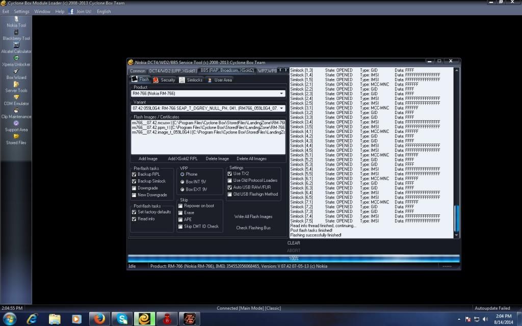

history nagpalit lang ng memory card pagbukas nya sa CP
after ng welcome tones restart na ang unit
tools :cylone box
: usb cable (5310)
: firmware same product code para mas safe
Code:
Establishing Connection with Box in Main Mode...
Handling device: [Cyclone Team], [Cyclone Bootloader], [Platform: Classic]
Handling device: [Cyclone Team], [Cyclone Box], [Platform: Classic]
Initializing box...
Box Firmware: Cyclone Main Application v02.20, (Aug  6 2013 20:31:40, gcc v4.3.3, RTOS V6.0.1), Type: Signed Production Application, (C) KarwosSoft 2012
Hardware Platform: Cyclone Classic Flasher Interface (c) 2008,2009 KarwosLabs
Box Serial Number: C0007FB4
HW Revision: C, Suitable for: Production, Case: 2011 - New Casing, MCU Manufacture Time: 2011, wk01
Initializing security card...
Card Serial Number: D00C079C
Card Firmware Revision: 010A
Card is activated
Box is activated
Started box selftests procedure
USB Voltage	4.89v	PASSED
MCU Voltage	3.27v	PASSED
Core Voltage	1.80v	PASSED
VBAT Voltage	0.01v	PASSED
VBAT Voltage	4.86v	PASSED
Box VPP disabled
VPP Voltage	0.04v	PASSED
Internal Box VPP Enabled
VPP Voltage	4.83v	PASSED
Box VPP disabled
External Box VPP Enabled
VPP Voltage	0.02v	FAILED - IGNORED - Probably power supply is not connected
Box VPP disabled
All box selftests passed!
Super DCT4 Activation: TRUE
XGold/Blackberry Service Running, Counter: 90
Lumia No TP is NOT ACTIVATED! (1)
Avaiable Physical Memory: 1.1023GB
Avaiable Virtual Memory: 1.791GB
Avaiable Pagefile: 3.1023GB
Initializing FBUS...
All initialized - Ready to work
Scanning avaiable products...
Processing C:\Program Files\Cyclone Box\StoredFiles\LandingZone\...
Found 6 products, Filtering BB5 Products - wait...
6 Products left after filtering. Ready.
Retrieving Variants for Product RM-766 - wait...
1 Variants Retrieved
Processing pre flash tasks...
Backing up RPL...
RPL Creation started...
Processing CMT Part...
[Nokia USB Flashing Generic]: Port opened OK!
Proceeding with Recovery Mode...
Booting CMT...
XGold223 ROM Detected
Failed to Boot CMT -> Failed to get First Boot Block
Prepare phone failed with message -> Failed to Boot CMT
Recovery Mode Failed, storing Certificates Only
Booting CMT...
Failed to Create RPL from phone -> Failed to Boot / Prepare Phone
RPL backup thread finished, continuing...
Backing up simlock...
Sending User Abort Signal...
Phone not detected at USB -> User Abort
Simlock backup problem -> Phone not detected
Backup simlock thread finished, continuing...
Pre flash tasks finished, continuing...
Processing rm766__07.42.mcusw (XGold2)...
Checking rm766__07.42.mcusw...
Flash file sorted Okay.
1 file(s) embedded into image.
Booting X-Gold via USB...
If PC Can't detect any new device, probably your phone is erased. Do following if needed:
1. Eject battery
2. Eject cable
3. Insert cable
4. Insert battery
5. Press power-on
X-Gold: Ready, MCU ID Block: 1FB300020303010100FF
[PBL] : Ready
[EBL] : Mode CC
[EBL] : Quantum_Bootloader_10.49_M1S1
[EBL] : Ready
Setting Baudrate to 6500000bps...
Baudrate Accepted (6500000bps)
Flash Chip 0x00EC3012, Samsung, Size: 64MBytes
Processing "rm766__07.42.mcusw_ebl_psi.fls"...
Sending Certificate...
Certificate Accepted
Erasing 0x40000000-0x4001FFFF...
Flashing at 0x40000000...
Flashed 131072 bytes OK
Erasing 0x40040000-0x4005FFFF...
Flashing at 0x40040000...
Erasing 0x40060000-0x4011FFFF...
Flashing at 0x40060000...
Flashed 786432 bytes OK
Erasing 0x40120000-0x41BFFFFF...
Flashing at 0x40120000...
Flashed 28065792 bytes OK
Erasing 0x43EE0000-0x43EFFFFF...
Processing rm766__07.42.ppm_t (XGold2)...
Checking rm766__07.42.ppm_t...
Processing "package_t.ppm_ebl_psi.fls"...
Erasing 0x41C00000-0x423FFFFF...
Flashing at 0x41C00000...
Flashed 7917732 bytes OK
Processing rm766__07.42.image_t_059L0G4 (XGold2)...
Checking rm766__07.42.image_t_059L0G4...
Processing "package_t_059L0G4.image.fls"...
Erasing 0x42400000-0x43EDFFFF...
Flashing at 0x42400000...
Flashed 14548992 bytes OK
Erasing 0x43F00000-0x43F7FFFF...
All images processed OK! Processing post flash tasks...
Setting Factory Defaults...
Phone not detected at USB -> Timeout, no any compatible USB device detected.
[Nokia USB Phonet]: Port opened OK!
Factory defaults OK
Reading info...
MCU Version	V 07.42
MCU Date	07-05-13
Product		RM-766 (Nokia RM-766)
Manufacturer	(c) Nokia
IMEI		354552056068465
Mastercode	2541702344
IMEI Spare	3A45550265604806
IMEI SV		3345550265604846F0000000
PPM		V 07.42, 07-05-13, RM-766, (c) Nokia            , T
CNT		Content: t_059L0G4, V 07.42, 07-05-13, RM-766, (c) Nokia
PSN		B7B78C8AH
Product Code	059L0G4
Module Code	0204884
Basic Product Code	059K4Q4
PSD		0000000000000000
LPSN		0
AHNE		11
HW		1000
RFIC		Dummy RFIC version
LCD		TPO
BT		19b5-22012
Asic		11
HW Signature	91AB74B39A616D72
Simlock Server	SIMLOCK SERVER
Simlock Key	0010100000000000
Simlock Profile	800000000003000B
Simlock Aux	000B0000
Simlock IMEI	00003545520560684600
Simlock Key Cnt	0
Simlock FBUS Cnt	0
Simlock [1,1]	State: OPENED	Type: MCC-MNC	Data: FFFFFF
Simlock [1,2]	State: OPENED	Type: GID	Data: FFFF
Simlock [1,3]	State: OPENED	Type: GID	Data: FFFF
Simlock [1,4]	State: OPENED	Type: IMSI	Data: FFFFFFFFFFFFFFFF
Simlock [1,5]	State: OPENED	Type: IMSI	Data: FFFFFFFFFFFFFFFF
Simlock [2,1]	State: OPENED	Type: MCC-MNC	Data: FFFFFF
Simlock [2,2]	State: OPENED	Type: GID	Data: FFFF
Simlock [2,3]	State: OPENED	Type: GID	Data: FFFF
Simlock [2,4]	State: OPENED	Type: IMSI	Data: FFFFFFFFFFFFFFFF
Simlock [2,5]	State: OPENED	Type: IMSI	Data: FFFFFFFFFFFFFFFF
Simlock [3,1]	State: OPENED	Type: MCC-MNC	Data: FFFFFF
Simlock [3,2]	State: OPENED	Type: GID	Data: FFFF
Simlock [3,3]	State: OPENED	Type: GID	Data: FFFF
Simlock [3,4]	State: OPENED	Type: IMSI	Data: FFFFFFFFFFFFFFFF
Simlock [3,5]	State: OPENED	Type: IMSI	Data: FFFFFFFFFFFFFFFF
Simlock [4,1]	State: OPENED	Type: MCC-MNC	Data: FFFFFF
Simlock [4,2]	State: OPENED	Type: GID	Data: FFFF
Simlock [4,3]	State: OPENED	Type: GID	Data: FFFF
Simlock [4,4]	State: OPENED	Type: IMSI	Data: FFFFFFFFFFFFFFFF
Simlock [4,5]	State: OPENED	Type: IMSI	Data: FFFFFFFFFFFFFFFF
Simlock [5,1]	State: OPENED	Type: MCC-MNC	Data: FFFFFF
Simlock [5,2]	State: OPENED	Type: GID	Data: FFFF
Simlock [5,3]	State: OPENED	Type: GID	Data: FFFF
Simlock [5,4]	State: OPENED	Type: IMSI	Data: FFFFFFFFFFFFFFFF
Simlock [5,5]	State: OPENED	Type: IMSI	Data: FFFFFFFFFFFFFFFF
Simlock [6,1]	State: OPENED	Type: MCC-MNC	Data: FFFFFF
Simlock [6,2]	State: OPENED	Type: GID	Data: FFFF
Simlock [6,3]	State: OPENED	Type: GID	Data: FFFF
Simlock [6,4]	State: OPENED	Type: IMSI	Data: FFFFFFFFFFFFFFFF
Simlock [6,5]	State: OPENED	Type: IMSI	Data: FFFFFFFFFFFFFFFF
Simlock [7,1]	State: OPENED	Type: MCC-MNC	Data: FFFFFF
Simlock [7,2]	State: OPENED	Type: GID	Data: FFFF
Simlock [7,3]	State: OPENED	Type: GID	Data: FFFF
Simlock [7,4]	State: OPENED	Type: IMSI	Data: FFFFFFFFFFFFFFFF
Simlock [7,5]	State: OPENED	Type: IMSI	Data: FFFFFFFFFFFFFFFF
Read info thread finished, continuing...
Post flash tasks finished!
Flashing successfully finished!
