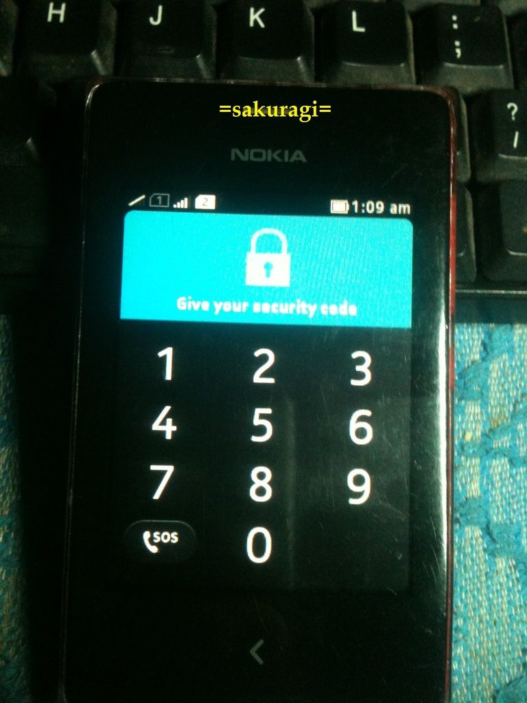

Problem:
Security Code

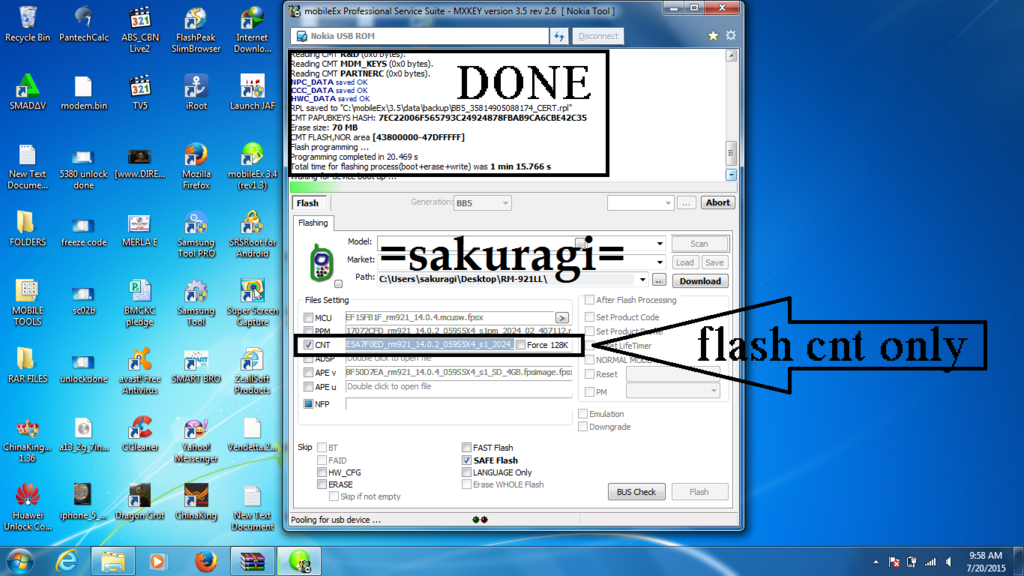

Syempre una download ako latest setup ng mxkey 3.5 rev 2.7 sa support
Install and sign
Choose nokia usb rom
Connect then choose nokia tool
Load CNT file
Thick flash
Remove batt sa device
Insert usb cable
Then insert again battery

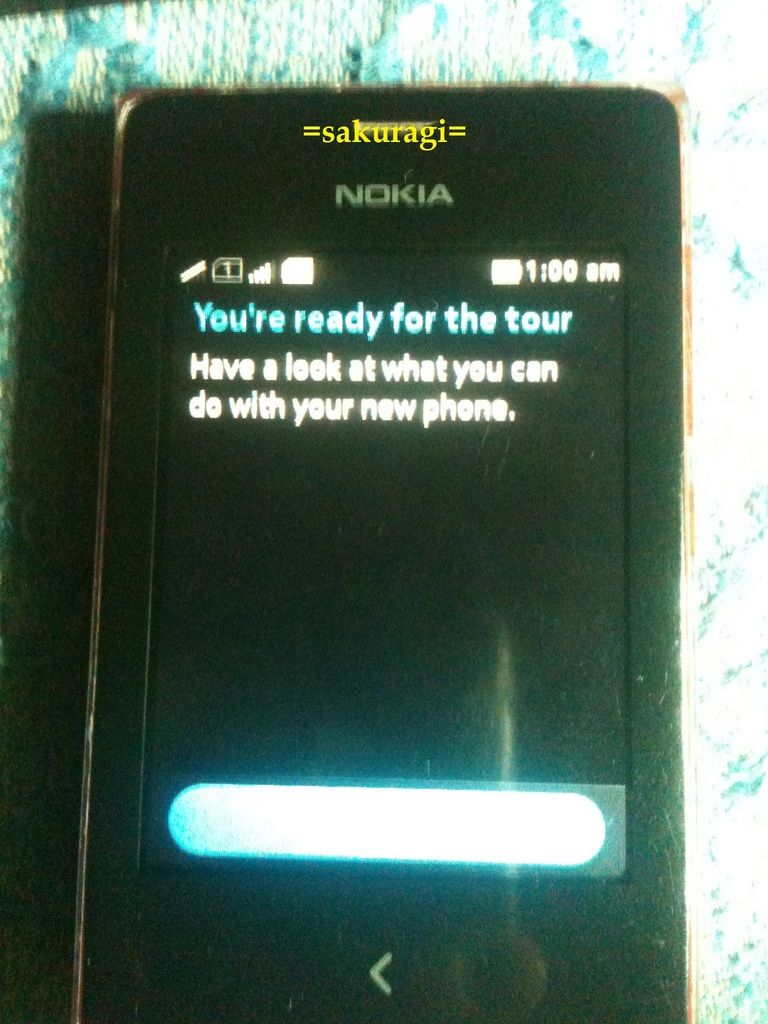

Wait flashing to be completed

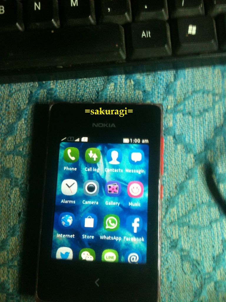

Then Smile!:D
Proof:
Security Code
Open Mxkey & Flash CNT file Only
Done
