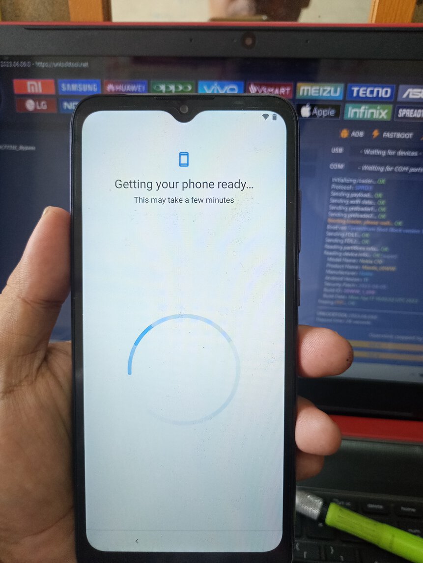

Nokia c10 ta-1342 frp
open unlock tool

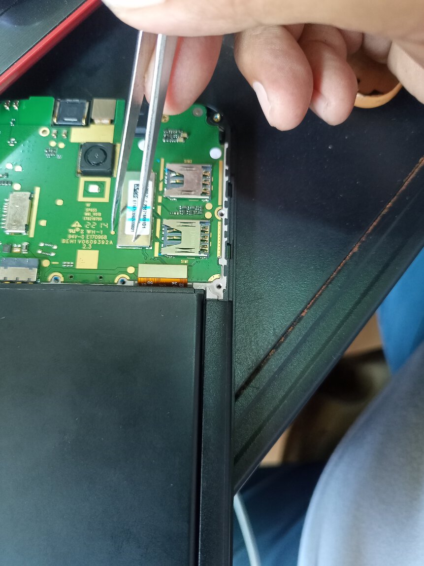

baklasin mo yung cp kc meron siyang test point.
click frp.
nakakabit yung battery wag mo tanggalin.
wait molang ng ilang secondo at magiging ok na siya.
tignan sa larawan .

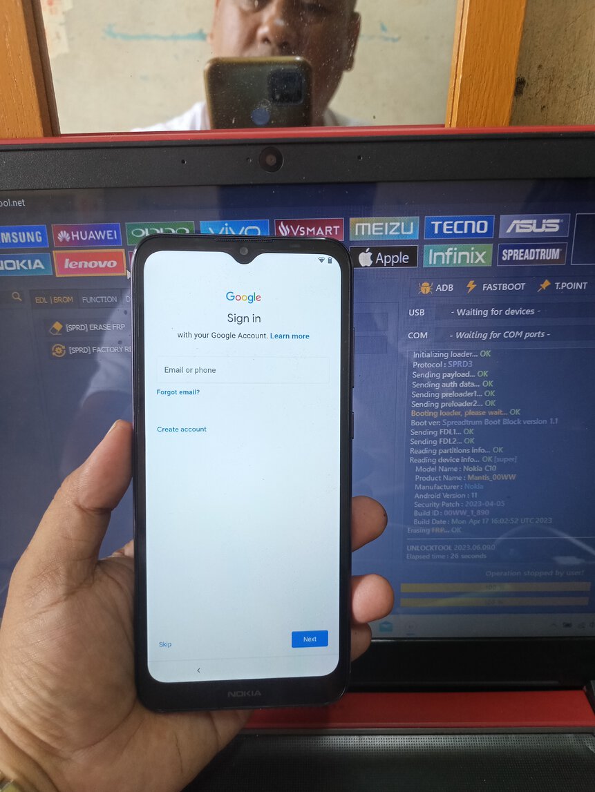

[SPRD] ERASE FRP Selected Platform : SC7731E_Bypass
Connect Testpoint or hold VOL DOWN! Instruction here!
Waiting for device... COM29 (SPRD U2S Diag)
USB : USB\VID_1782&PID_4D00\6&7C73B26&0&2
Initializing loader... OK
Protocol : SPRD3
Sending payload... OK
Sending auth data... OK
Sending preloader1... OK
Sending preloader2... OK
Booting loader, please wait... OK
Boot ver: Spreadtrum Boot Block version 1.1
Sending FDL1... OK
Sending FDL2... OK
Reading partitions info... OK
Reading device info... OK [super]
Model Name : Nokia C10
Product Name : Mantis_00WW
Manufacturer : Nokia
Android Version : 11
Security Patch : 2023-04-05
Build ID : 00WW_1_890
Build Date : Mon Apr 17 16:02:52 UTC 2023
Erasing FRP... OK
UNLOCKTOOL 2023.06.09.0
Elapsed time : 26 seconds

tested 100 percent salmat
