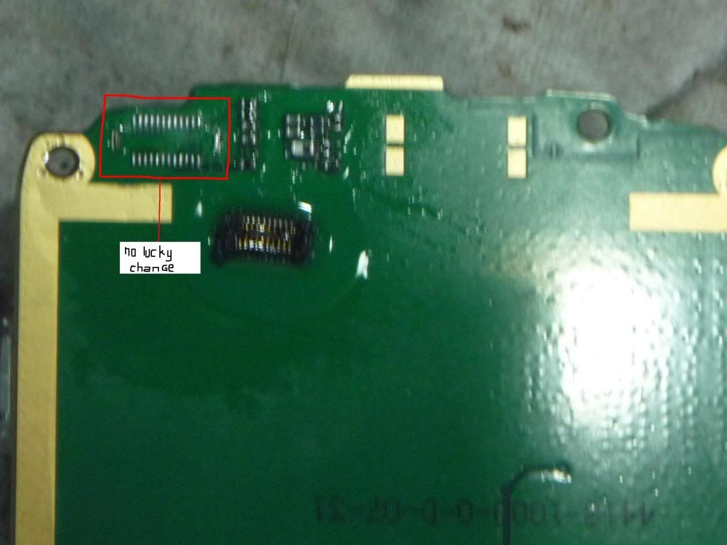

action taken: hardware
procedure:

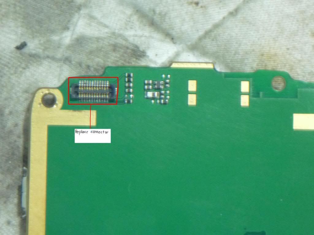

1. replace connector for lcd

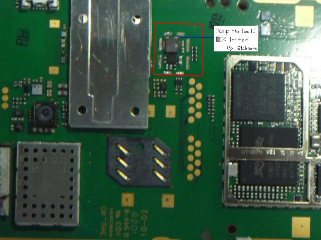

2. change inductor
3.change light IC

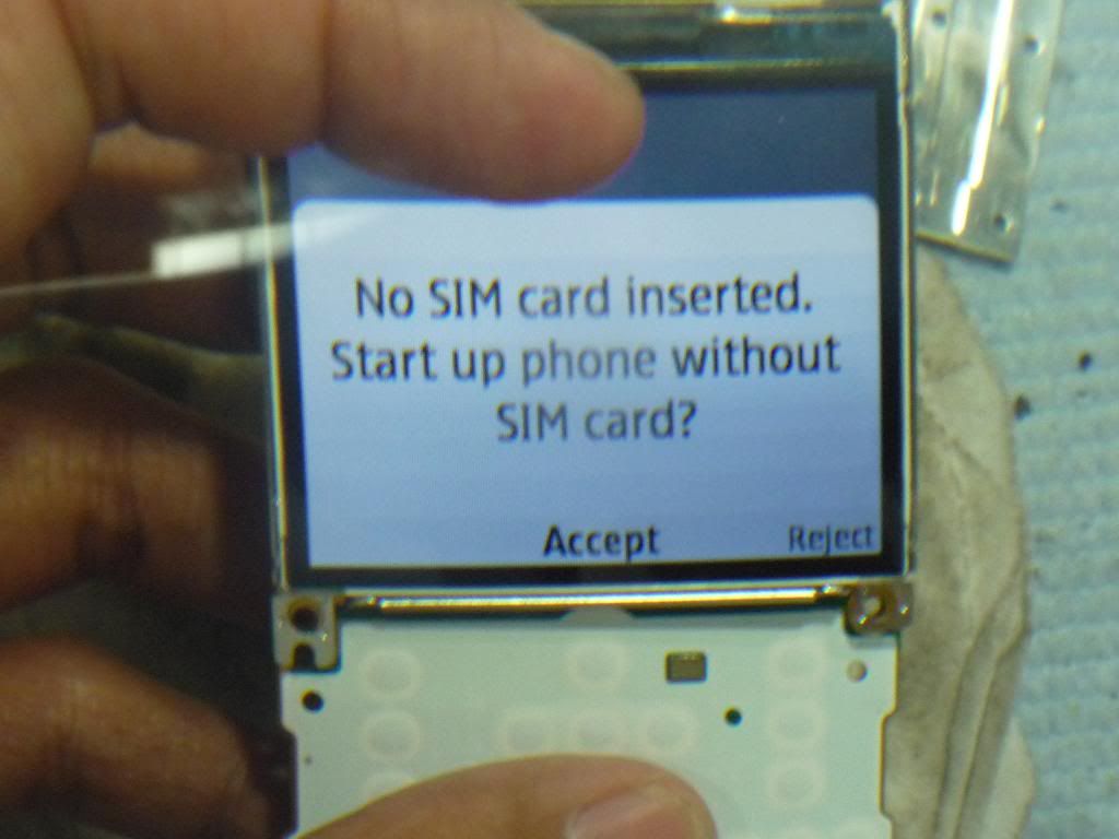

done!!!
