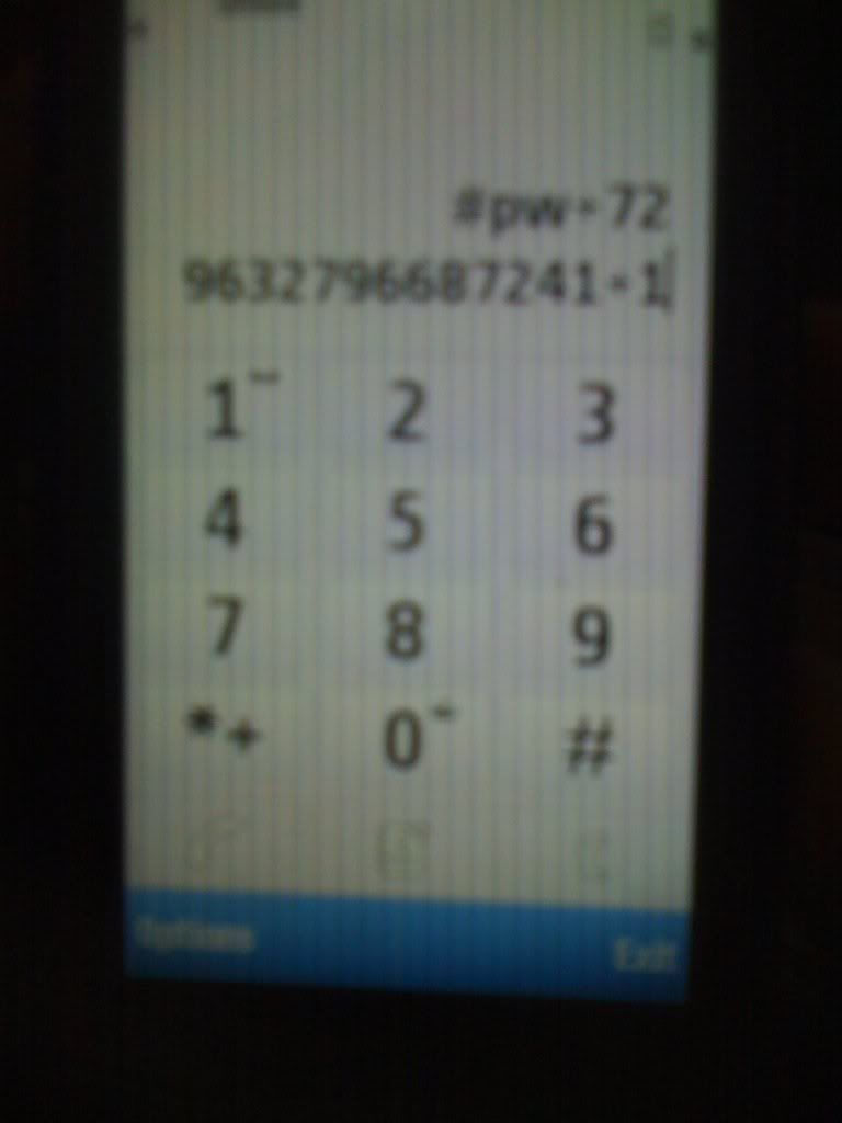

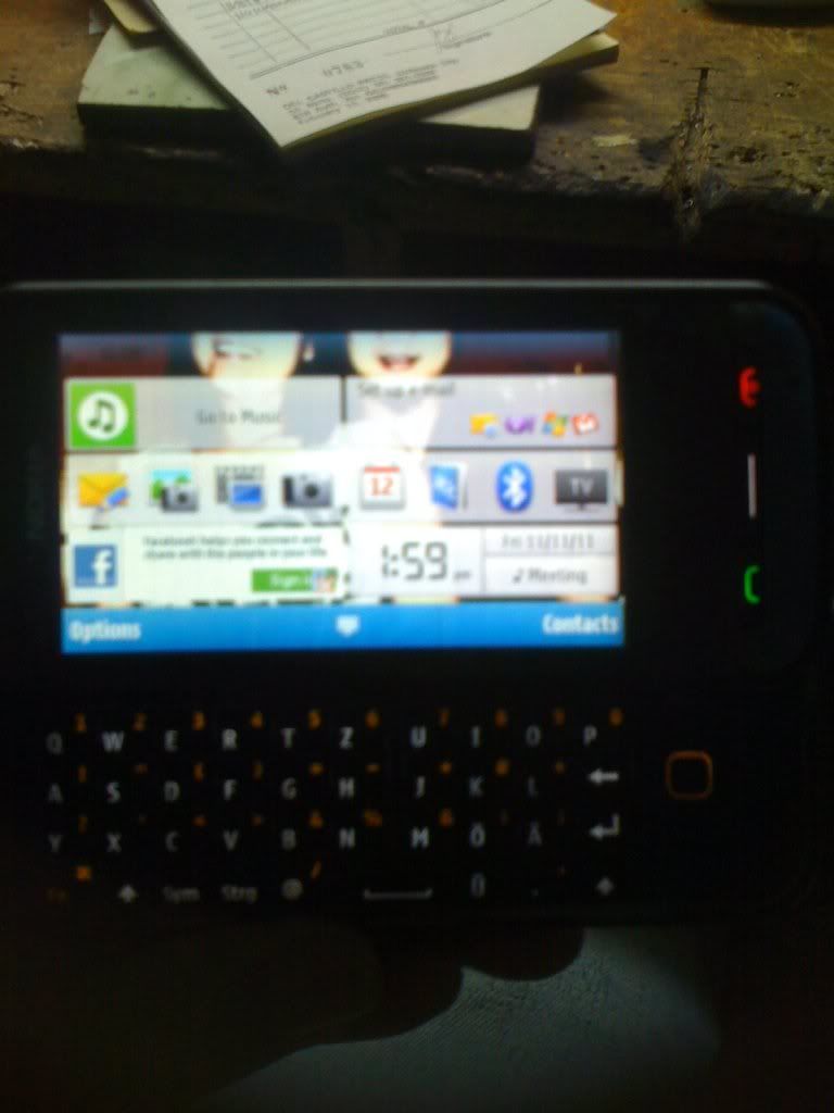

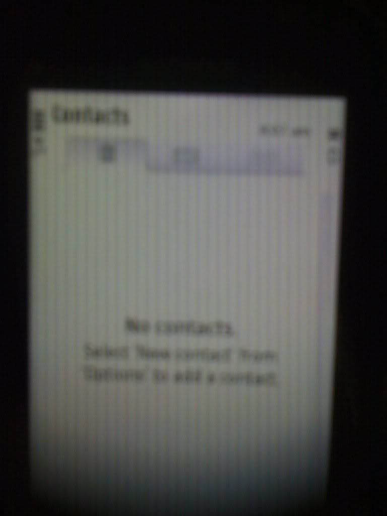

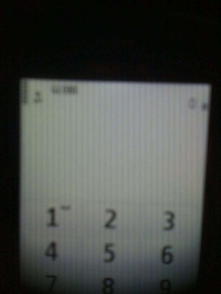

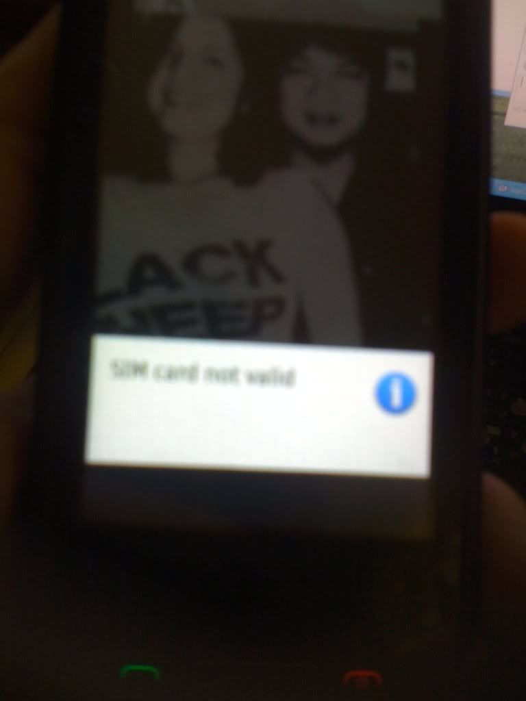

Share ko lang mga idol...
Nokia C6-00 UNLOCKED
PROCEDURE
Contact first CODE DECODER
Read SHA FILE (ginamit kong gadget mga idol CYCLONE BOX)
HERE'S THE LOGS
HERE'S THE PICTURE
http://i1235.photobucket.com/albums/ff431/cyberfury83/IMG_0458.jpg
http://i1235.photobucket.com/albums/ff431/cyberfury83/IMG_0461.jpg
http://i1235.photobucket.com/albums/ff431/cyberfury83/IMG_0462.jpg
http://i1235.photobucket.com/albums/ff431/cyberfury83/IMG_0463.jpg
http://i1235.photobucket.com/albums/ff431/cyberfury83/IMG_0464.jpg
PROCEDURE
HERE'S THE LOGS
