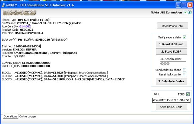

procedure
backlas mode ang phone:
open logger latest version 1.6
fully turn on phone:
tick scan
then tick read sl3 hash
MXKEY [FT SCR2000 0], SN: C0806889
Using device: USB Phonet and HTI, FW ver: 00.24, SN: 0001049C
Connection status: EHCI:HUB:USB 2.00 (High-speed)
Driver: nmwcdc, ver: 7.1.32.70
Library ver: 1.0.0.13672(13-12-2011)
Phone type: RM-626 (Nokia E7-00)
SW version: V 92PS1_10w46.9 01-03-11 RM-626 (c) Nokia
ApeCoreSw: 014.002
Product code: 059G4D5
SW version: 014.002
LanguagePkg version: 014.002.00.01014.002.37.01014.002.278.04
Waiting for USB device removal ...
Device connected: nmwcdnsuc\Nokia USB Flashing Generic, PORT_ID: 15C61624
CMT SYSTEM ASIC ID: 000000030000022600010007600C192102031104 [RAPUYAMA ver: 1.1]
CMT EM0 ID: 00001040
CMT EM1 ID: 00001030
CMT PUBLIC ID: 12700009F2D803449DD46EB55D9A7693B36B1730
CMT ASIC MODE ID: 00
CMT ROOT KEY HASH: 916F75217F32081248B15C38DFC8E81B
CMT ROM ID: E693EF0DAC22615B
Loading CMT secondary boot code
SecondaryBoot: RAPUv11_2nd.fg [BB5] version: 11.34.0 revision: 3.0 size: 0x3B40
Supported Ids: 4003192102001104, 400C192102001104, 6003192102001104, 600C192102001104, 6003192102011104, 600C192102011104, 6003192102021104, 600C192102021104, 6003192102031104, 600C192102031104
eBB5ProtocolType: NEW
Secondary boot loaded.
Storage0: 0000 0000 - 0000 0000 type: RAM, asic:CMT
Storage1: FFFF 0000 - 0000 0000 type: MMC, asic:CMT
Storage2: 0020 0068 - 0000 0031 [ST LH28F160BG] type: FLASH,NOR, asic:CMT
Storage3: 0000 0001 - 0000 0000 [unused/removed] type: FLASH,NOR, asic:CMT
Storage4: 0020 0068 - 0000 0031 [ST LH28F160BG] type: FLASH,MuxOneNAND, asic:CMT
Suggested algorithm: XSR 1.6
Loading CMT update server data
Algorithm: RAPUv11_XSR17_alg.fg [XSR 1.6] version: 11.34.0 revision: 3.0 size: 0xD40B0
Update server code loaded.
Waiting for USB device removal ...OK
Waiting for USB device arrival ...OK
FUR: Adding Asic CMT as client OK.
PRIVATE ID: 6C6F1BDDC1798BDBBF4C1E7A56E0A70DC332A84A
E-FUSE: 2DFD5366
SEC ROM CRC: AC22615B
Waiting for device boot up ...
Device connected: nmwcdc\Nokia E7-00 USB Phonet, PORT_ID: 58678FD
Verifying communication to device OK.
Verifying secure data ...OK
HASH: 446447C061FA736A79057388F48F446B447E423C
Hash file saved to "C:\mobileEx\3.5\data\SL3\New Folder\RM-626_354864049294334.sha"
just follow the steps
calculate sha file....hehehe si brow ang nag calculate.

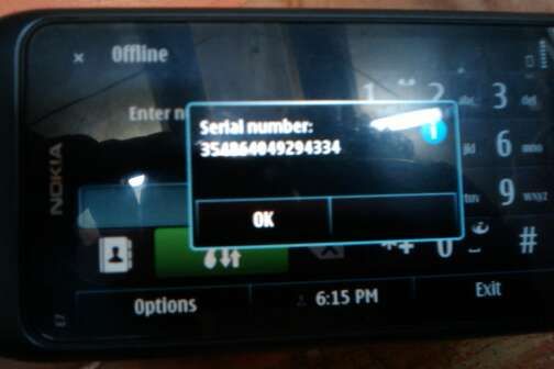

#pw+379449742302642+1#
#pw+822112138478148+2#
#pw+088106509547618+3#
#pw+088313905491696+4#
#pw+711041340046054+5#
#pw+783078553510597+6#
#pw+723436398235273+7#

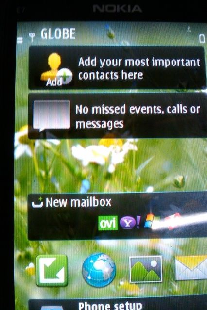

patunay
