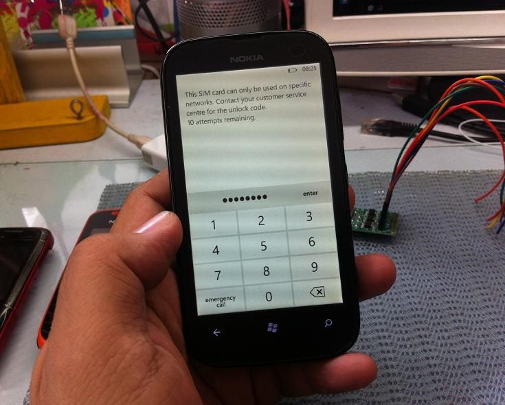

Nokia Lumia 510 unlocked done by ATF JTAG

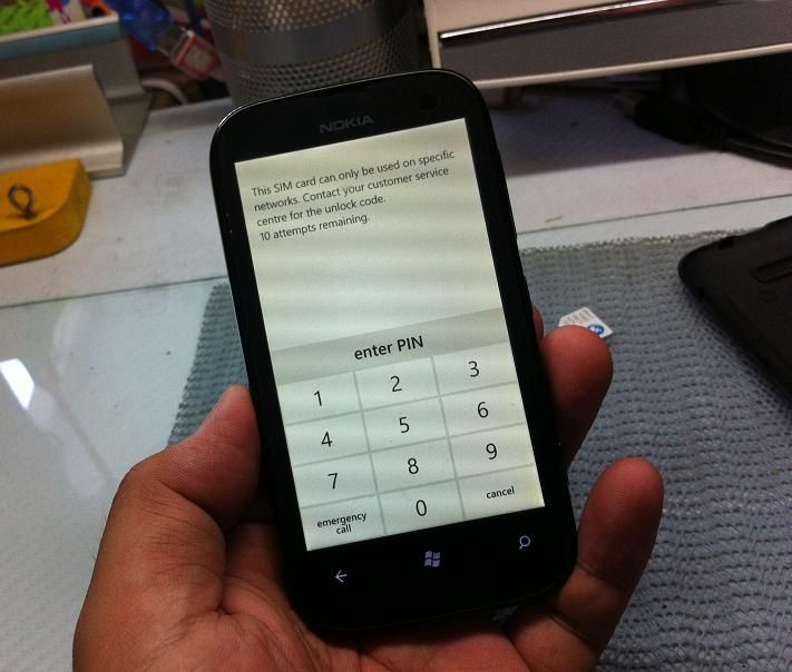

Phone is locked in TESCO Network
TOOLS:
- ATF NITRO or ATF BOX (JTAG ACTIVATED)
- Modified RJ45 Fbus Cable ( Don't use LAN CABLE use OLD Nokia FBUS cable )
or
- ATF 4 IN 1 JTAG/EMMC/ISP/MMC Adaptor
- CA-101 usb cable (for phone power supply)
PROCEDURE:

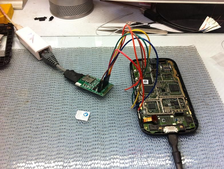

1. Dissamble phone first

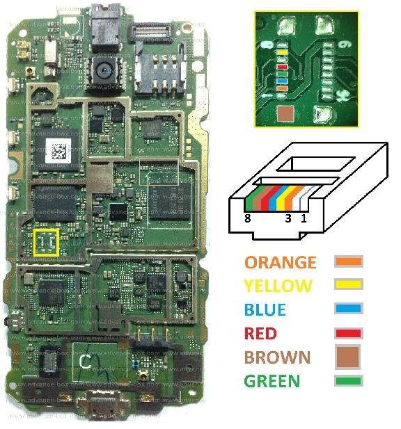

2. Soldered pinout
PINOUT:

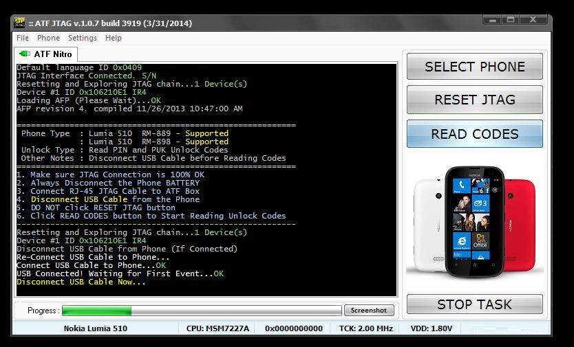

3. Run ATF JTAG software (Jtag Activation required)
4. Click SELECT PHONE
5. Browse the file in C:\AdvanceBox Turbo Flasher\Phones\UNLOCK
and select LUMIA_510_UNLOCK.afp ( no need to download this file included in ATF Setup installer )
6. Connect Phone with RJ45 JTAG cable pinout to ATF BOX

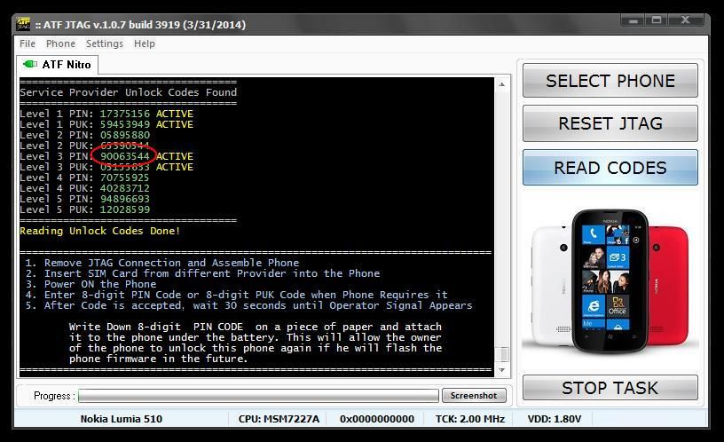

7. click READ CODES
8. connect CA-101 usb cable to phone connected to PC as your power supply
9. disconnect CA-101 usb cable
10. connect CA-101 usb cable again until read codes finish
Finish Read Codes
11. disconnect phone from box remove soldered pinout and assemble the phone

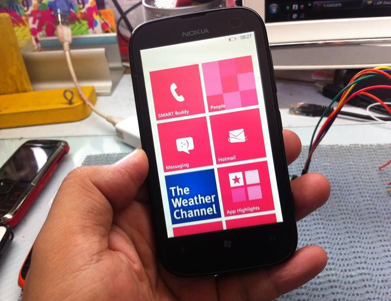

12. power on phone with non accepted simcard then enter the 8 digit PUK code
UNLOCKED DONE.
Now working on other simcard network
