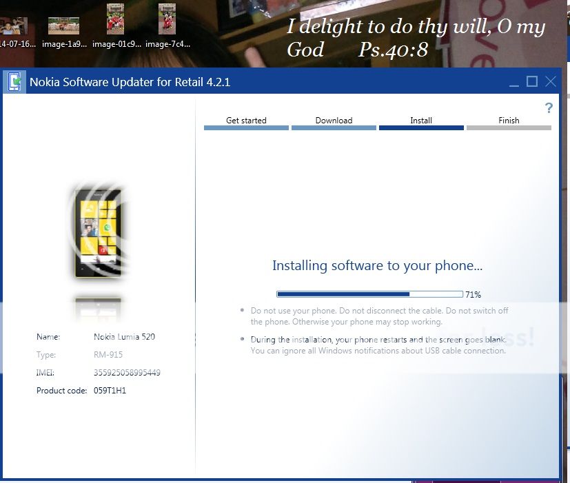

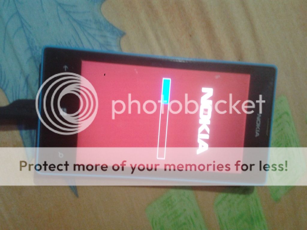

share ko lang po LUMIA 520-2 stuck on gears
done on NSU...
DL here NSU: http://www.techmesto.com/download-no...retail-latest/
install nokia software updater
connect phone via USB (micro) while hold volume down and power
once connected and phone detected by NSU it will download software for restore
wait until process finish...
