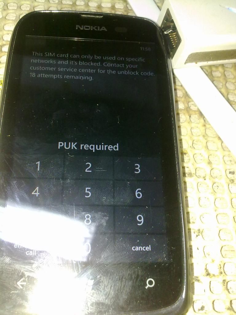

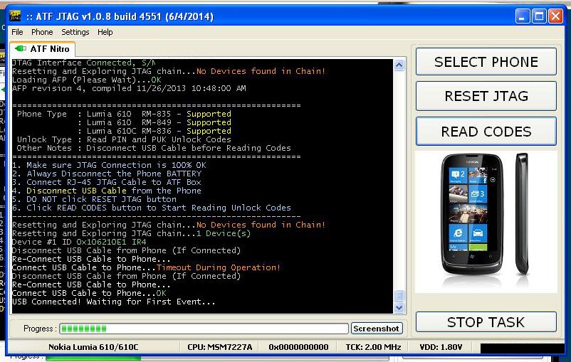

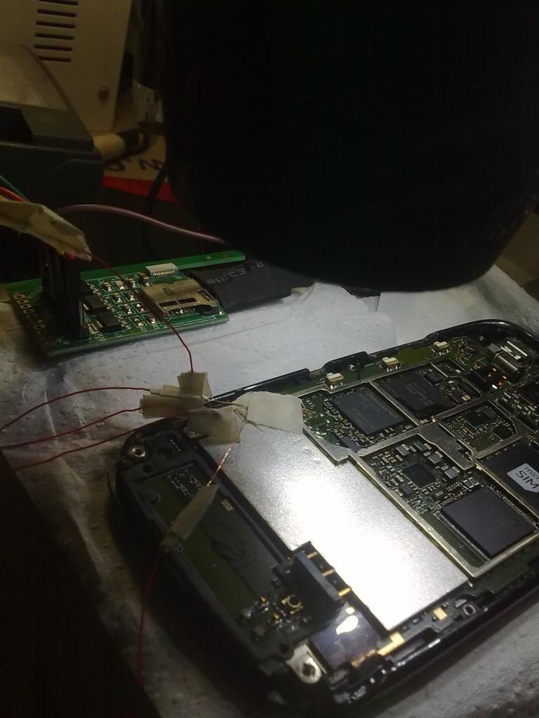

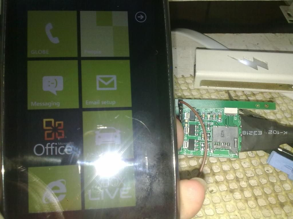

Default language ID 0x0409
JTAG Interface Connected,
Resetting and Exploring JTAG chain...No Devices found in Chain!
Loading AFP (Please Wait)...OK
AFP revision 4, compiled 11/26/2013 10:48:00 AM
Phone Type : Lumia 610 RM-835 - Supported
: Lumia 610 RM-849 - Supported
: Lumia 610C RM-836 - Supported
Unlock Type : Read PIN and PUK Unlock Codes
Other Notes : Disconnect USB Cable before Reading Codes
1. Make sure JTAG Connection is 100% OK
2. Always Disconnect the Phone BATTERY
3. Connect RJ-45 JTAG Cable to ATF Box
4. Disconnect USB Cable from the Phone
5. DO NOT click RESET JTAG button
6. Click READ CODES button to Start Reading Unlock Codes
Resetting and Exploring JTAG chain...1 Device(s)
Device #1 ID 0x106210E1 IR4
Disconnect USB Cable from Phone (If Connected)
Re-Connect USB Cable to Phone...
Connect USB Cable to Phone...Timeout During Operation!
Connect USB Cable to Phone...OK
USB Connected! Waiting for First Event...OK
Disconnect USB Cable Now...OK
Waiting for Device Connection 10 second(s)...OK
Resetting and Exploring JTAG chain...OK
Halting Core...OK
Initializing Device...OK
Retrieving Unlock Codes...OK
Service Provider Unlock Codes Found
Level 1 PIN: 52437419 ACTIVE
Level 1 PUK: 60336613 ACTIVE
Level 2 PIN: 82725972
Level 2 PUK: 86293851
Level 3 PIN: 14552729
Level 3 PUK: 58366952
Level 4 PIN: 48727954
Level 4 PUK: 25812646
Level 5 PIN: 14112139
Level 5 PUK: 25838398
Reading Unlock Codes Done!
1. Remove JTAG Connection and Assemble Phone
2. Insert SIM Card from different Provider into the Phone
3. Power ON the Phone
4. Enter 8-digit PIN Code or 8-digit PUK Code when Phone Requires it
5. After Code is accepted, wait 30 seconds until Operator Signal Appears
Write Down 8-digit PIN CODE on a piece of paper and attach
it to the phone under the battery. This will allow the owner
of the phone to unlock this phone again if he will flash the
phone firmware in the future.
