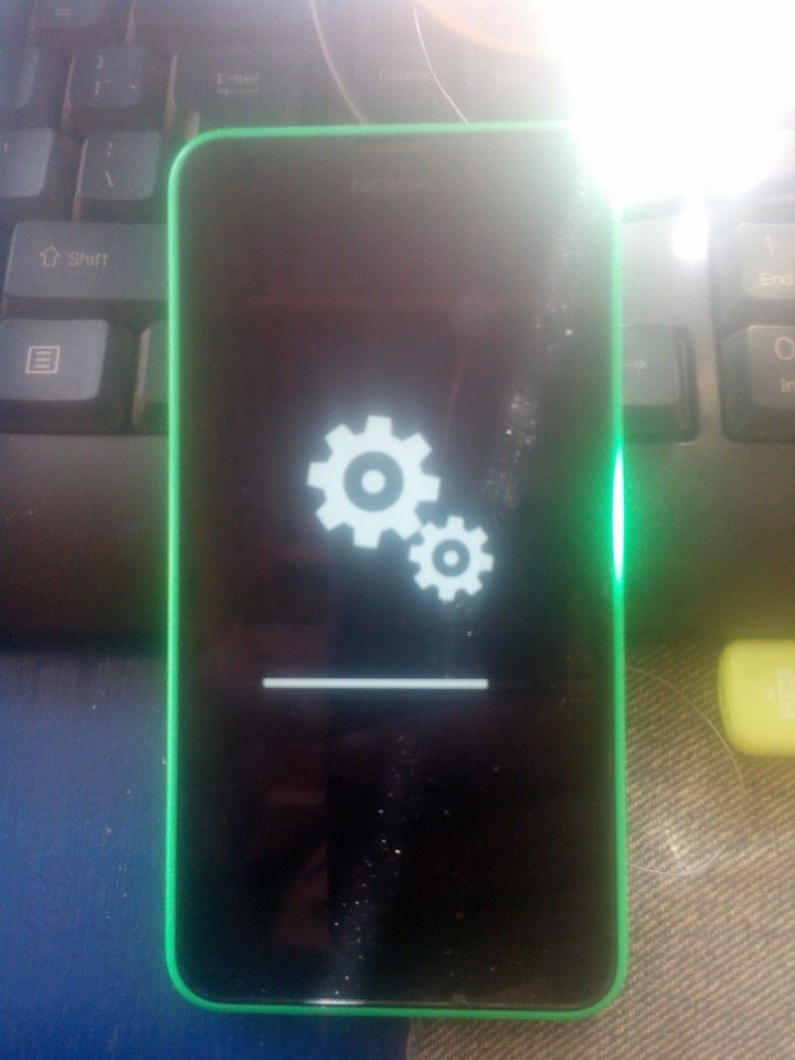

Turn the phone off.
Press and hold the power button. When the phone vibrates, release it and press and hold the volume down button until you see the exclamation mark on the screen.
Another way to do this - press and hold the volume down button and connect the charger.
Whit the exclamation mark on the screen press this sequence of keys:
-> Volume Up
-> Volume Down
-> Power button
-> Volume Down

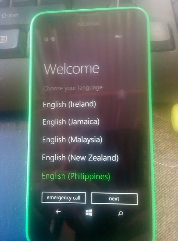

MEDU MATAGAL PO 10-15 MINUTES PO BAGO MATAPOS ANG REFORMAT..

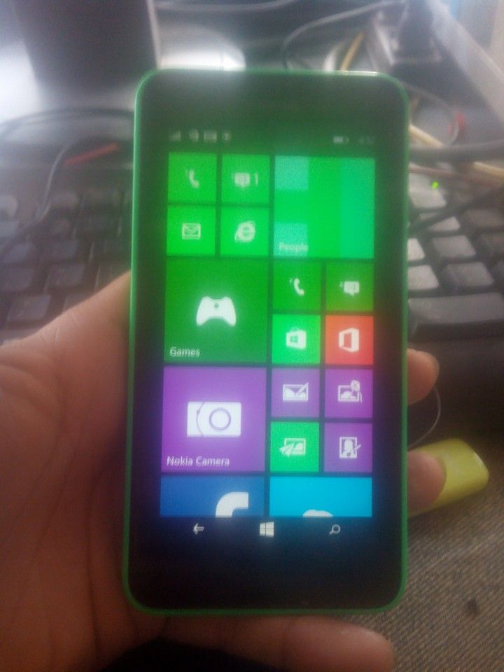

ITO NAPO DONE NA..KWARTA NA..
