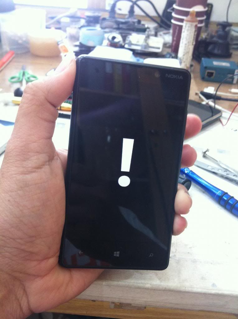

Procedure:
Press and hold the power key and volume down key
after vibrate release the power key you will see this symbol (!) on screen

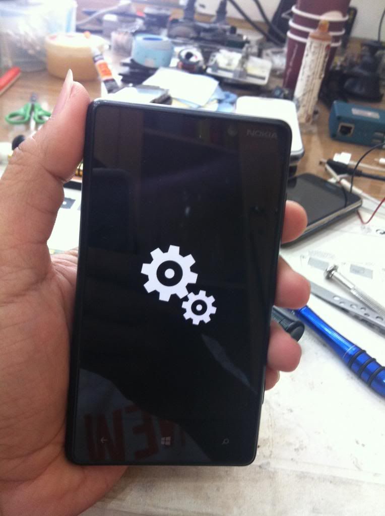

then press
1. volume up
2. volume down
3. power key
4. volume down
Process will start OS reset
<textarea style="width: 500px;" readonly="readonly" class="ncode_imageresizer_warning" id="ncode_imageresizer_warning_4">Click here to view the original image of 764x1024px.</textarea>

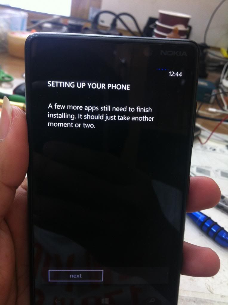

it will take approximately 3 minutes.....

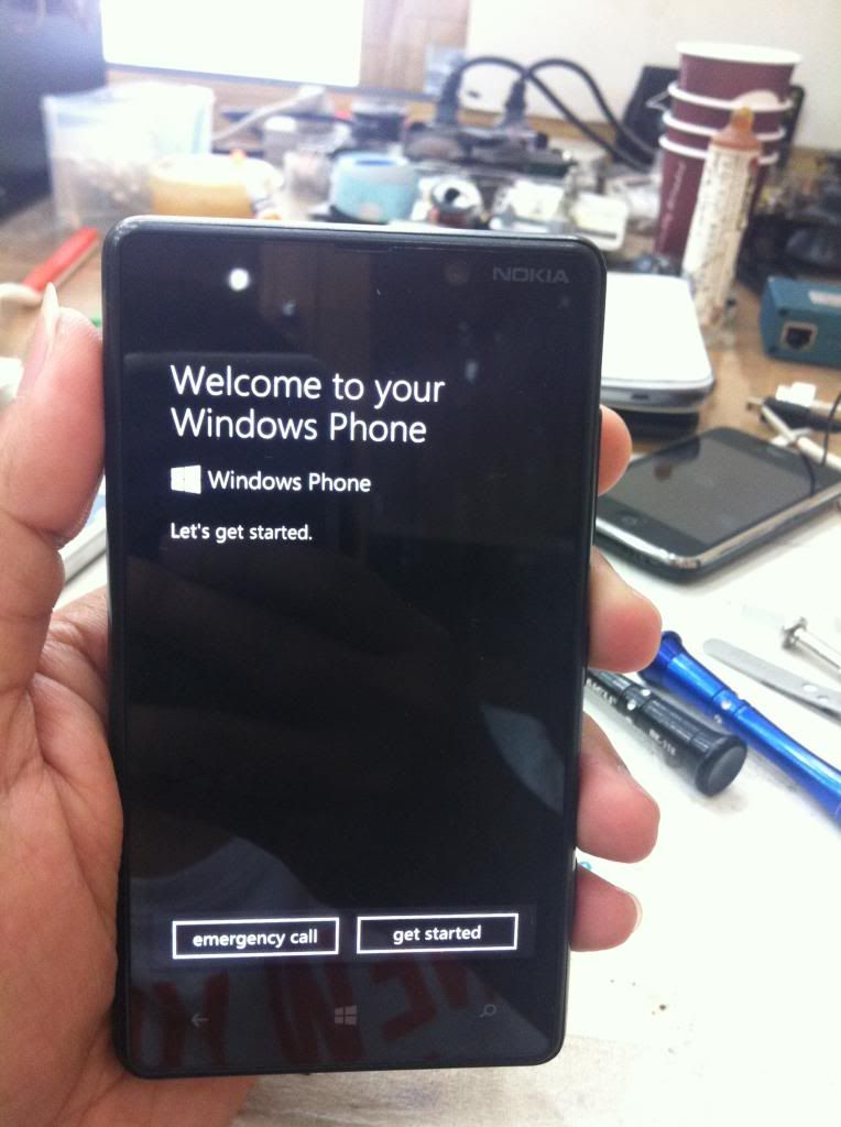

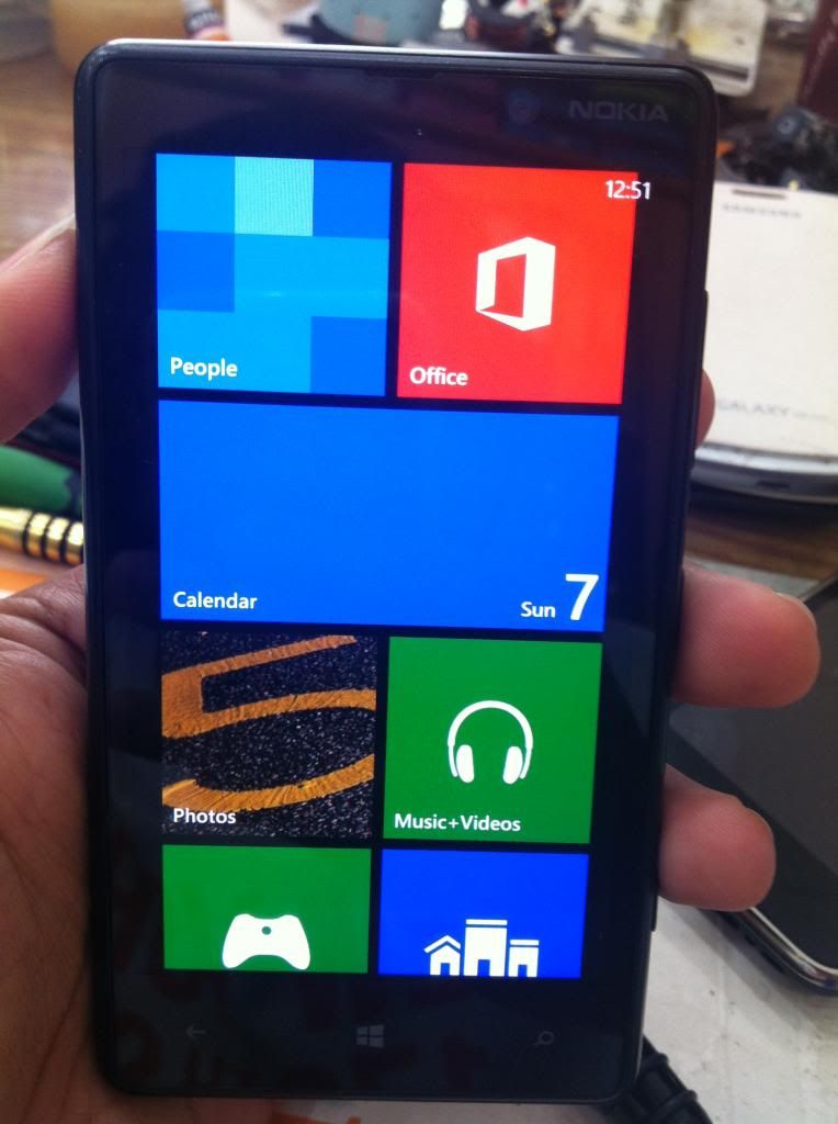

Finish:
<textarea style="width: 500px;" readonly="readonly" class="ncode_imageresizer_warning" id="ncode_imageresizer_warning_5">Click here to view the original image of 764x1024px.</textarea>
<textarea style="width: 500px;" readonly="readonly" class="ncode_imageresizer_warning" id="ncode_imageresizer_warning_2">Click here to view the original image of 764x1024px.</textarea>
<textarea style="width: 500px;" readonly="readonly" class="ncode_imageresizer_warning" id="ncode_imageresizer_warning_1">Click here to view the original image of 764x1024px.</textarea>
