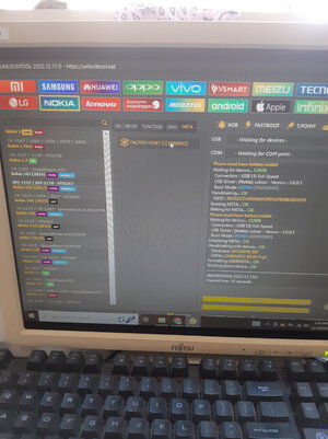

Share kulang dala ni tumer galing ibang bansa may pincode.
No need miracle
Procedure
1 open unlocktool
2 click nokia tab
3 piliin ang RM-1133
kahit hindi nya ka model ok lang
Sapol parin yan
4.off unit oh tanggalin batt
5 click factory reset sa unlocktool
6 salpak cable wala na bootkey
Maglologo kaya an lang mawala ang logo
Pag nag done na kuya mag charge
DONE!
