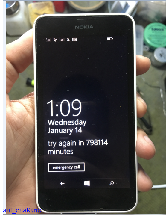

UNIT: RM 978 or LUMIA 630
ISSUE: FORGOT PASSWORD / PASSWORD ATTEMPT FAILED
SOLUTION:
HARD RESET LANG MGA BOSS

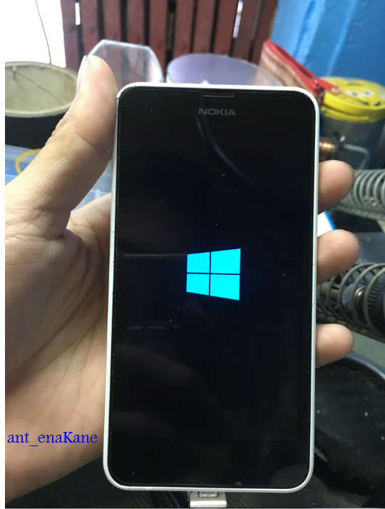

1. Power Off Unit
2. Power On Unit, pag nagvibrate, hold agad volume down

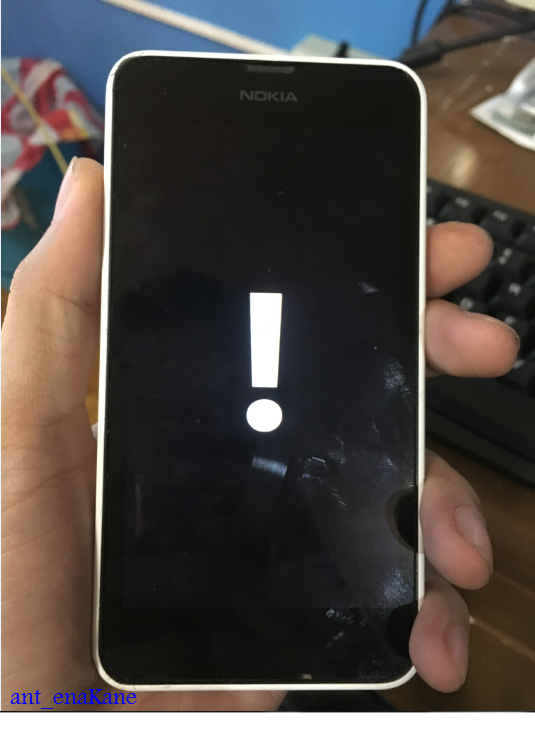

ETO LALABAS may (!) :
THEN
3. Press Volume Up
4. Press Volume Down
5. Press Power Button
6. Press Volume Down

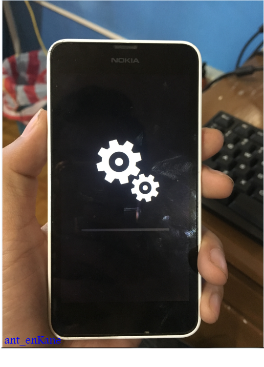

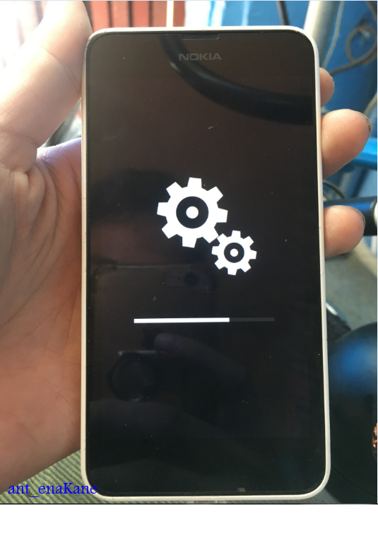

ETO NA LALABAS
Wait nyo lang mga Boss, mejo matagal 15-20 mins yan
PATIENCE IS THE KEY

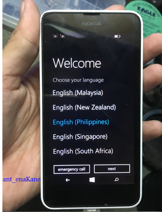

DONE NA!!
