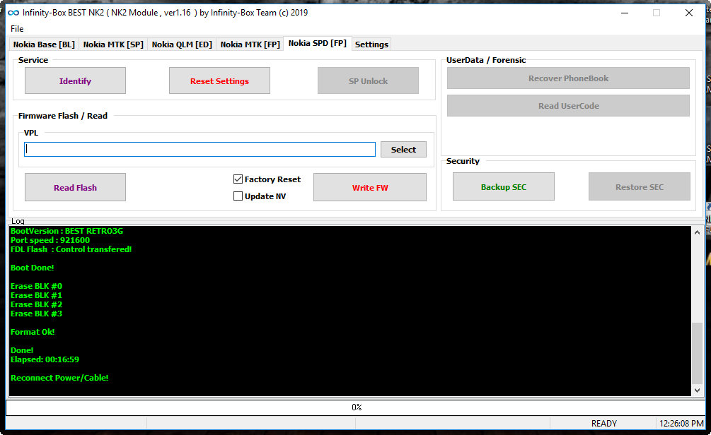

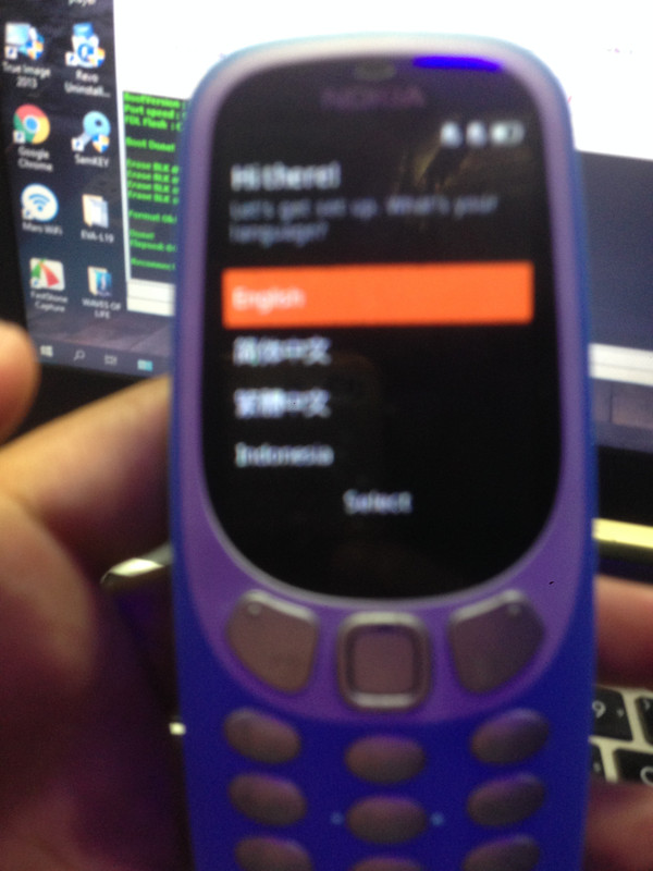

Puro Security code lang kasi nakikita about security ng Ta-1006 wlang fix na sagot ko nag success ba?
procedure:
Assuming na na install na spd driver sa infinity supports: http://dl1.infinity-best.com/47/pub.php?dir=software/Drivers/
1. Tanggalin ang baterya ng phone
2.Hold # ( remember walang baterya ) insert usb wire ( micro usb )
3.click format
4.Salpak si baterya
5.Done! mag dedetect na yan.
Finish Product:
