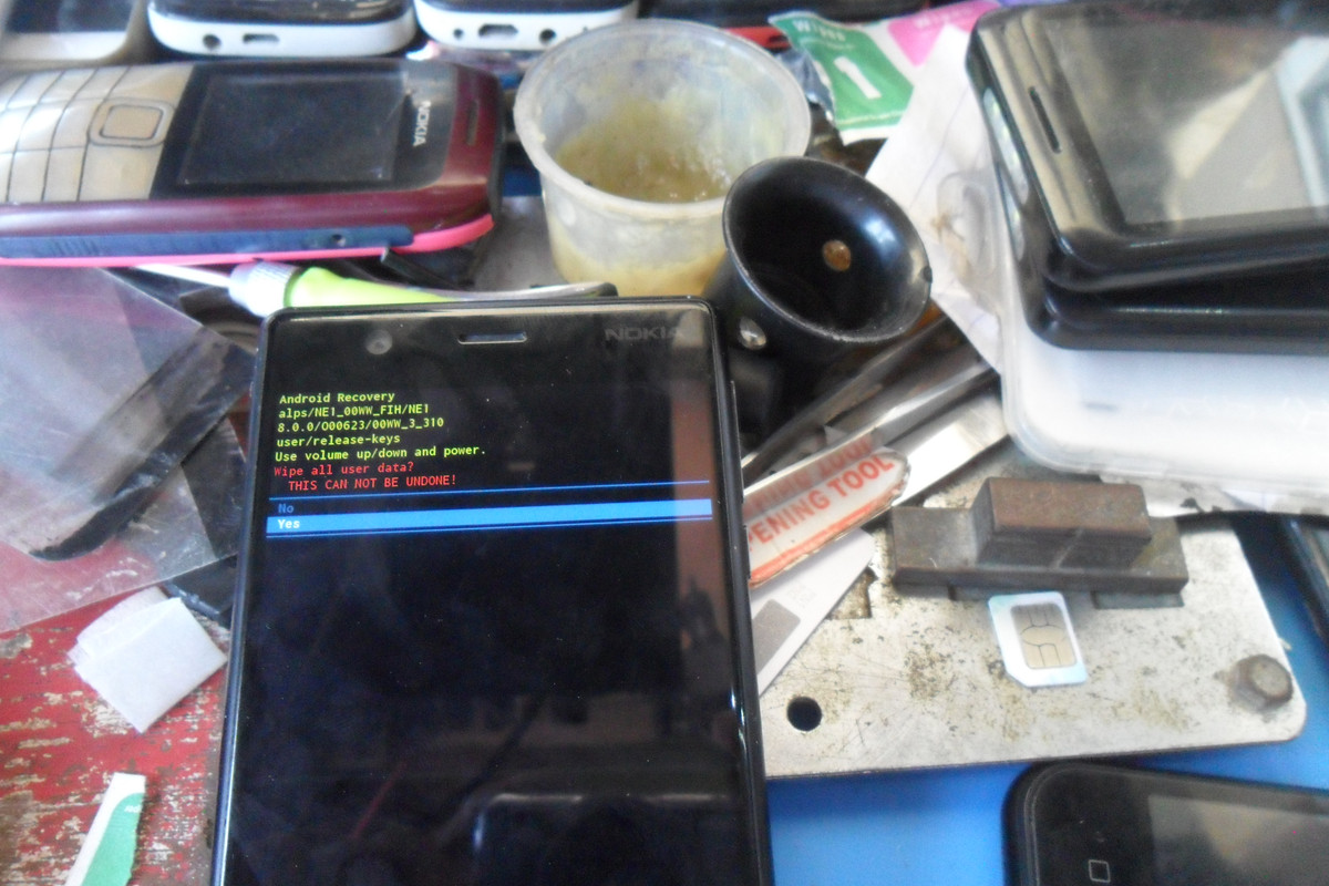

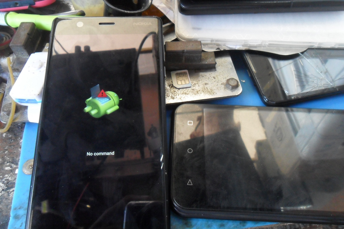

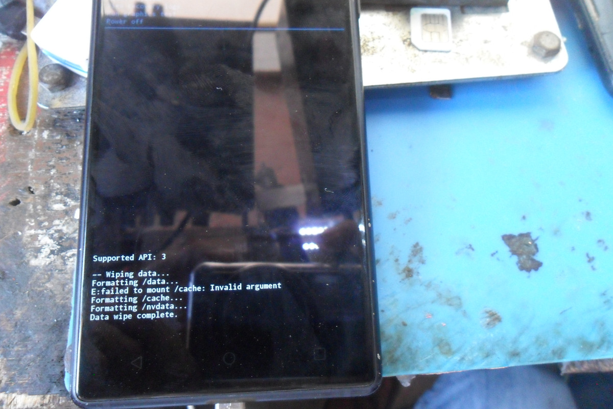

UNA HARD RESET MUNA

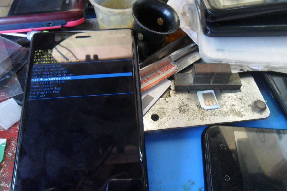

turn off unit
hold power button + volume up
hanggang android roboot
para maka pasok sa recovery menu
hold and press power button at pindutin yung volume up

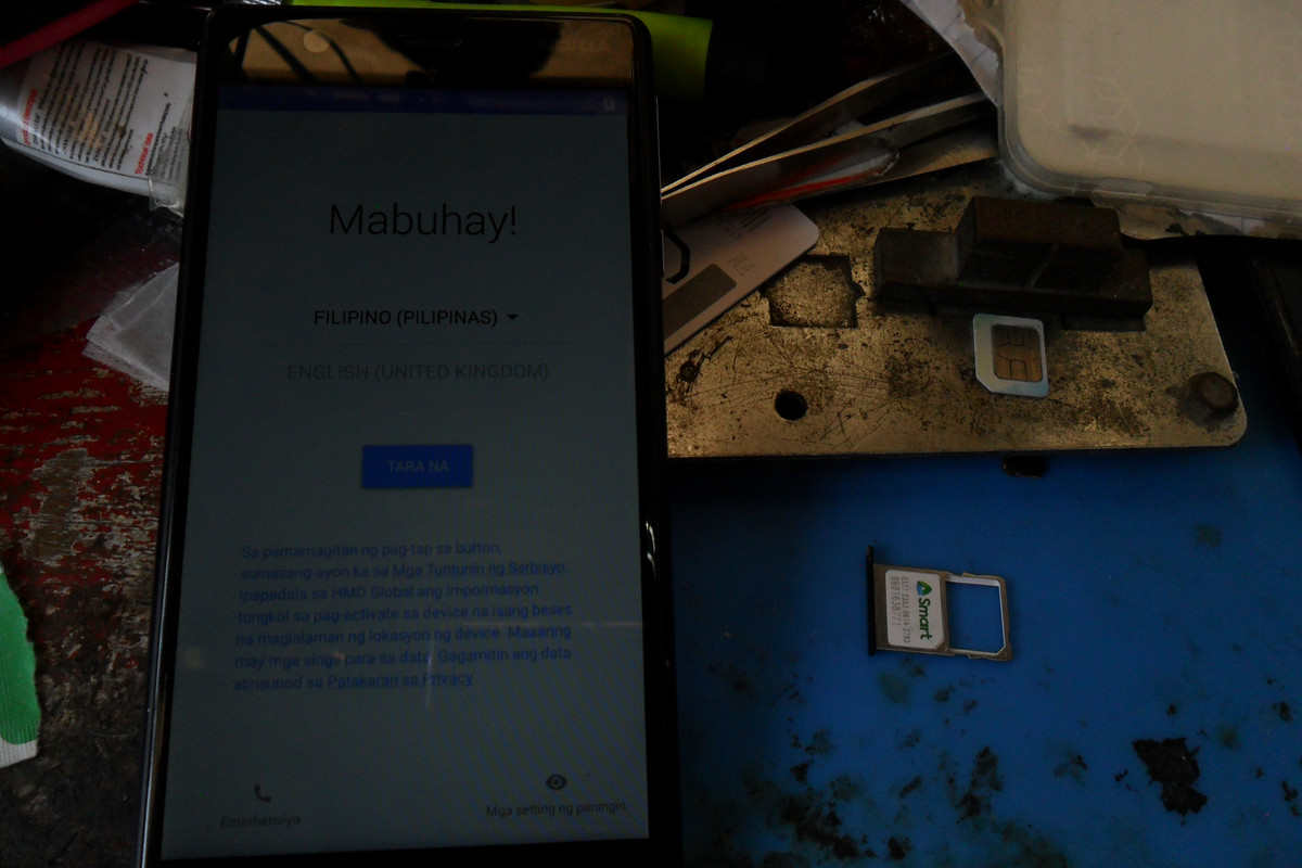

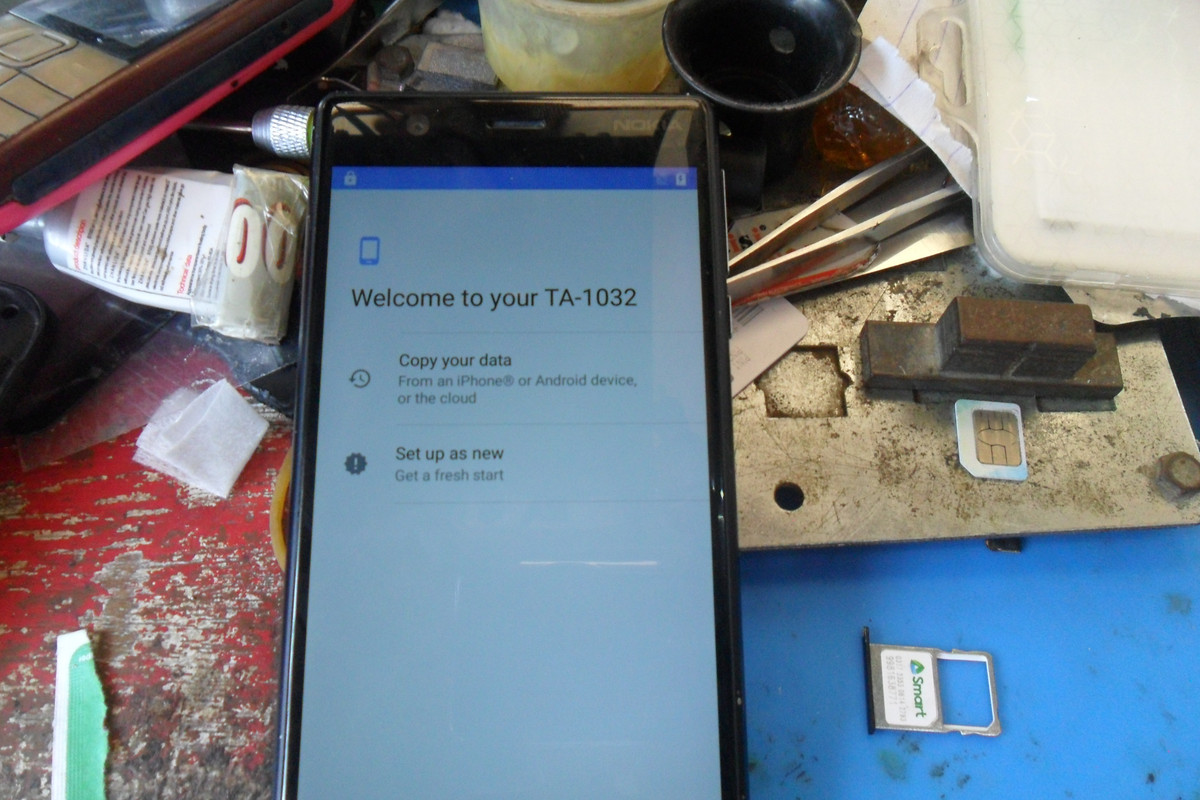

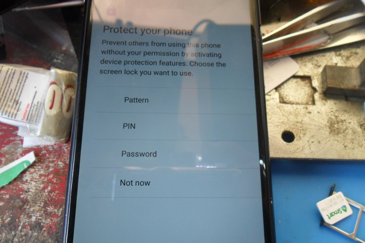

nako mayroon FRP paano aalisin

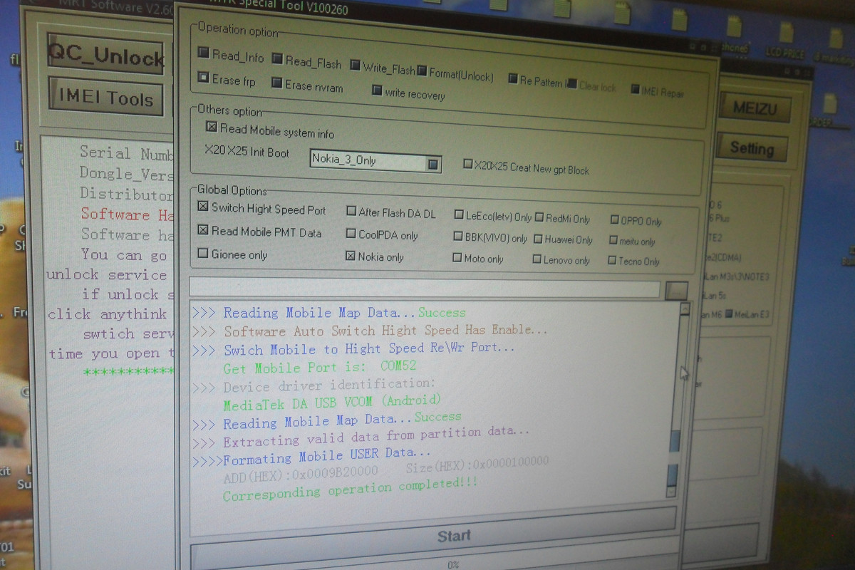

open MRT tools
v2.60
click mtk chips
setting click nokia only
click nokia 3
click erase frp
clik start
salpak usb cord

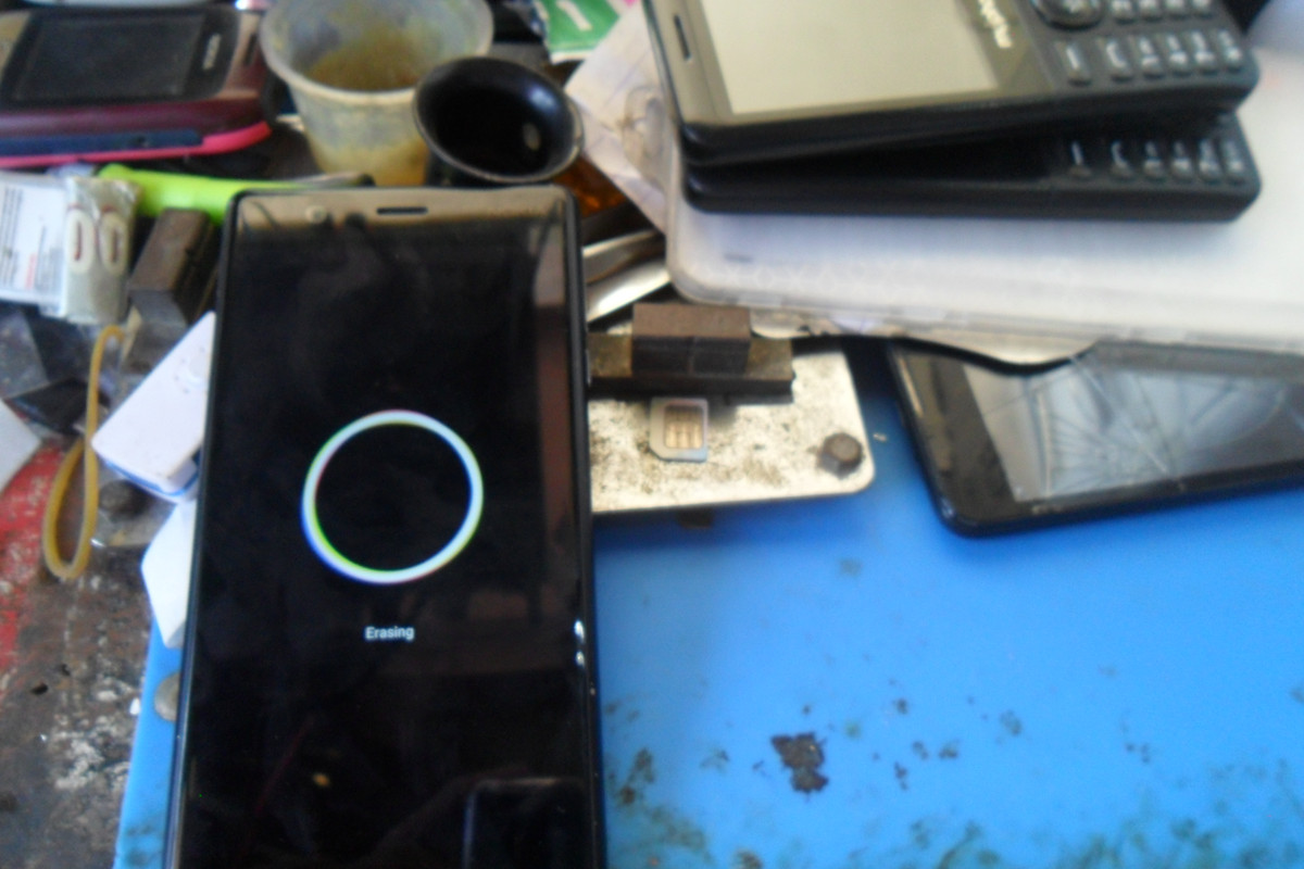

hold volume down
install driver

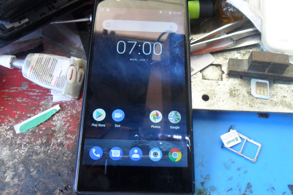

hanggang matapos
binngo
