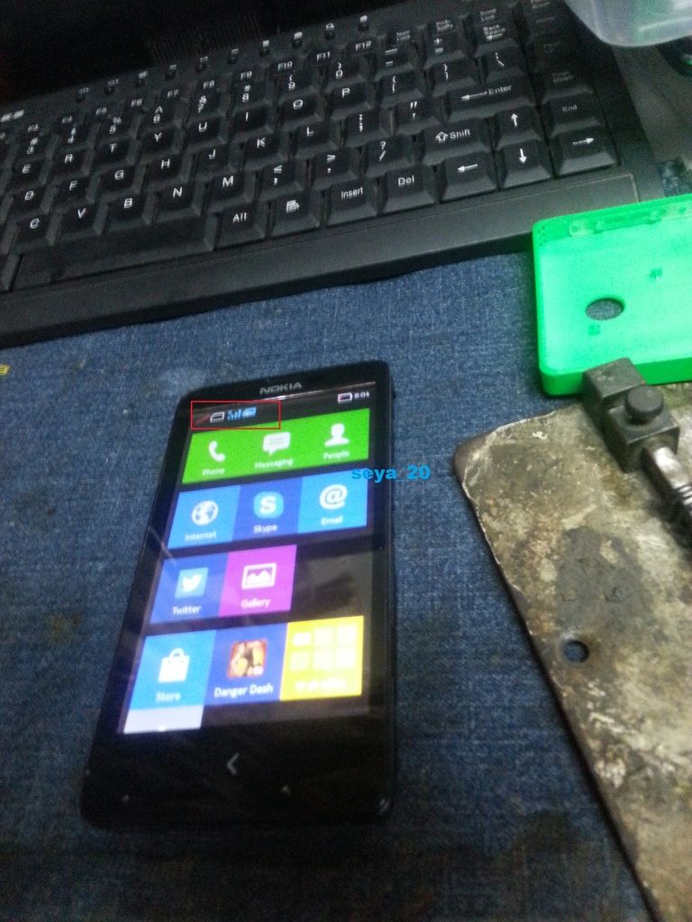

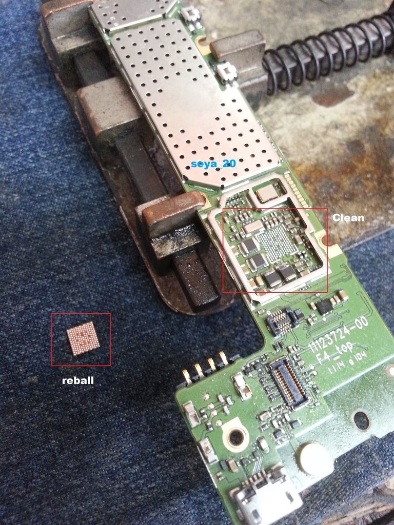

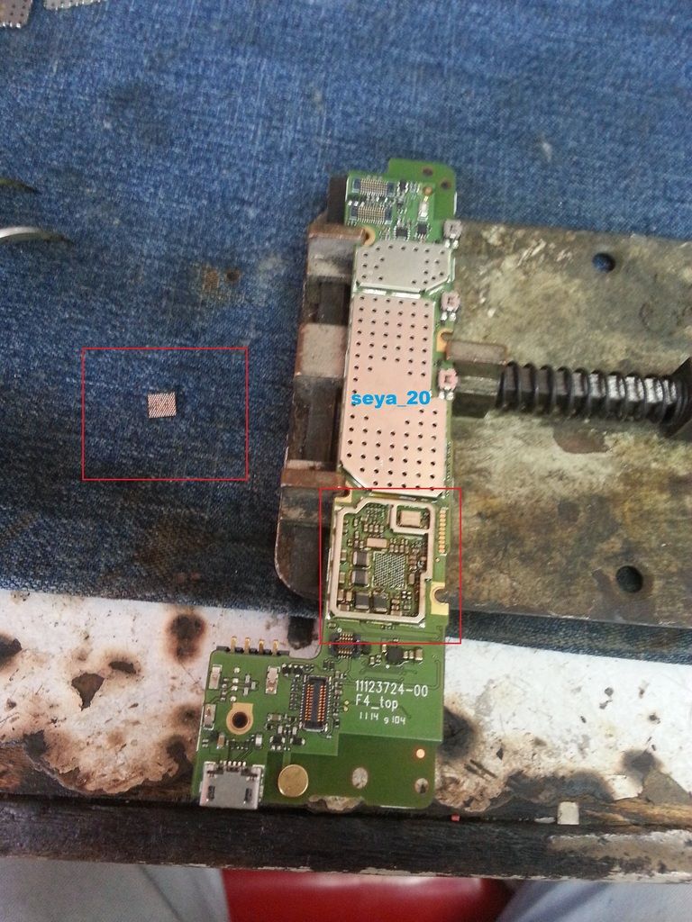

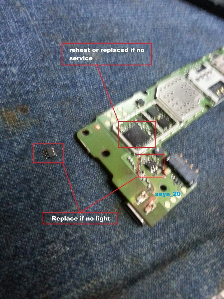

Seya Super Moderator Staff member Joined Jun 12, 2014 Messages 973 Reaction score 119 Points 81 Location quezon city Apr 7, 2015 #1 Problem Grounded/No Power/No light/No Service caused of water damage Action Taken Clean first check if the parts are corroded reball pm ic replace light ic reheat P.A Screen Shots Done for reference
