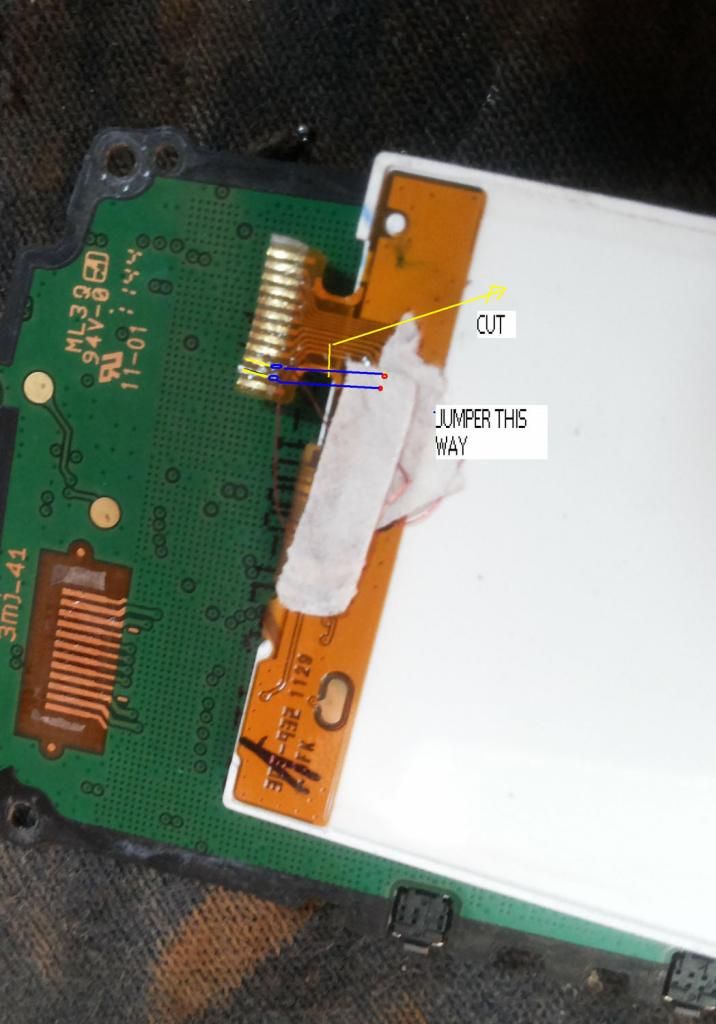

ACTION TAKEN
1.OPEN KO ANG UNIT GRABE NA BASA PALA CLEANING NO LUCK

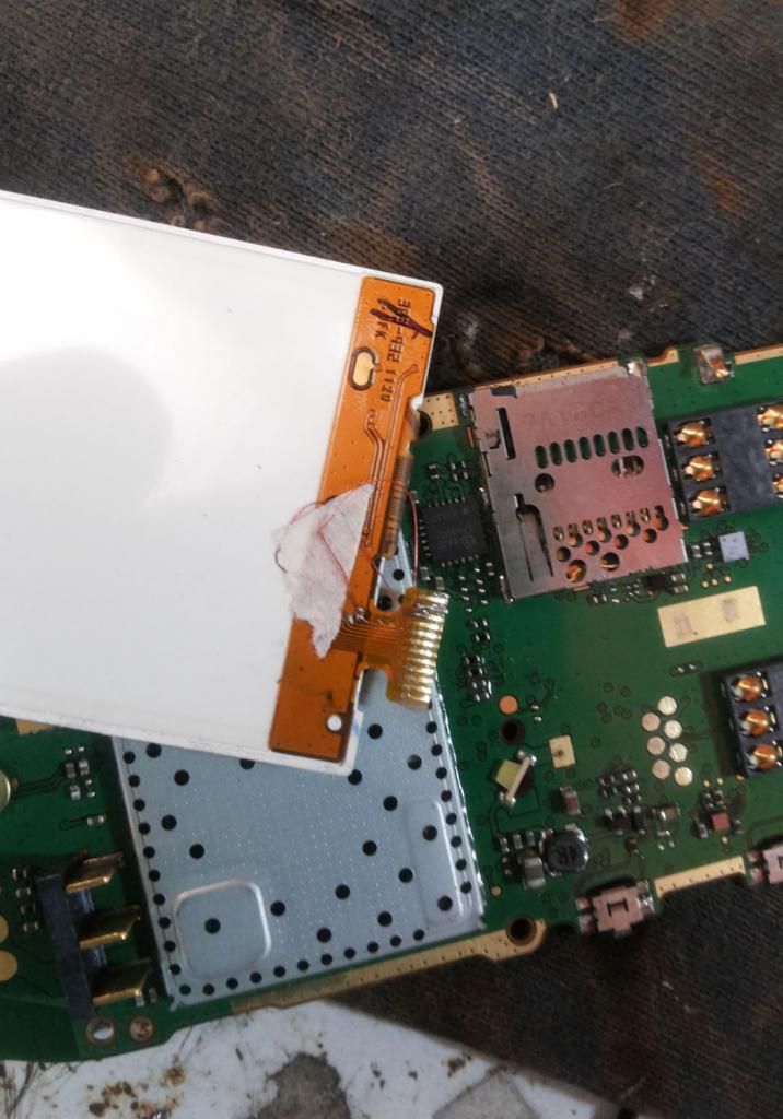

2.NAKITA Q MAY CUT ANG FLEX NG LCD DIRECT LIGHT LINE
3.CHECK ALL LINE OK NAMAN KAYA TINANGAL KO NA ANG LCD AT ETO PO ANG GINAWA Q JUMPER
ETO PO ANG PICTURE
ETO PO ANG GINAWA KO

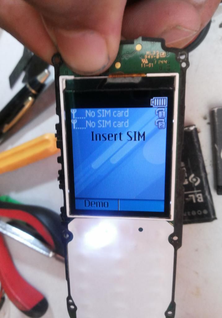

TAPOS TESTING KO NA
YAN NA PO OK NA
YAN PO MGA BOSS OK NA SANA MAKATULONG LALONG LALO NA SA MGA BAGUHANG TULAD Q
