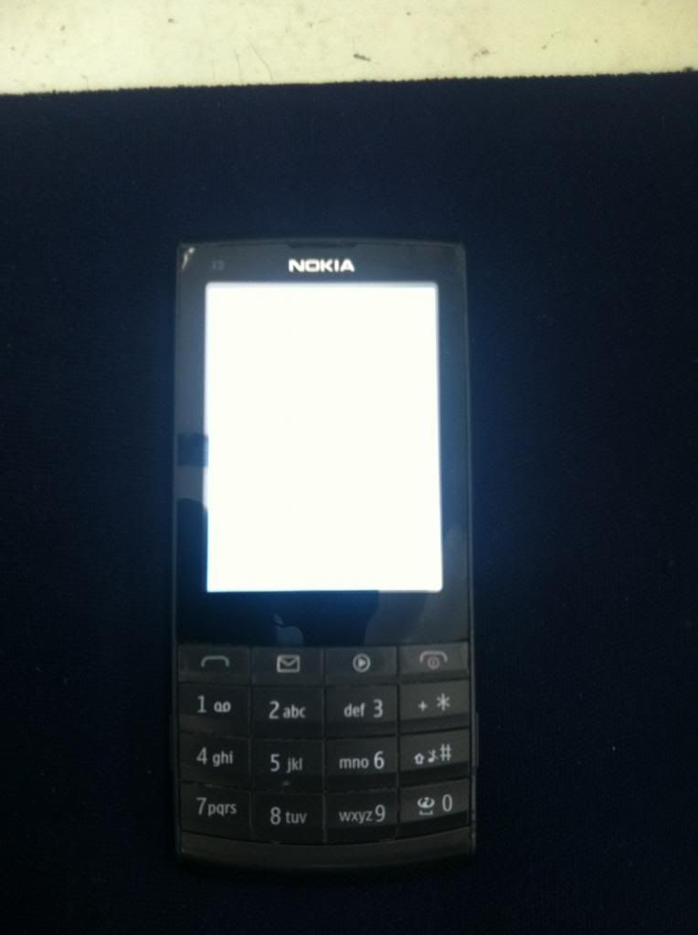

NOKIA x3-02 WHITE SCREEN BLINKING ONLY

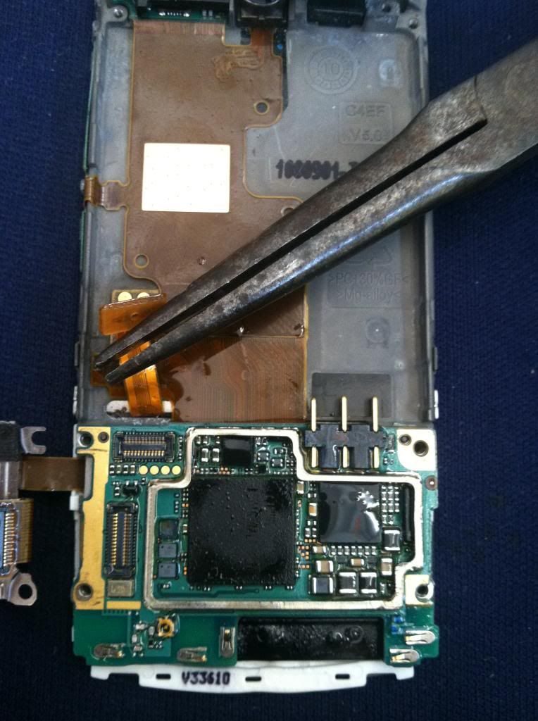

USE TESTER (SHORTED IT MEANS HARDWARE PROBLEM)

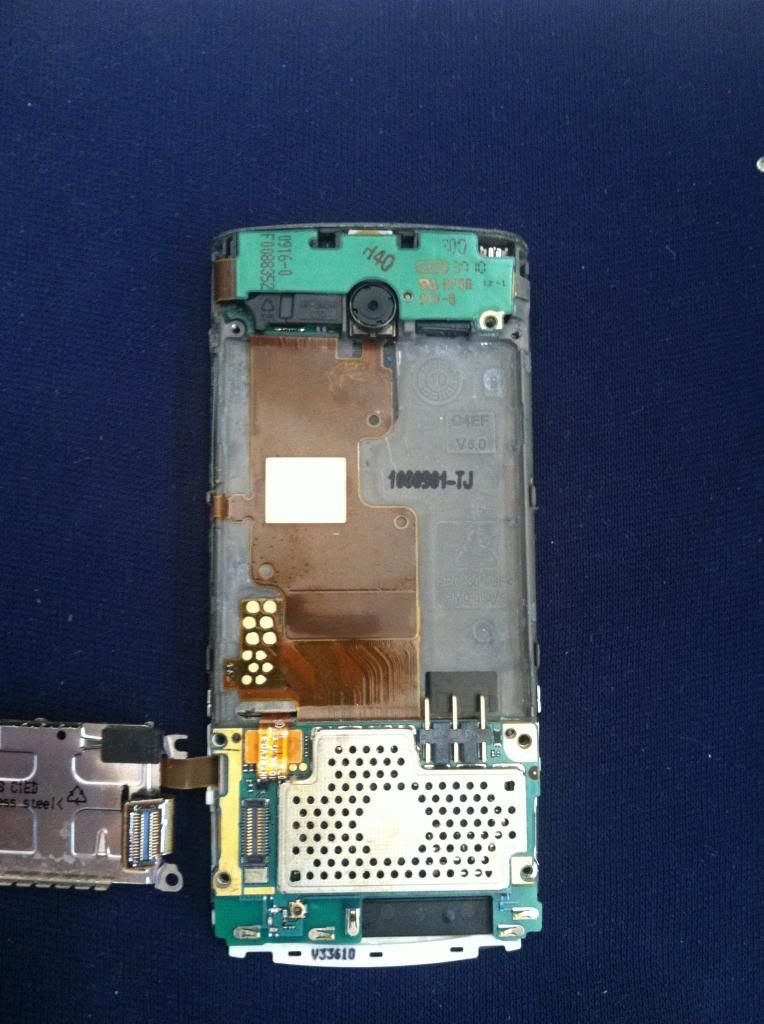

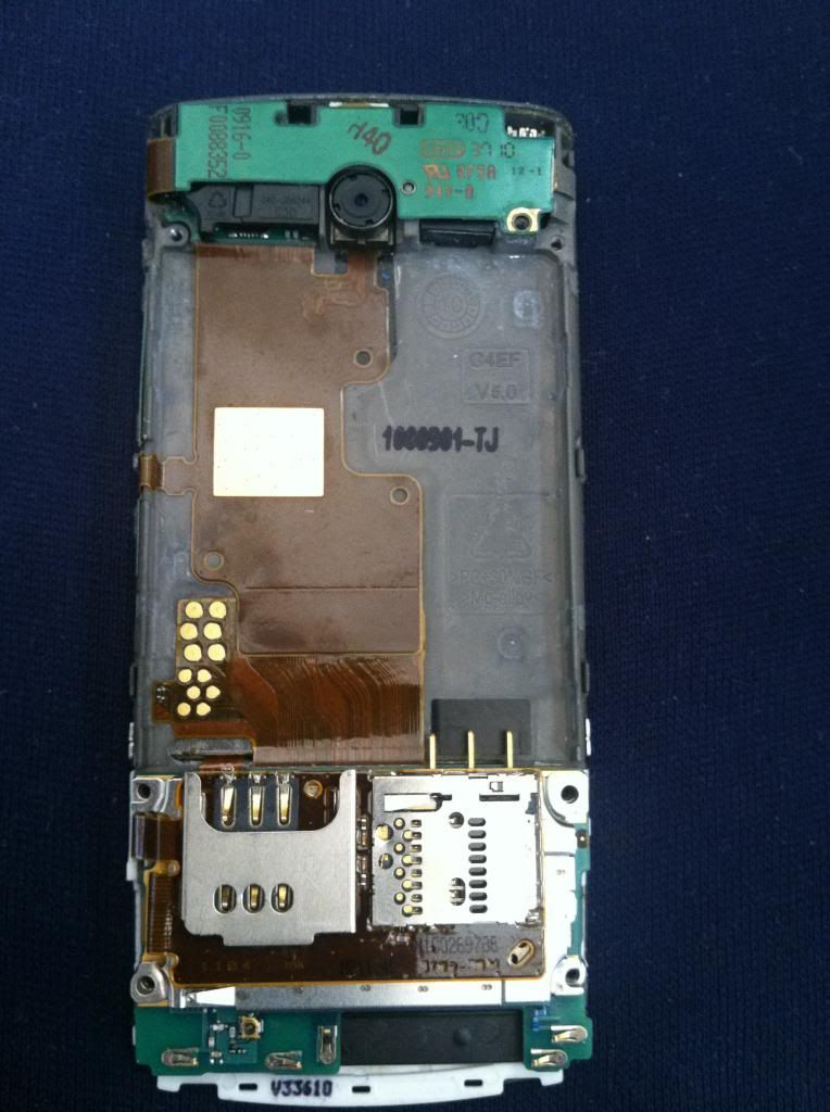

1.DISASSEMBLE THE UNIT
2.DISCONNECT ALL FLEX (BE CAREFULL)
3.REMOVE METAL PLATE

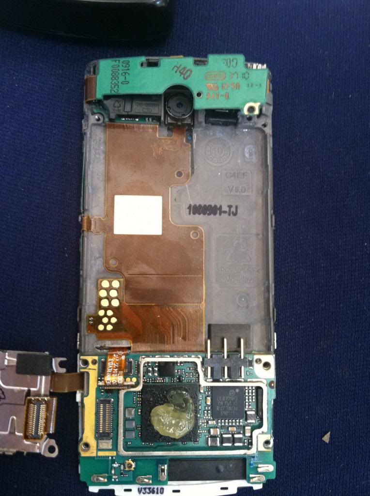

4.REHEAT COMBO IC ( BE CAREFULL )

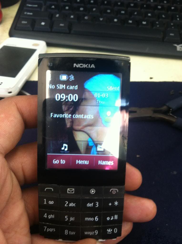

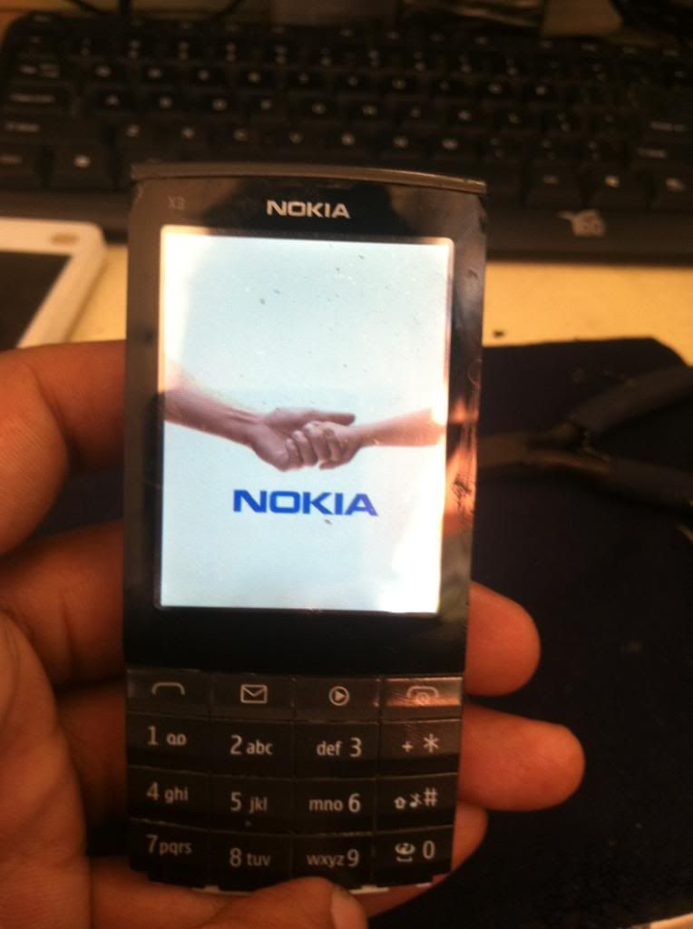

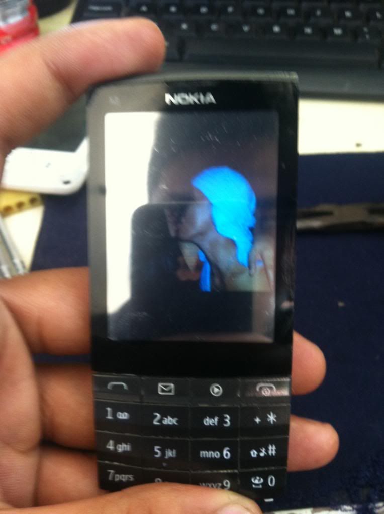

AFTER THIS PROCEDURE PALAMIGIN MUNA WITHIN 5 MINUTES

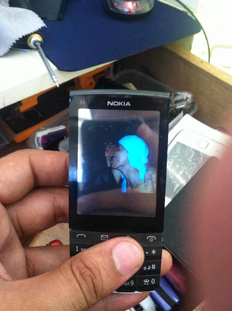

TESTING TIME

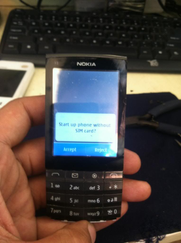

NAKITA NI MAM NA NAGDISPLAY NA NAGULAT AKO PILIT NYA KINUKUHA SAKEN KAHIT DI PA NATETESTING LAHAT
