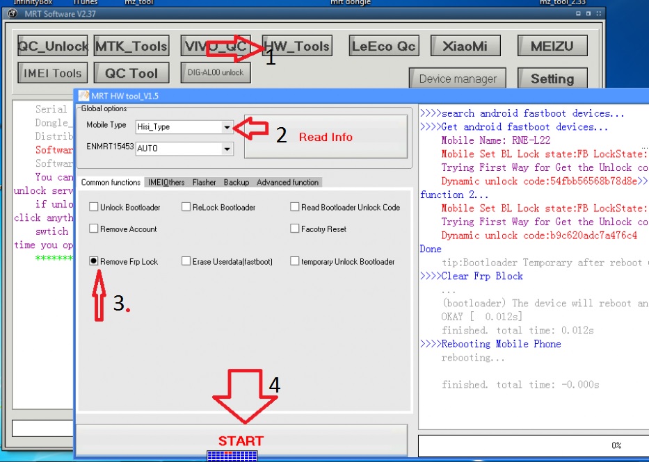

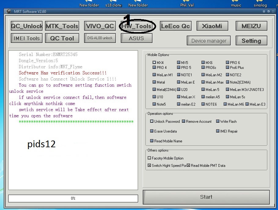

nova 2i frp problem solve via mrt dongle
procedure
open mrt dongle and click tab HW_TOOL
procedure nman para mapalabas c fast boot
at sa ganun ay mabasa ni mrt ang unit
pres volume down at power switch para lumabas
ang fastboot.
tignan at sundan nlang po ang image
https://i.postimg.cc/kMQyKfK1/11.jpg
https://i.postimg.cc/h4ZV96h0/22.jpg
https://i.postimg.cc/43XKCQmd/n.jpg
https://i.postimg.cc/XYkfyJ5r/55.jpg
sana makatulong
