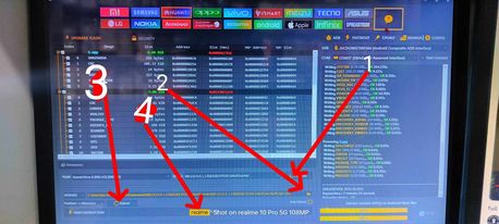

nova 3i dima wipe data kasi replace lcd di ma pindot yung yes
1-download firmware identify mo nalang model ng unit mo via fastboot then quick info huawei mo nalang
2-extract mo then load firmware
3-fastboot mo then click fastboot>erecovery pag pasok sa erecovery
4-hit flash
then wait mo mag boot
ito link para 2 3 4 lang step na gagawin mo

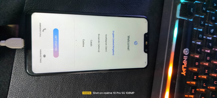

finished product hehe
4-hit flash
