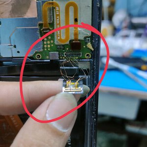

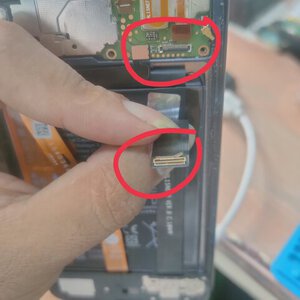

well09 Registered Joined Jun 1, 2015 Messages 132 Reaction score 165 Points 101 Location Obando, Bulacan Jul 19, 2022 #1 Issue na agad nabagsak Po Ang unit. . No sounds ,mic and, charging Tracing Muna before palit Ng kung ano ano pyesa. . . Sya Ang salarin Let's proceed to jumper in the ground Wala pyesa pamalit eh. Eto ka ngayun. . Sorry Wala na finish product . .
