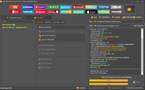

NOVA 8i NEN-L22 huawei ID
open unit make edl mode (test point ) nasa picture
open unlocktool
select huawei at exact unit
kailangan naka connect battery
erase huawie ID
wait until done
at un nga pgkatapos nayan auto restarting unit at pupunta sa irecovery, wag kahaban goto next procedure
second procedure
1.make testpoint ulit at select erase huawie id at may lalabas na note na huawei ID erase at REPAIR DATA.
2.select mo REPAIR DATA wait until done.. at mg rerestarting pupunta ulit sa recovery then WIPE DATA MO MANUAL.. DONE NA SETUP MUNA KUNIN ANG REWARD NI TUMER.. HIT LIKE LNG MGA KA ANTS NEWBIE LNG.. GODBLESS20220722_102658.jpg20220722_103611.jpg2.PNG3.PNGCapture.PNG20220722_111119.jpg
