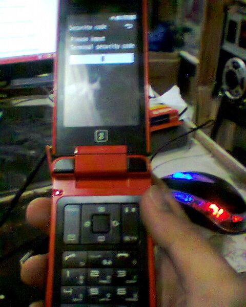

SHARE KO DIN NTT L-06A UNLOCK DONE MAY NALIGAW DIN.
PROCEDURE:1. Disconnect phone from cable
2. Type on phone keyboard 3845#*06#
3. Go to "Port Settings" select "QCT mode"
4. Go to "Port Settings" select "Diag Setting"
and select "USB Set for Diag"
5. Connect Phone to Cable
DRIVER:http://www.4shared.com/rar/jpmpZS87ce/NTT_L06AFOMA__faberdrive56yaho.html
TOOLS: Z3X LG ACTIVATED
CABLE:730S USB CABLE.
UNLOCK DONE NA.:D
