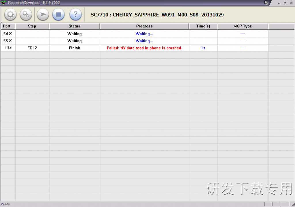

Error NV Incountered while Flashing Pac File?
hiramin ko muna screenshot na ito,credits to boss Joshwyl
Sulution Here.
Open ResearchDownload (Pac Flasher)
Click Backup Tab
Uncheck Data All Parts then click OK
Do Flash Again with Smile
DOWNLOAD RESEARCHDOWNLOAD HERE
