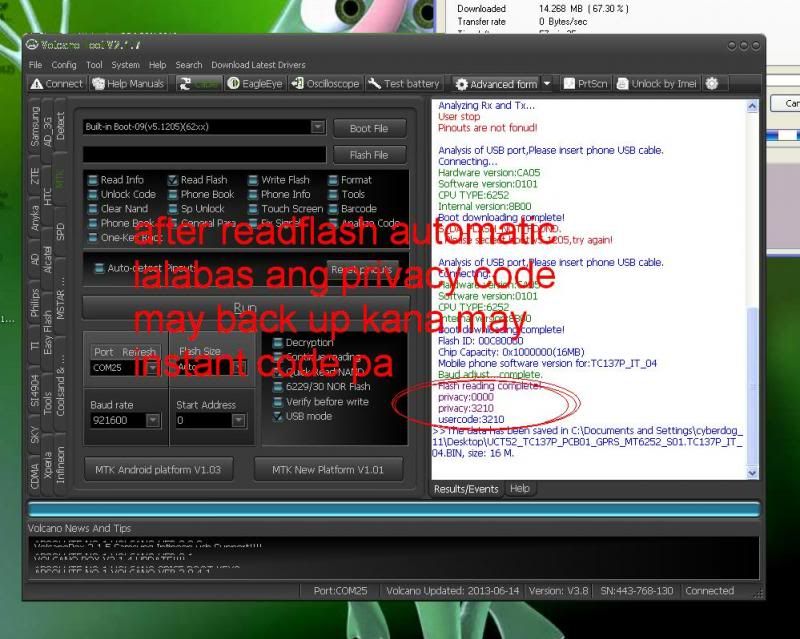

Readflash lang thru usb cable after read back up viola instant code na

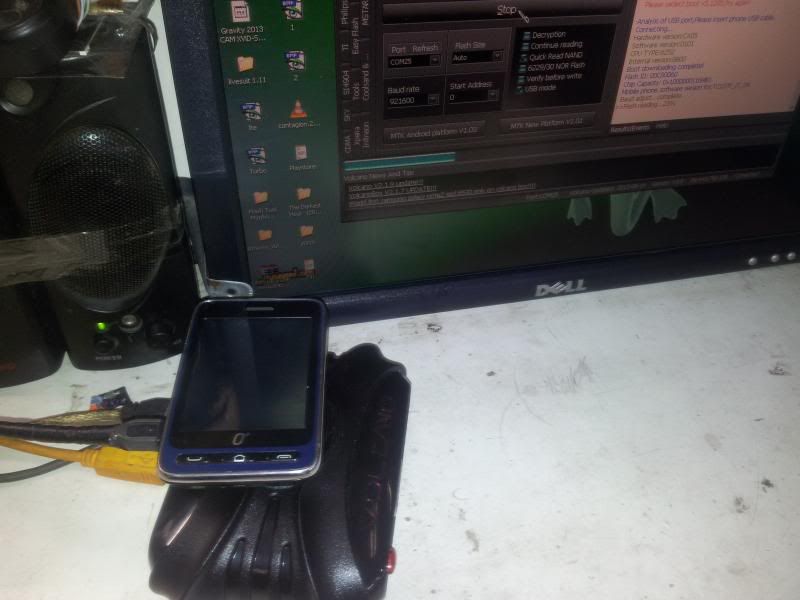

Tools:
Volcano box
Usb cable (5310)

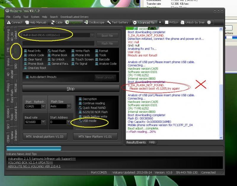

Open volcano v2.1.7
Tick Mtk tab
Select built in boot 09(v5.1205)(6252)
check readflash
check usb mode
Run

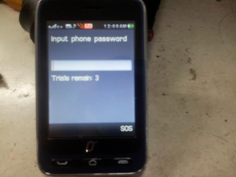

insert usb press volume up
After back up, privacy and usercode will appear
enter manually
Screenshot:

ayaw sya tumuloy sa built in boot 09(v5.1205)(6252)
d2 sya tumuloy boss thanks po
