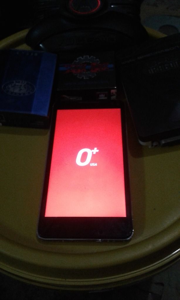

Mga boss share ko lang gawa ko, feedback na rin sa firmware ni master.
Problem: hang on logo.

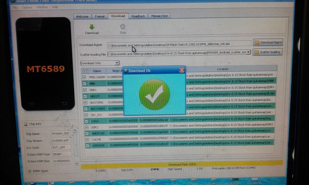

Needed:
1. Firmware http://antgsm.com/showthread.php?t=83551
Credits to the owner kaya pm na lang siya sa pass.
2. Sp Flashtool.
3. USB micro data cable.
4. Computer with mtk drivers installed.
Procedure:
1. Extract firmware.
2. Open Sp flashtool and Insert the emmc file.
3. Download only and run.

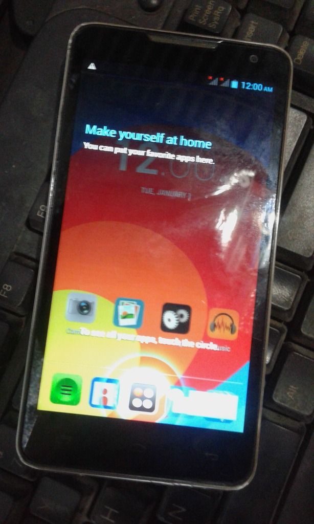

4. Done na. if hang pa rin hard reset mo lang.
