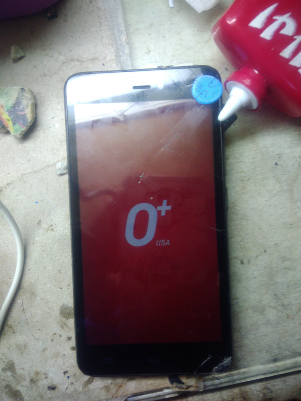

O+ 8.96 android hang logo done with tested firmware via CM2

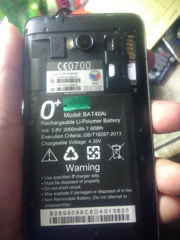

Magandang umaga po. O+ 8.96 android hang logo lang po ito hanap ako ng firmware ayun naka hanap ako ito po yun

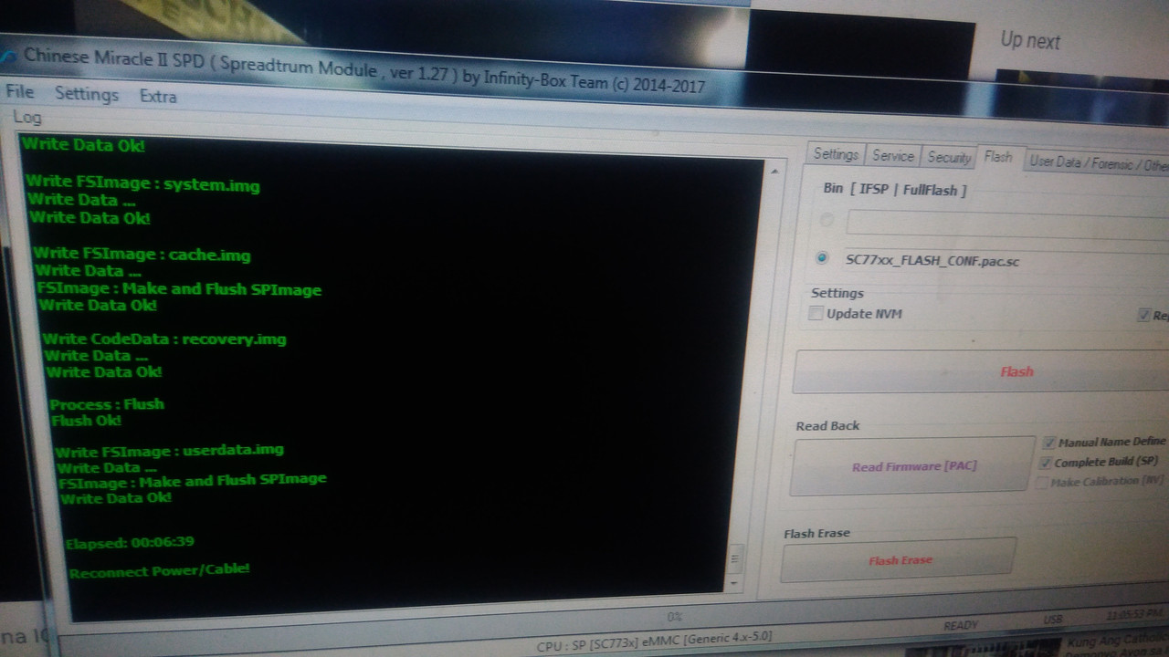

download this one:
O+ 8.96 android back up by: LOTERO
password:
antgsm
kapag na tapos napo mag download extract the firmware copy the whole file and paste to this
open cm2 (infinity doongle) choose spd
PAKI SUNDAN:
find the firmware you copy and select "SC77xx_FLASH_CONF.pac.sc"
PROCEDURE:
baklas battery
insert usb cable
insert battery
wait

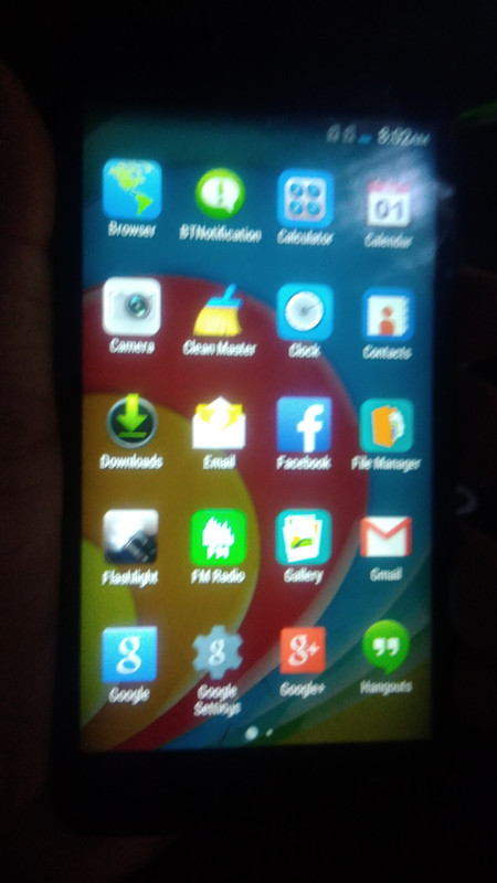

all done.

maraming salamat boss sa yong pagsher ng yong kabaitan ng dahil sa files mo solve problem ko montik kona eh RTO butinalang najan ka hehehe salamat boss_sa cm 2ko pala isinalang at swak nMn ----)))>>> - Gsm_Badz

Tested by me
