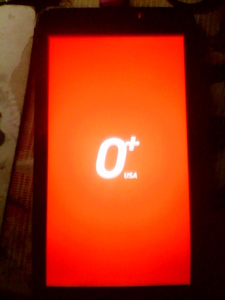

O+ FAB GO hang on logo done for reference

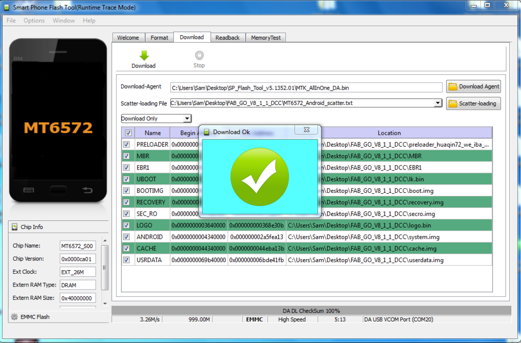

firmware here
http://www.4shared.com/get/snESSduHce/O_FAB_GO_V8_1_1_DCC.html
screen shot
ito sya nung nakahang history over download ayun tulaley
flashing using (SP Flash Tool v5.1343.1)
extrct firmware wla po password yan
load firmware
hold volume up then connect usb cable
done
for reference thanks for viewing
