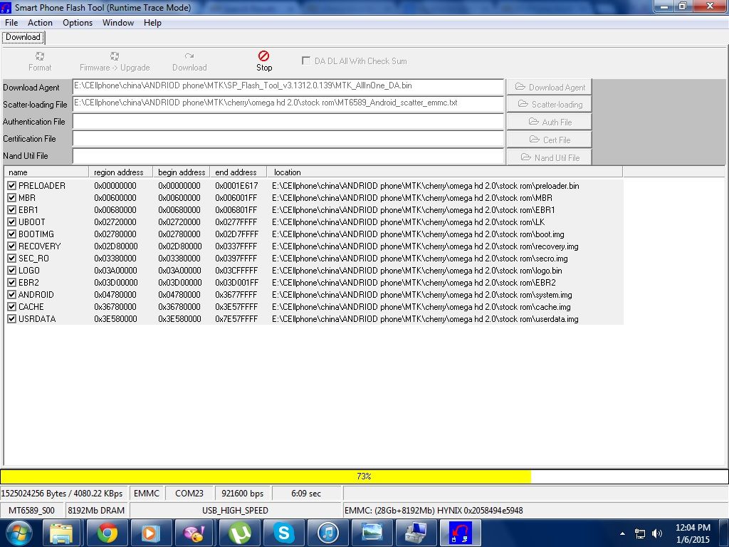

onwload this file cherry mobile omega hd 2.0 stock rom and extract it with winrar5
http://www.mediafire.com/download/izbi5dm9hmn262i/CherryMobile_OmegaHD-2.0-StockRom_v49.rar
flash it with ...hanap nalang sa google
SP_Flash_Tool_v3.1312.0.139

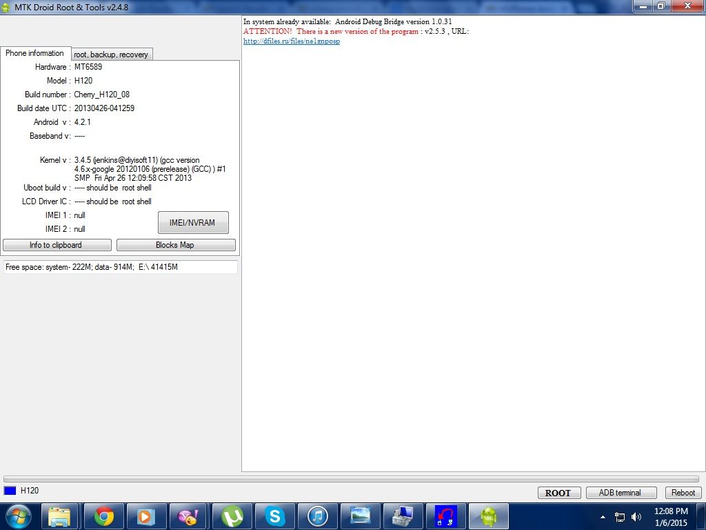

pagkatapos ma flash...invalid yung imei at unknown ang baseband..punta tayo sa repair imei..i try sigma ,volcano at ibat ibang imei repair tools kasu fialed...
Download MtkDroidTools 2.4.8

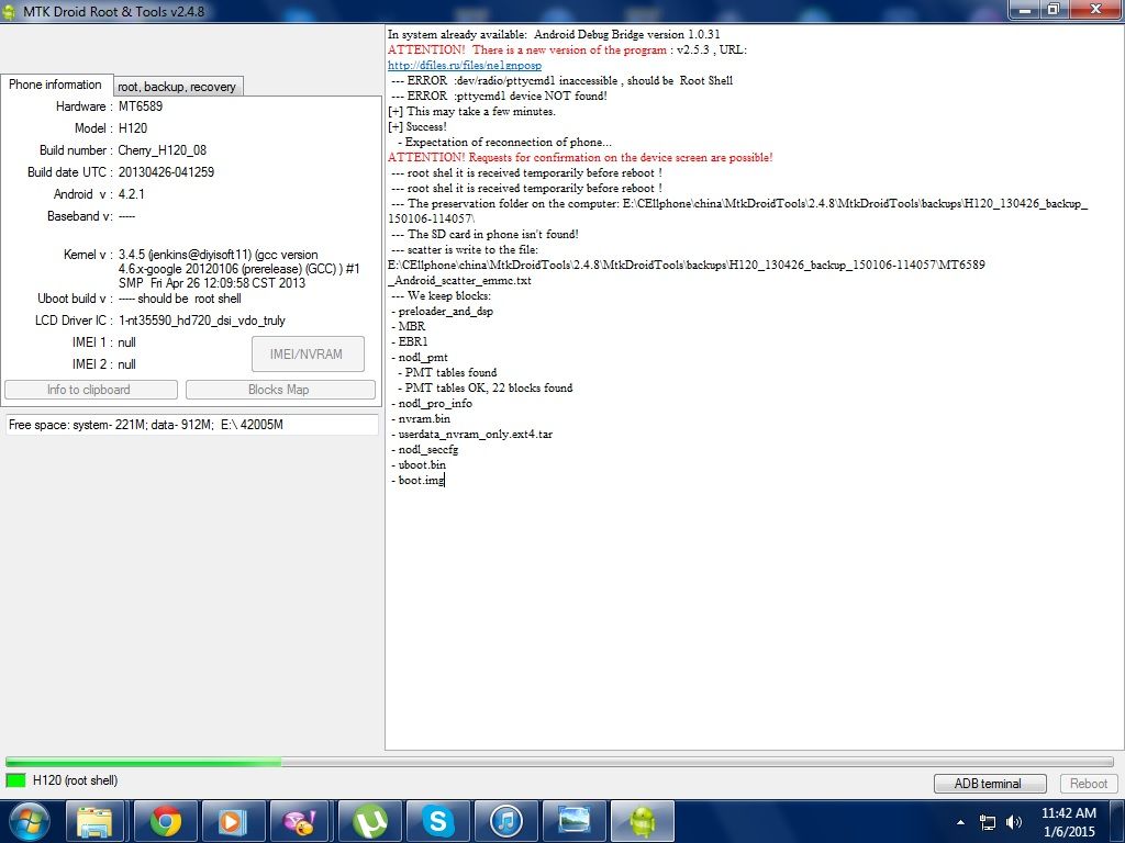

pagkatapos mong ma fash ay naka auto on ang debug,kaya detect agad yan sa mtkdroidtool
pindutin ang root sa bandang ibaba..maraming lalabas na pop-up...no lang lahat
after ma root..

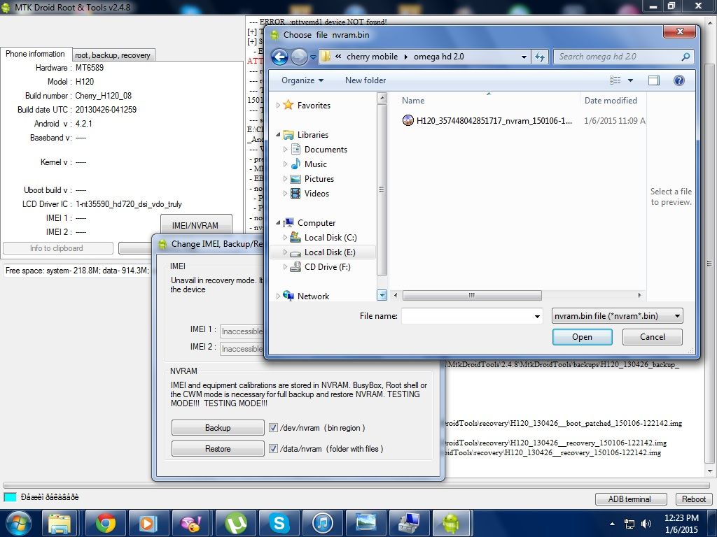

imei/nvram
restore
http://www.4shared.com/file/zZkFRF0Rce/H120_357448042851717_nvram_150.html?
http://www.4shared.com/file/GBnZwCP2ba/H120_357448042851717_nvram_150.html?

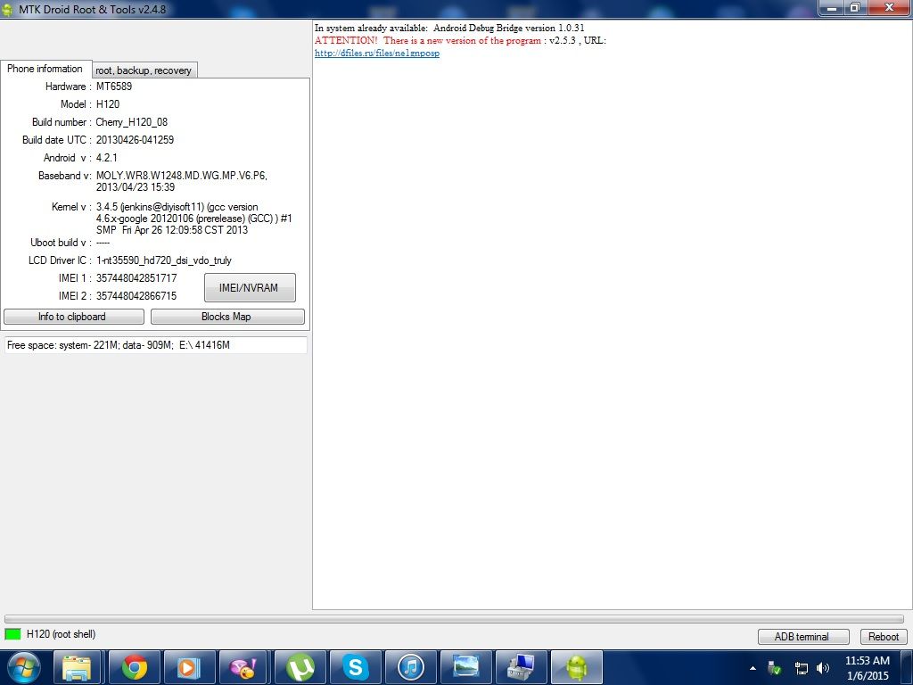

done done....sana makatulong ..wala screenshoot yung Cellphone...sorry...
