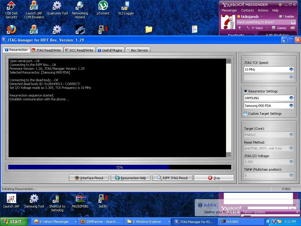

Samsung OMNIA I900 deadboot po sya..

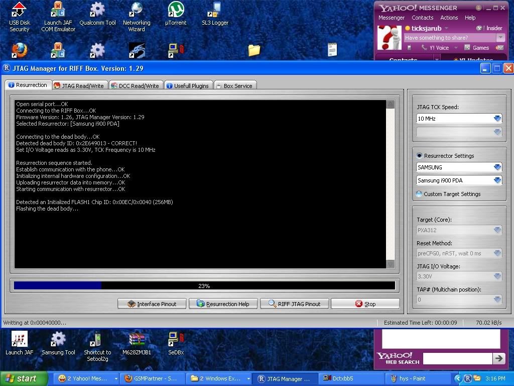

eto po ang mga pangyayaring naganap Ni I900 bali deadboot napo sya ng dinala sakin..
so open case po natin kasi po deadboot yung kaso.. at ni Jtag po ang model at para po ma inbestigahan at ma desisyunan ni paring RIFF...
at eto po ang naganap na inbestigasyun..
Open serial port...OK
Connecting to the RIFF Box...OK
Firmware Version: 1.26, JTAG Manager Version: 1.29
Selected Resurrector: [Samsung i900 PDA]
Connecting to the dead body...OK
Detected dead body ID: 0x2E649013 - CORRECT!
Set I/O Voltage reads as 3.30V, TCK Frequency is 10 MHz

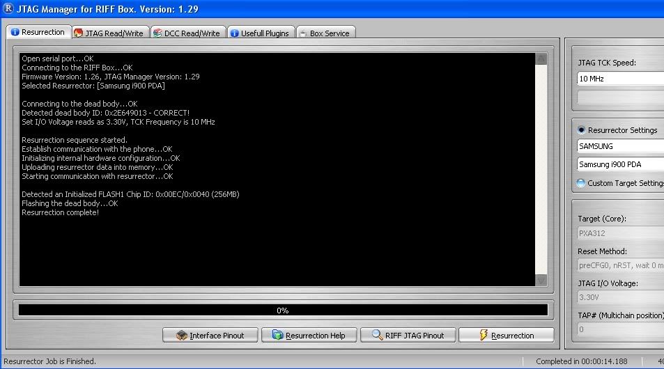

Resurrection sequence started.
Establish communication with the phone...OK
Initializing internal hardware configuration...OK
Uploading resurrector data into memory...OK
Starting communication with resurrector...OK
Detected an Initialized FLASH1 Chip ID: 0x00EC/0x0040 (256MB)
Flashing the dead body...OK
Resurrection complete!

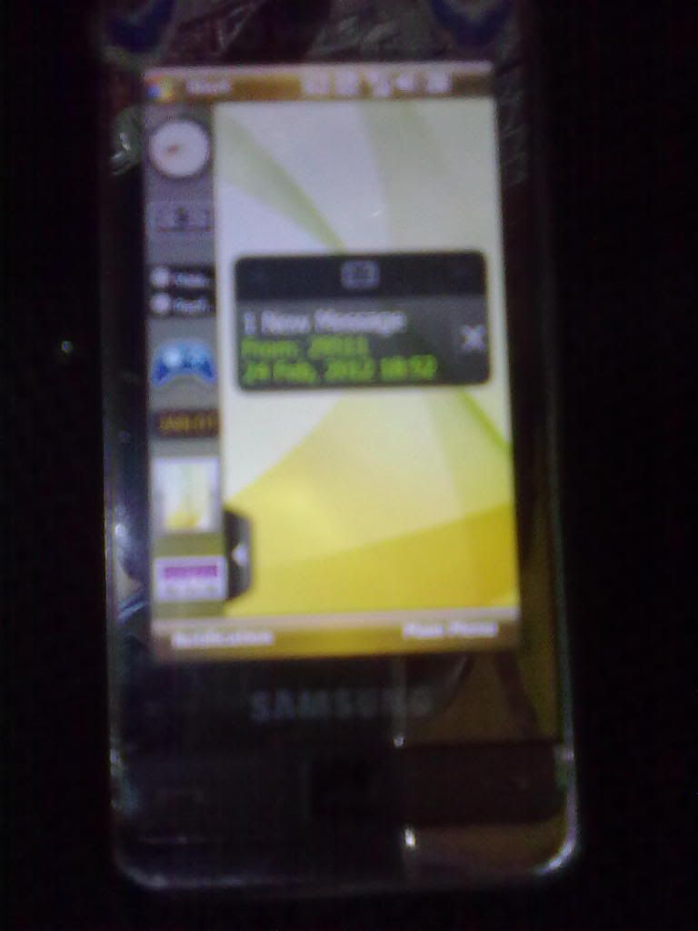

Done..succesful po ang naganap na inbestigasyun,,.. buhay napo uli si I900..

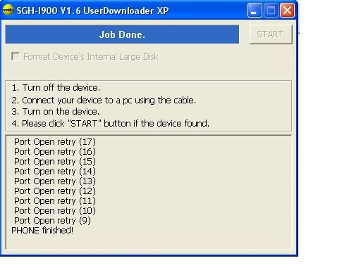

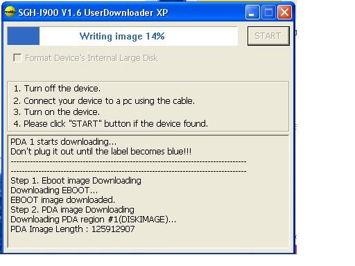

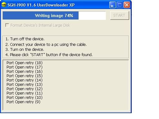

kaso medyu may pag alinlangan papo si I900 nag hang-up nlang po hangang Logo lang..
so salang uli si I900 at hinusgahan uli ng User DownloaderXP V1.6 ...
at eto naman po ang mga pangyayare.
Done napo..
