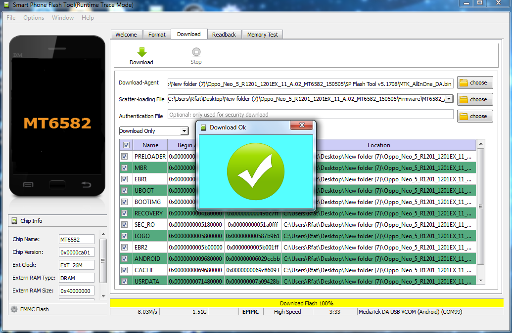

Share ko lang OPPO 1201 HANG LOGO Start.....
1st STEP TRY ko sa hardreset SUCCESS naman pero hang logo parin..dahil dito may Chance pa ang UNIT mabuo.
2nd STEP TRY ko iflash to SD Card no Lock...
3rd STEP flash sa SPT DL lang firmware and flash..

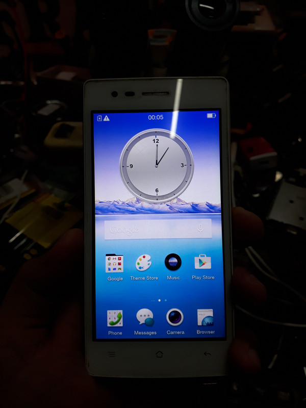

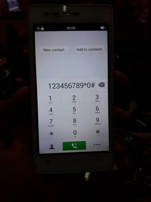

DONE!!
http://www.mediafire.com/file/tvnja6m8s7dfxin/MT6582_OPPO_1201_1201EX_11_150709_20160331_205037.rar
