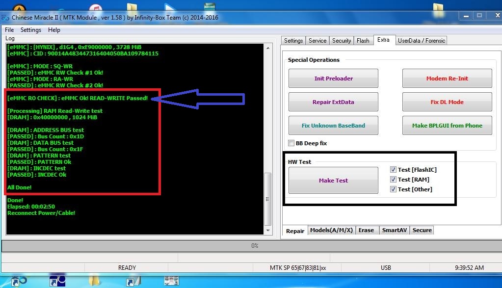

Oppo pina safety way remedy
kausap muna si tumer na 50/50 tong unit nya
sabi nya ok lang daw mamatay bili siya bago
edi waw flash na tayo
salamat kay sir @Fredzyrhuz sa tested na fw nya --> oppo a11w mt6582 cm2bckup by Fredzyrhuz.rar
Steps:
DL fw
Load to spft ver 5.15
Check Only Userdata and Android
Click Download
Ito po imahe:
Success po saka ok yung imei nya
sana po maka tulong sa kagaya kong baguhan
