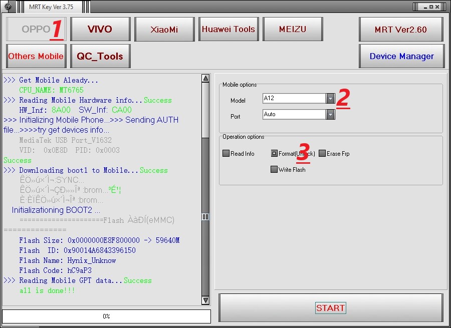

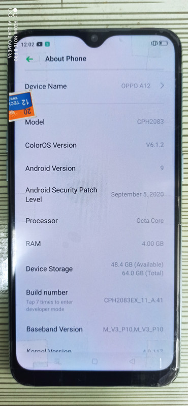

for reference lang mga boss
Oppo A12 cph2083 remove password done kay MRT
power off muna yung unit
open MRT 3.75 (or newer versions
select oppo
select correct model (A12)
Tick format unlock (check)
click start
boot key vol. up and volume down
insert usb to cp
Done
