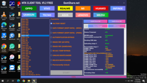

ETO MGA KA BUDDY SANA MAKATULONG SA INYO, FIRST TIME KO GINAWA TO KAYA NA EXCITE AKO
KUNG MAG SUSUCCESS BA VIA CRACK SI OPPO A15..
1ST: DOWNLOAD NYO MUNA SI MTK CLIENT TOOL
LINK: https://download1073.mediafire.com/6j9mj1y0qd1g/cqpc379rgvvbyvn/MTK_CLIENT_TOOL_V5.2+(2).rar
2ND : TAPOS INSTALL NYO DRIVER NG MTK CLIENT TOOL NASA GILID MAY MTK DIVERS CLICK NYO LANG SA MTK CLIENT TOOL
OR DONWLOAD NYO LANG ITO MANUAL MTK DRIVER, DAPAT NAKA OFF ANTIVIRUS NYO.
DOWNLOAD driver LINK: https://androidfilehost.com/?fid=13...FcX1lLpUKpktql69SrMbLXG1AhPfsS4RAOOOZ6PVNd_-4
THEN, DISABLE NYO MUNA DRIVER SIGNATURE SA PC NYO BY PRESSING HOLD SHIFT KEY AND CLICK RESTART
AFTER MAG RESTART MAY LALABAS NA TROUBLESHOOTING
FOLLOW PROCEDURE : https://www.youtube.com/watch?app=desktop&v=71YAIw7_-kg
3RD: AFTER NATAPOS NYO YANG TATLO, EXTRACT NYO NA MTK CLIENT TOOL THE OPEN NYO NA AGAD.
4TH: INSTAL DRIVERS dapat naka turn off yung antivirus
5th: CLICK MO OPPO, THEN SELECT MODEL OPPO A15 THEN SELECT FACTORY RESET..
6TH: KAILANGAN NAKA OFF ANG CP NYO, TAPOS HOLD VOL+ AND VOL-, THEN CLICK START, INSERT CABLE WYL HOLDING VOL+/-
7TH: PAG NAG DETECT NA YONG CP SA MTK CLIENT TOOL, RELEASE BOTH VOLUME ,
HINTAYIN LAMAN MATAPOS SA FORMATTING DATA - OK
8TH: PAG TAPOS NA, REMOVE CABLE ,THEN PRESS HOLD VOLUME + THEN PRESS POWER KEY PARA MAG RESTART.
9: TURNOFF NYO NA TAPOS PASOK SA RECOVERY MODE BY PRESSING VOL DOWN AND POWER KEY
WIPE DATA, ENTER VERIFICATION CODE. THEN REBOOT.
10TH: FOR FRP PRESS EMERGENCY CALL ANG DIAL TIS *813# or *#813#*
TAPOS NG TRABAHO .
