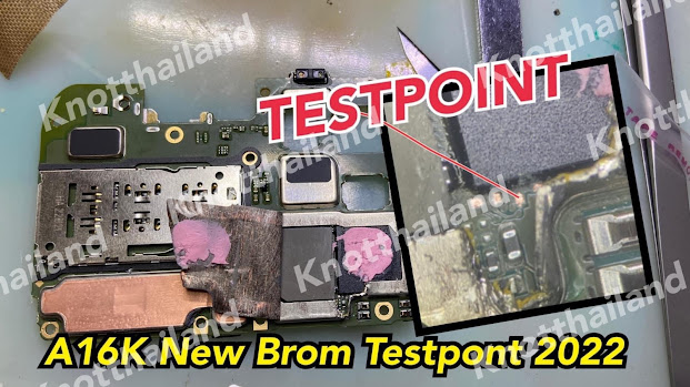

Oppo a16k frp lock testpoint
Na try q na rin bypass ayaw ma erase data..
Na try q na rin sa meta Erase FRP unlock tool jumping brom lang..
kaya ginawa q testpoint nalng
1st baklas unit connect testpoint para maditect ang unit

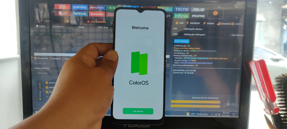

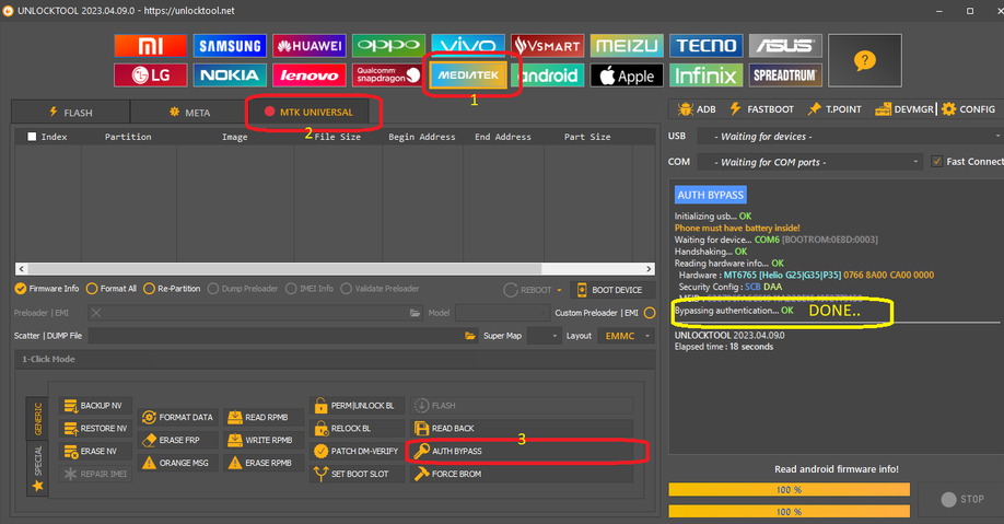

2nd Open Unlock Tool
click mediatek/universal MTK/AUTHBYPASS
connect testpoint
Done..;)
.View attachment 21673
connect testpoint
View attachment 21676View attachment 21677
Done..;)
slmt sir..tested sya sa cm2 testpoint /di kc ngna sa hydra.
