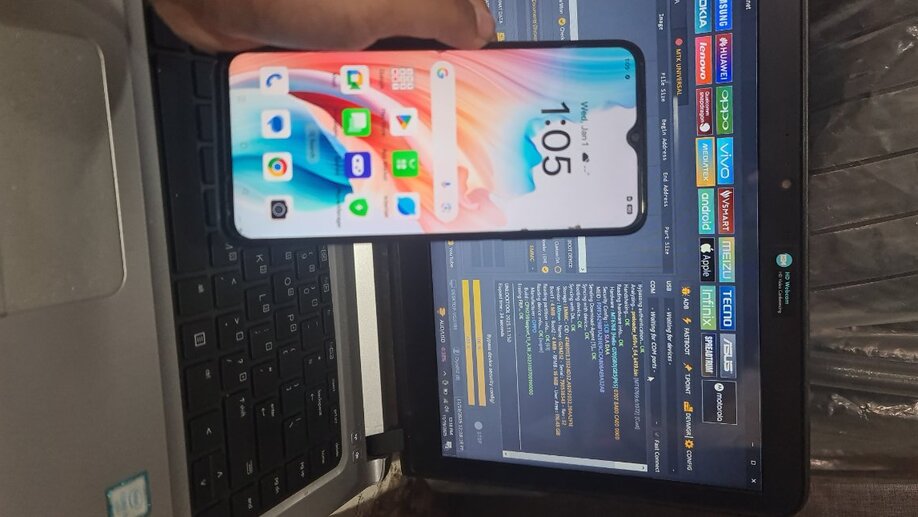

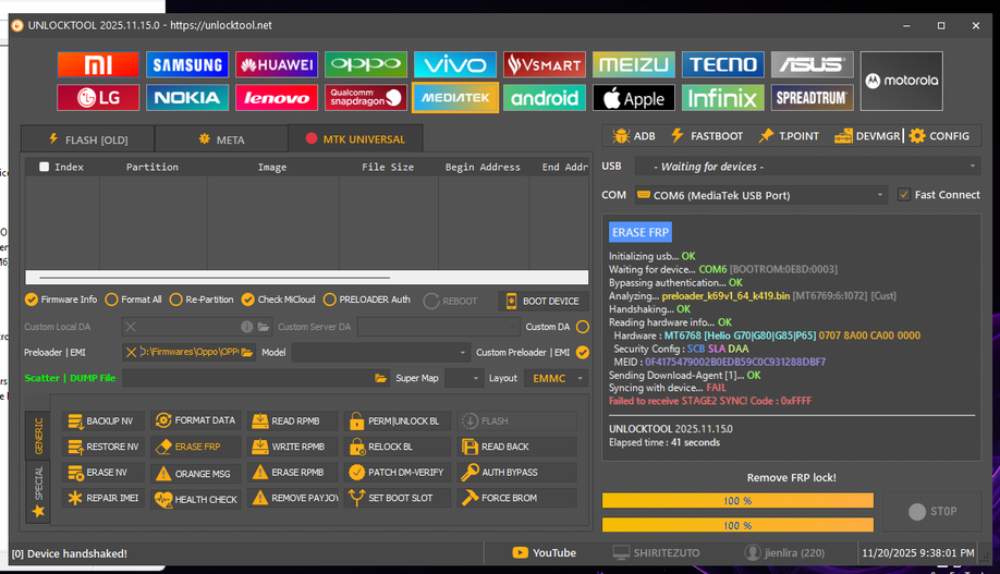

REFERENCE Oppo A18 frp bypass andriod 15 via testpoint on UT
oyo01
Jan 20, 2019
220
282
51
Dagami Leyte (Leyte Chapter)
open unlock tool
click mediatek(mtk universal)
click Custom Preloader [EMI
insert Preloader[EMI file bin
click Erase Frp and connect via testpoint
ito ginamit kung preloader file bin
https://www.mediafire.com/file/vfqh...om]+Oppo+A18+CPH2591+Preloader+File+.rar/file
testpoint
Anatayin hangang matapos

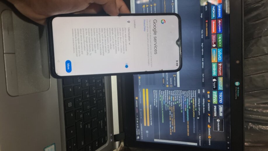

success full
sana makatulong

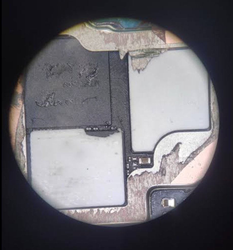

connect lang ba sa groun yan master

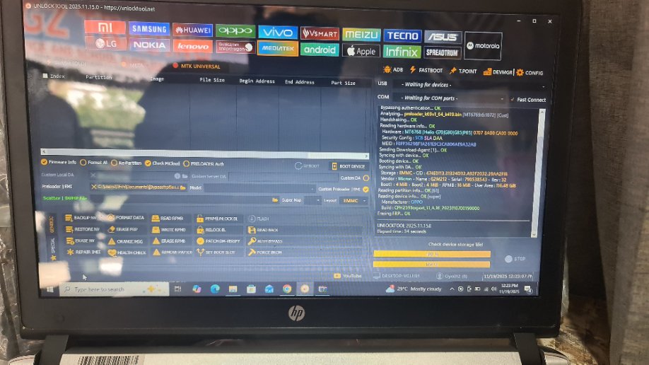

open unlock tool
https://www.mediafire.com/file/vfqhtje87zh74xj/[Bypassfrpfiles.com]+Oppo+A18+CPH2591+Preloader+File+.rar/file

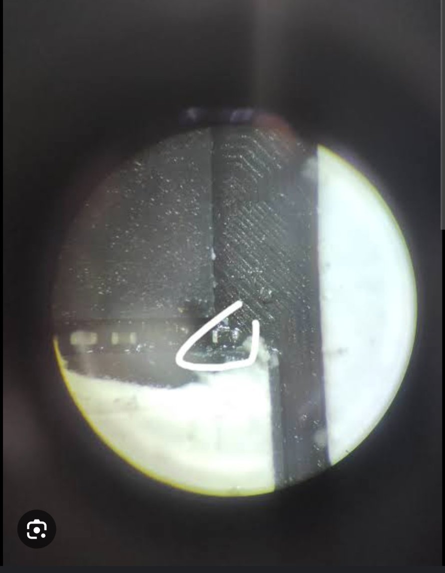

testpoint
success full
sana makatulong
connect lang po ba sa ground master
or hinang sa gnd

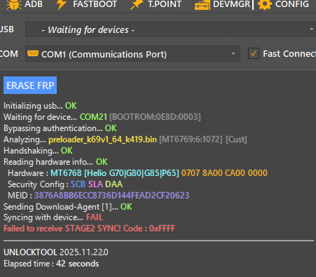

Sa akin mga master always na syang detected kahit di naka connect tweazer ko pano to change resistor napo ba ako?
