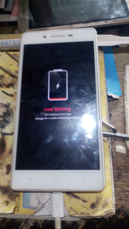

1ST TRY KO POWER AYAW PO
2ND TRY KO CHARGE LUMALABAS LANG PO LOW BATTERY
3RD TRY KO NEW BATTERY SAME LANG NO POWER LOW BATTERY ULIT

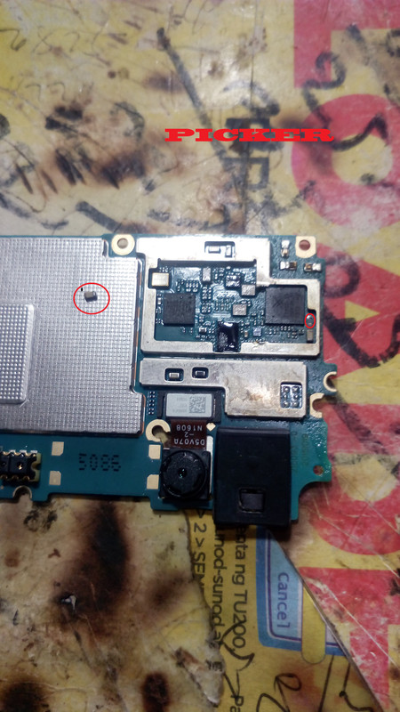

4TH KINALAS KO NA PO UNIT OH WATER DAMAGE PALA CHECK TERMINAL SHORTED
5TH HANAPIN SHORTED MABUTI NA LANG HINDI NAHIRAPAN HULI KA....
ITO PO YUNG SHORT PARTS
https://i.postimg.cc/Nfz1GQsd/IMG-20190702-134022.jpg
AFTER PO MATANGGAL CAPASITOR
https://i.postimg.cc/x1GMvMG4/IMG-20190702-171930.jpg
https://i.postimg.cc/9XvL1PTm/IMG-20190702-171823.jpg

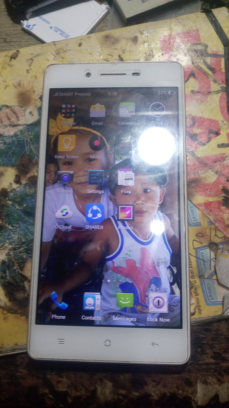

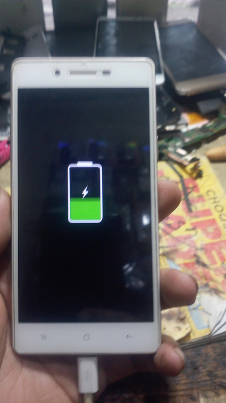

CHARGING AT MAY POWER NA PO SALAMAT....
