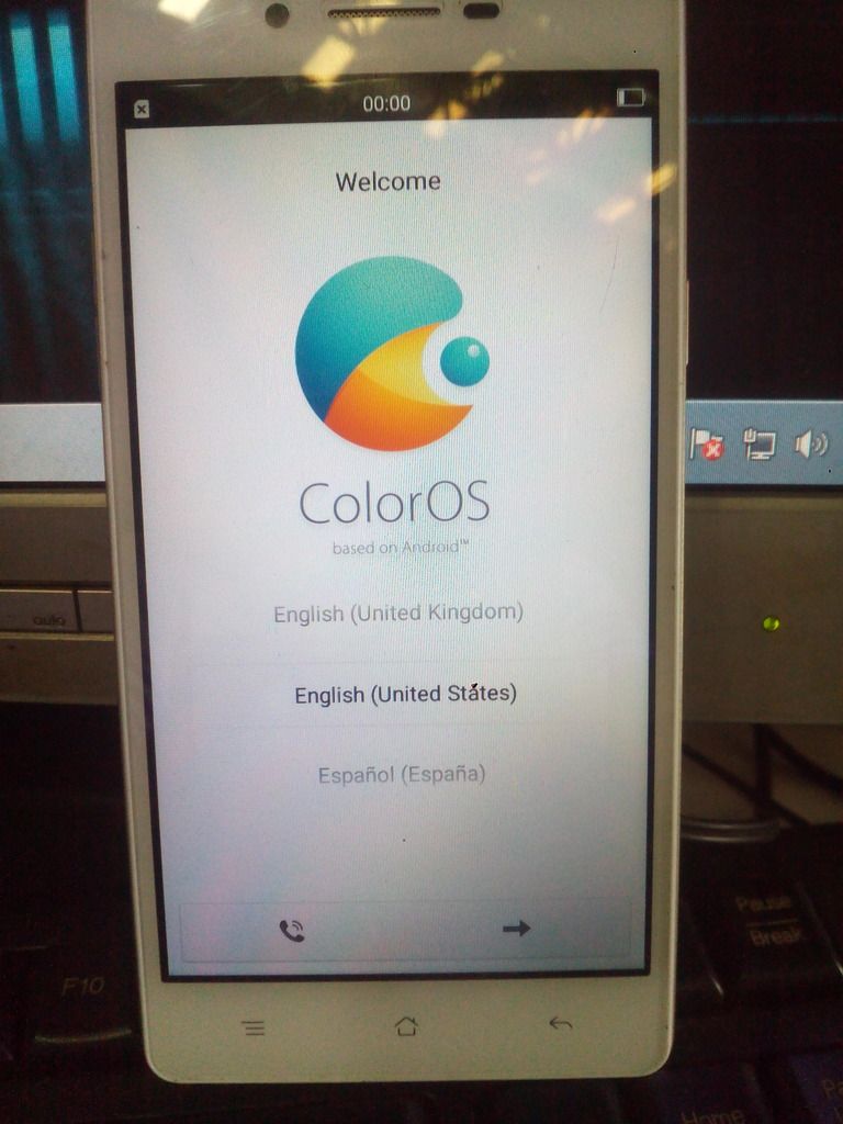

gud day po share ko lang OPPO A33W A.K.A OPPO NEO 7
stock on recovery only
history ng phone pina root daw ni cos2mer sa kaibigan nyang I.T
after nun nag hang ang unit nya so ginawa HARD RESET ni boy I.T
after reboot tulala sa recovery na lang
hindi ko na na kunan ng screenshots nung nasa recovery mode sya pasensya na
1st move DOWNLOAD nyo lang po itong BINFILE
medyo malaki laking file yan subra 2gb kasi yan pag na extract mga 7gb na
DOWNLOAD ME:
OPPO A33W A.K.A NEO 7 TESTED BINFILE
FLASH USING CM2
PROCEDURE:
OPEN CM2 SOFTWARE
LOAD BIB FILE
CLICK FLASH
PRESS VOLUME UP
CONNECT YOUR DIVICE TO PC
AT HINTAYING MATAPOS SA FLASHING
DONE.......

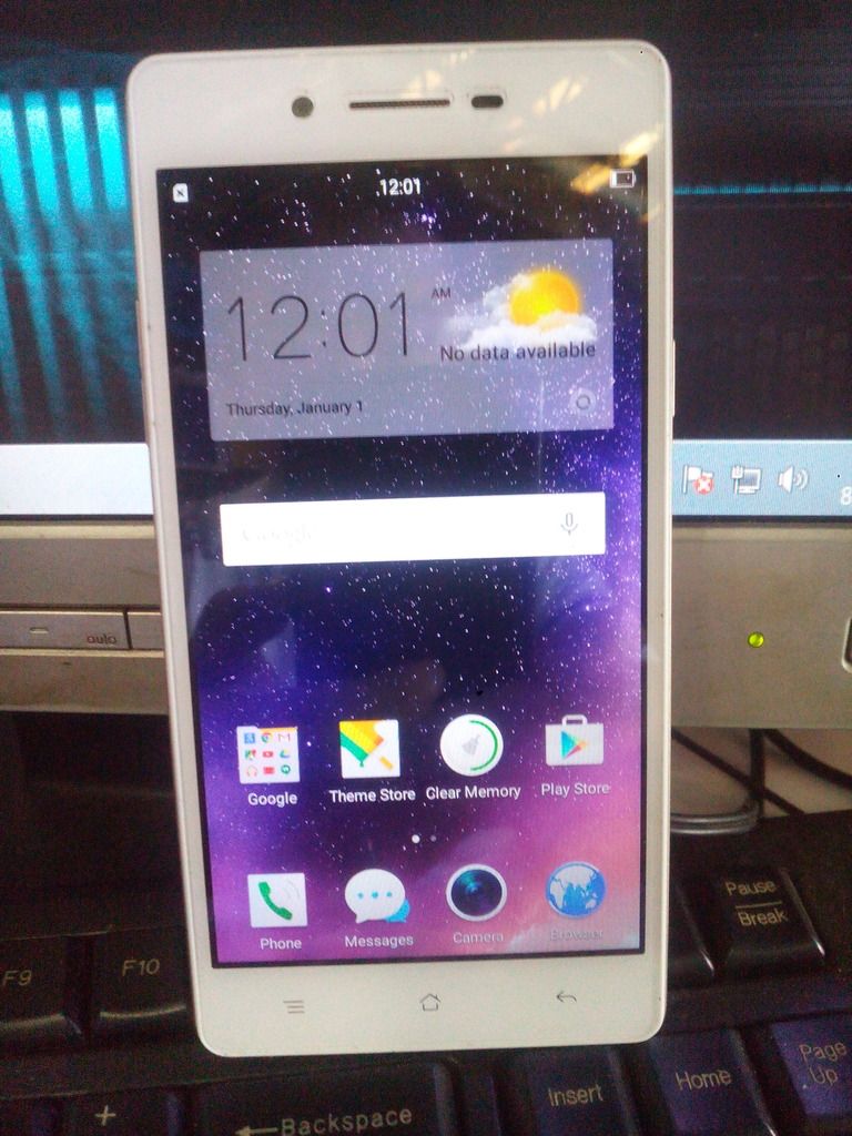

for firmware password pm nyo na lang ako​
(l:0
unit: oppo a33w
problem: when power on always recovery data wiping
action taken: flash via sptool [vnROM.net]_MTK6582_Oppo A33W
status: unit ok
salamat dito sa flash files... working and tested...
[/IMG]
thanks po ulit ng marami....
