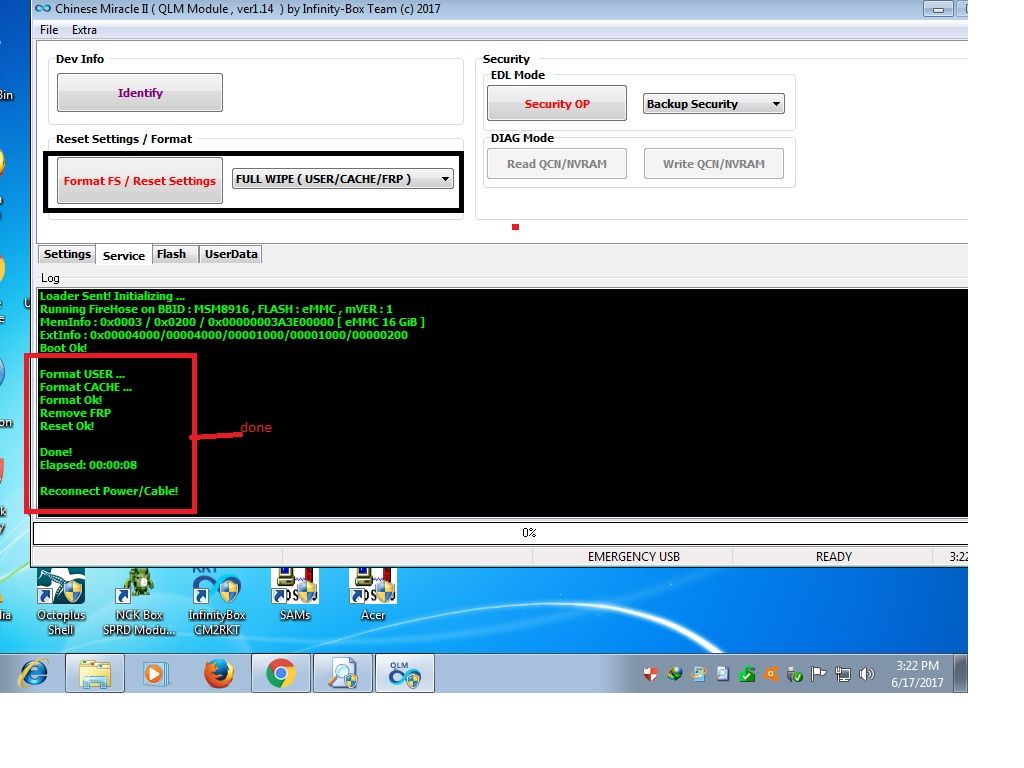

gud morning mga idol. and happy father's day to all father out there. shre ko lang itong short info. model oppo A37. problem. user code nakalimutan. hindi pattern ah. iab kasi yung pattern. kayang i-read. pero ang user code. hindi. first attemp. try ko muna. baka pwede yung read pattern. but no luck. hindi talaga parehas. wala rin syang hard reset. kaya try ko na lang kay cm2. buti na lang at nadali.
PROCEDURE:
-open si cm2.
-off the phone. then hold volume down and up. then insert to the pc.
-install the driver if needed.
-then click format FS/reset settings.
-then boom. pera na. ganun lang ka smooth.
screen shot ni cm2.

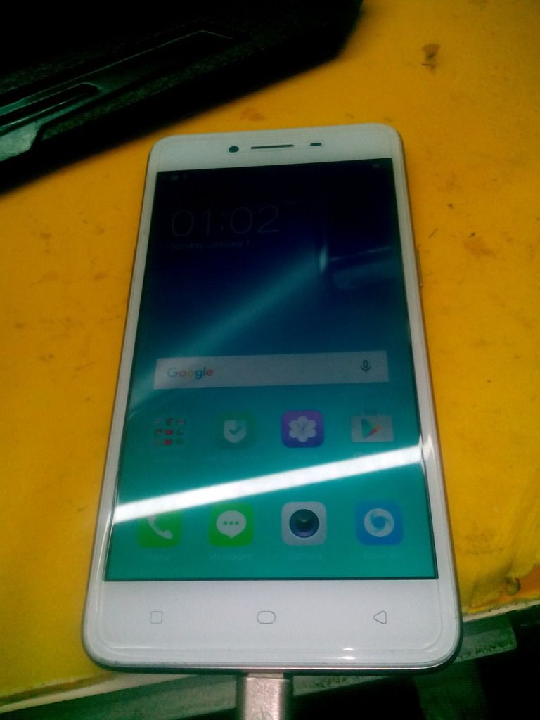

then finish product.
