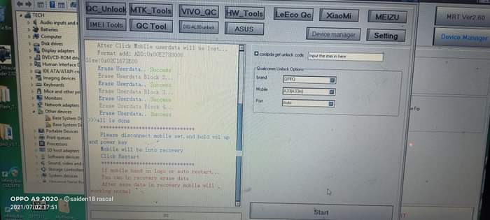

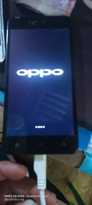

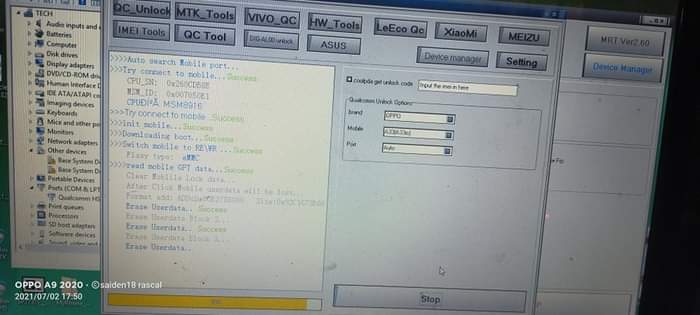

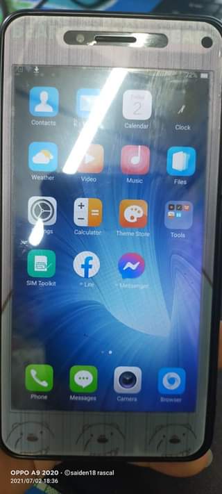

PROCEDURE
OPPO A37f PASSWRD REMOVE
MRT.3.75
OPIN MRT.3.75
CLICK/MRT.VERSION 2,60
CLICK/QC-UNLOCK
SELECT OPPO BRAND
SELECT MOBLE A33[A33M]
PORT AUTO
OFF PHONE
THEN HOLD VOLUME UP DOWN
PAG NADETECT NA SYA NG PC
CLICK START WAITING DONE

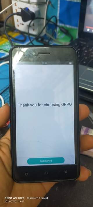

finish product
