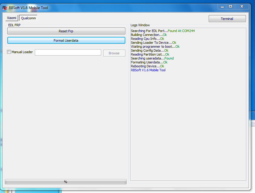

SCREEN SHOTS & PROCEDURE
run rb soft tool
turn off unit hold volume up and down
insert usb install driver
then tick format user data
wait mo lng mga 5 sec lang
ooppps meron frp

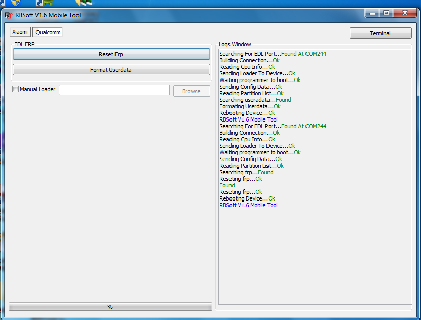

same procedure
turn off ulit
hold ulit volume up at down
insert usb then click reset frp naman
done
