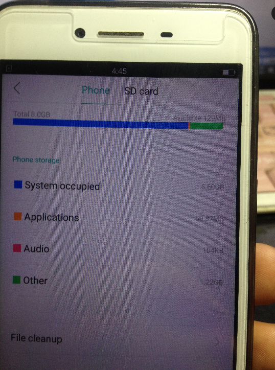

share lng mga ka ant,,history nito my pattern so format
after format ung 8gb na phone storage ay naging 129mb nlng
kahit ereset ko siya manual but still same ginawa na lahat manu manu sa pagbura
pero hindi umubra clear cache clear data wa effect kunti lng bawas nya

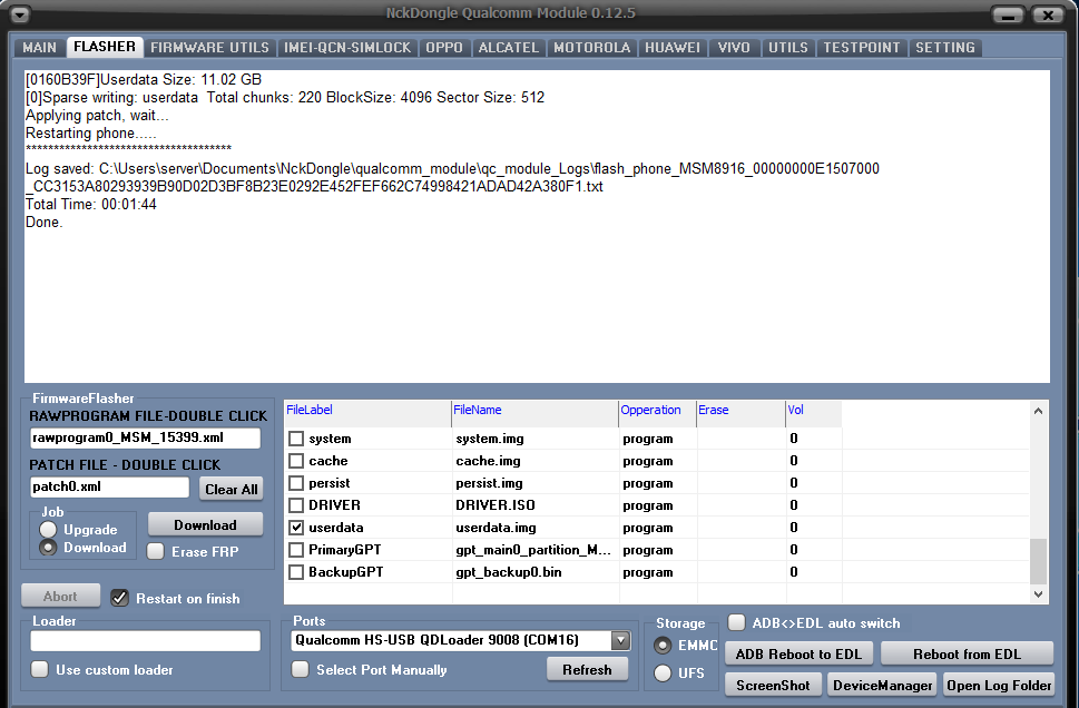

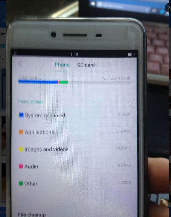

buti my nasearch ako at nagka idea
follow this
1.open nck qualcom module
2.select flasher,load raw program and patch file and tick download
3.uncheck mo lahat maliban key USERDATA
4.press volume up and down
5.lastly press download
ito po ung firmware na ginamit ko credit po sa may ari
http://http://www.mediafire.com/file/2mbkaavvi9iduur/%5Bup_vnROM.net%5D_A37fwEX_11_A.22_170522.rar?fbclid=IwAR10g_DuTCOxCYgbi6a0FpG2pmnrm9_tujtwjhD0i0fr9kEYw4Fbih9xuC8
p.s back up ka muna just in case
