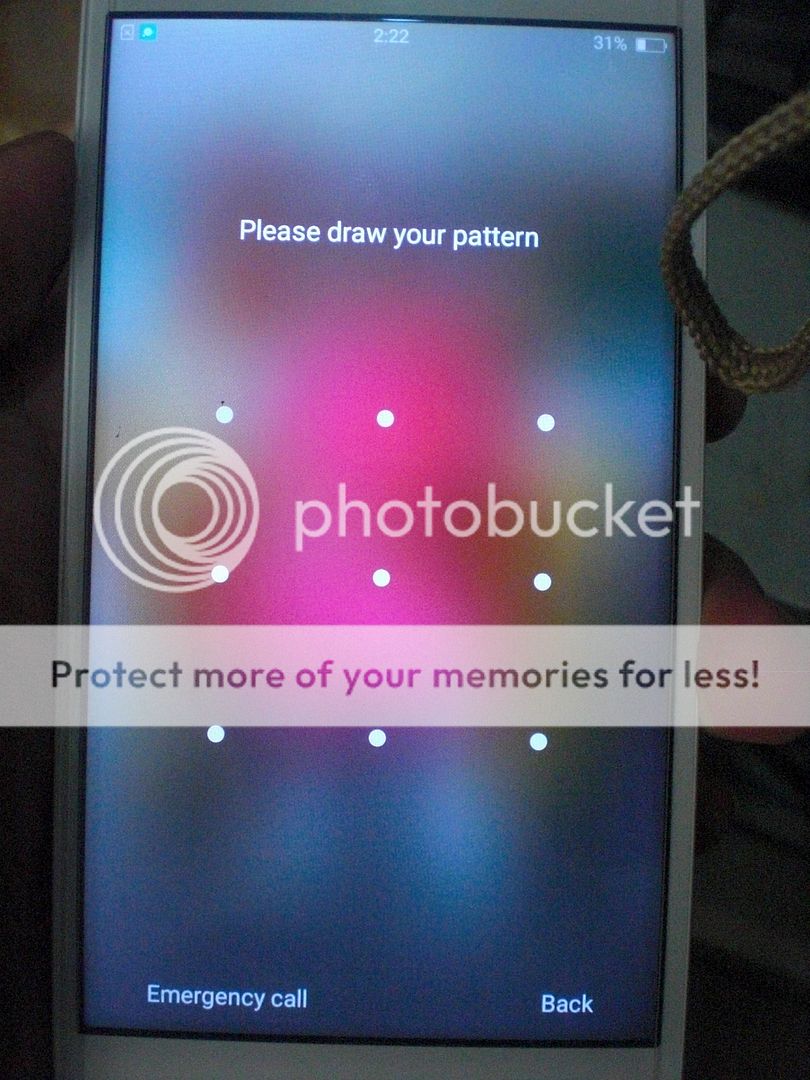

NAKALIMUTAN ni tumer ang pattern

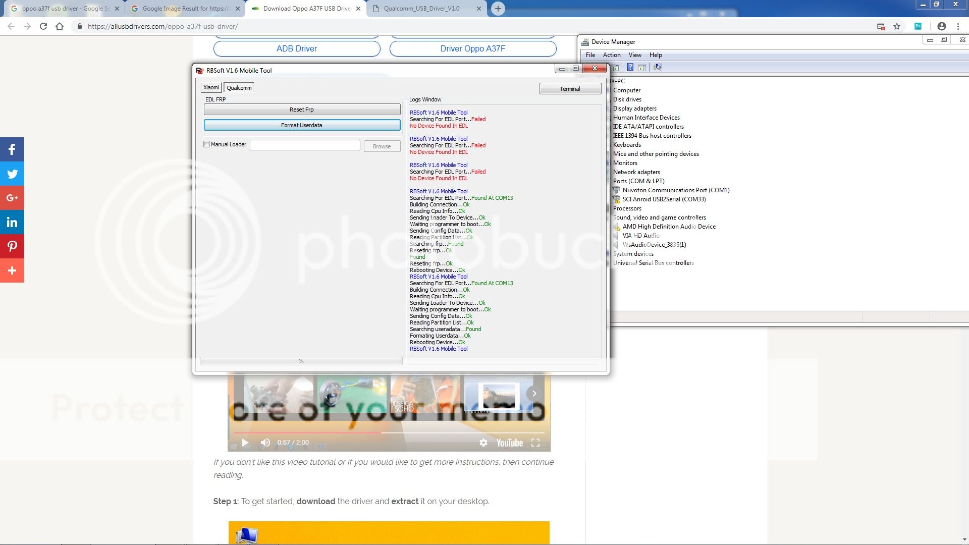

salpak kaagad kay RBsoft
1. open c RBsoft then turn off c phone
2. hold volume up& down then salpak c usb
3. kpag nadetect ni pc click reset FORMAT USER DATA
then FRP nman
same procedure 1&2
3. kpag nadetect ni pc click RESET FRP

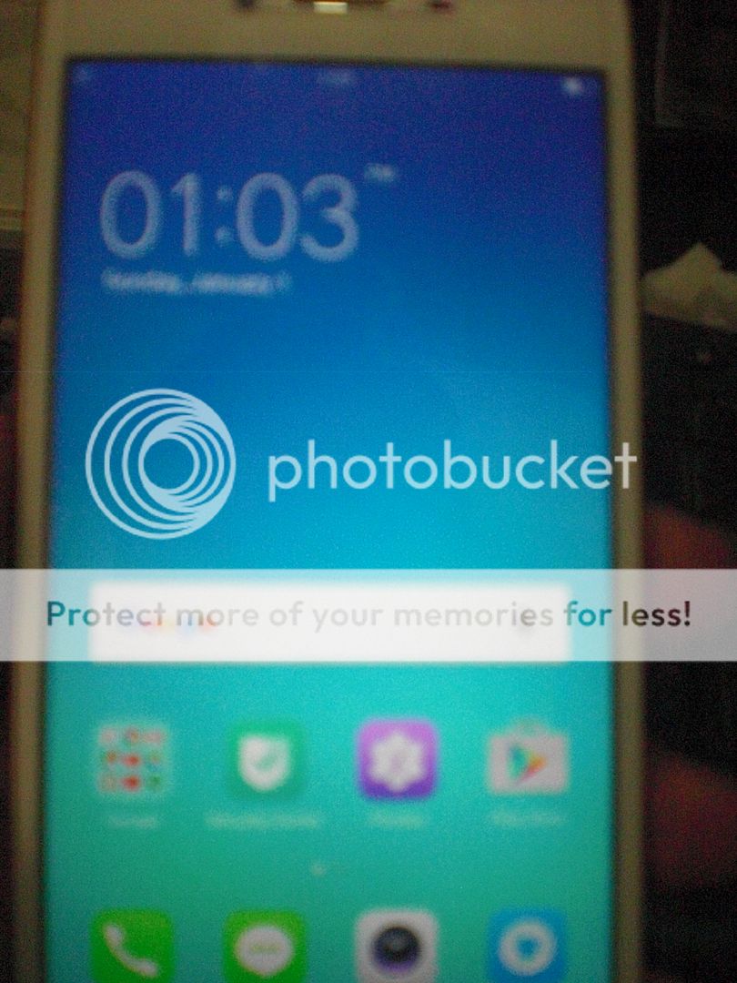

then ok n cya....
pera na....
then FRP nman
same procedure 1&2
then ok n cya....
