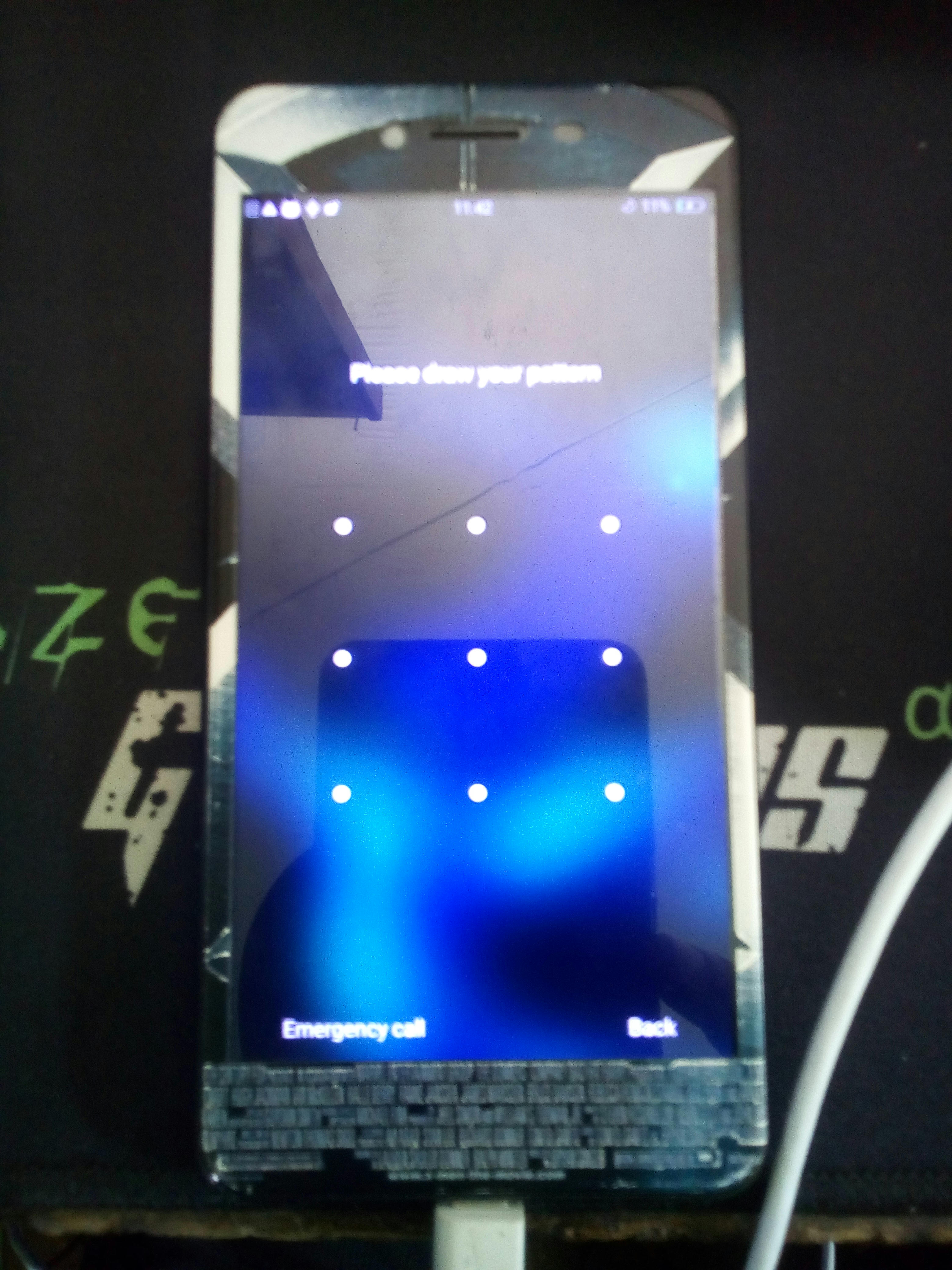

Phone History: Forgot pattern

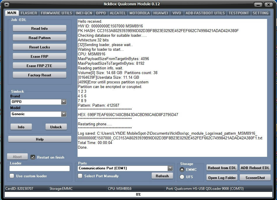

Tools: NCK Box
EDL Cable
Procedure: open nck qualcomm exe and click tab Main and go to brand and select oppo
model generic like shown below and click Pattern tab then by pressing vol+ vol- and connect edl cable to cp and wait finish reading codes...

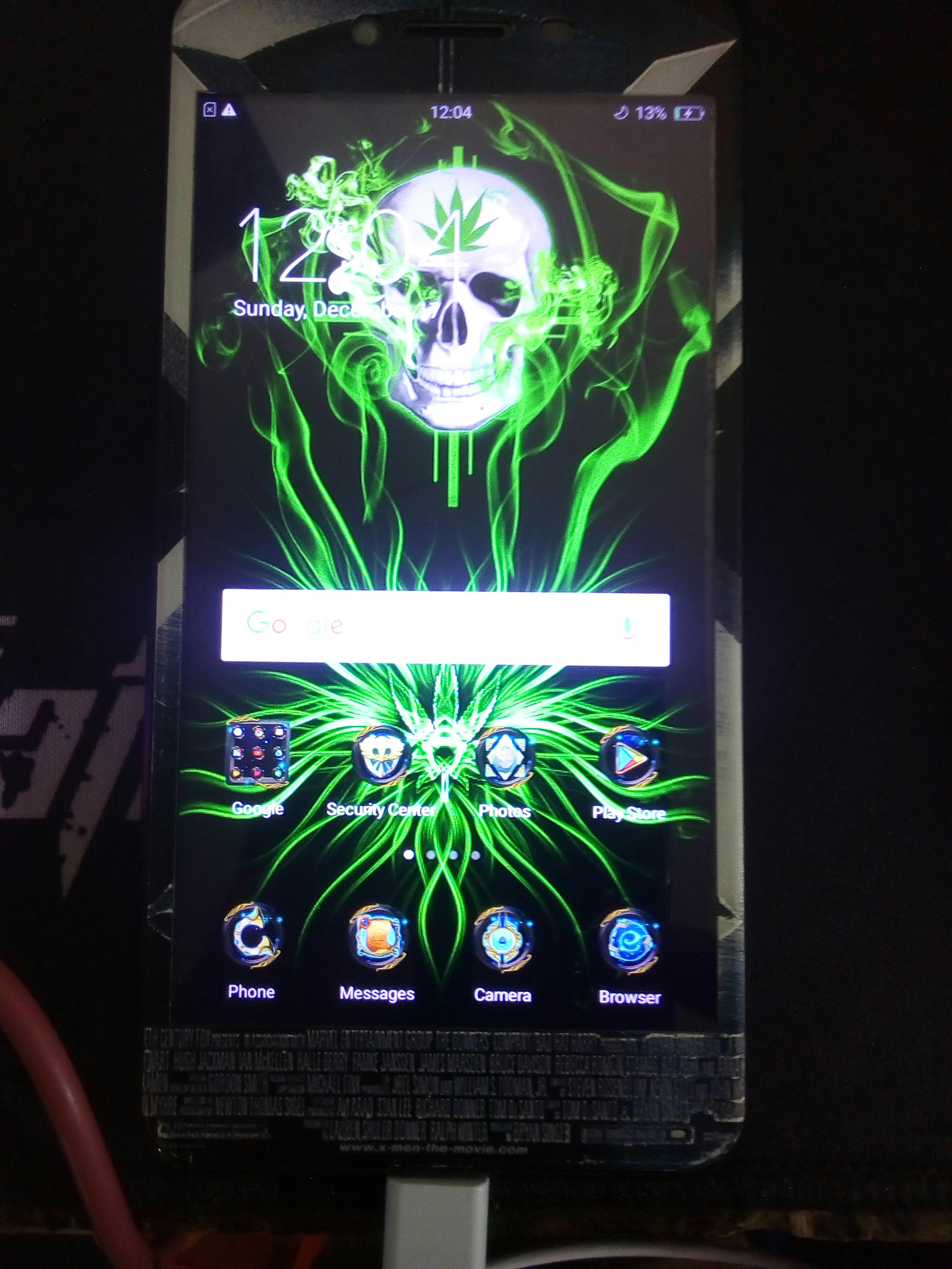

Done:)
Qualcomm Drivers: use msm9008 driver para ma detect sa nck box
