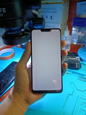

OPPO A3s CPH 1853 PAGNAIOPEN NAG WHITE SCREEN ALNG PERO MAY DISPLAY PAG BOOT AND RECOVERY MODE
SYSTEM CORRUPTED KAYA GANTO

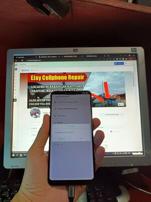

DOWNLOAD THIS FILE
https://support.oppo.com/in/software-update/software-download/?m=A3s(CPH1803)

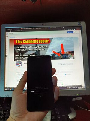

LIPAT NIYO SA SD CARD THEN RECOVERY NIYO OPPO A3S

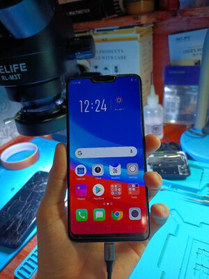

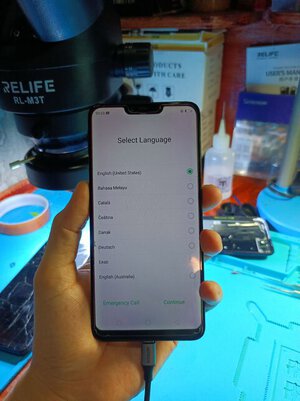

THEN INSTALL NIYO USING SD CARD WAIT UNTIL SUCCESS
SYSTEM CORRUPTED KAYA GANTODOWNLOAD THIS FILE
