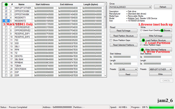

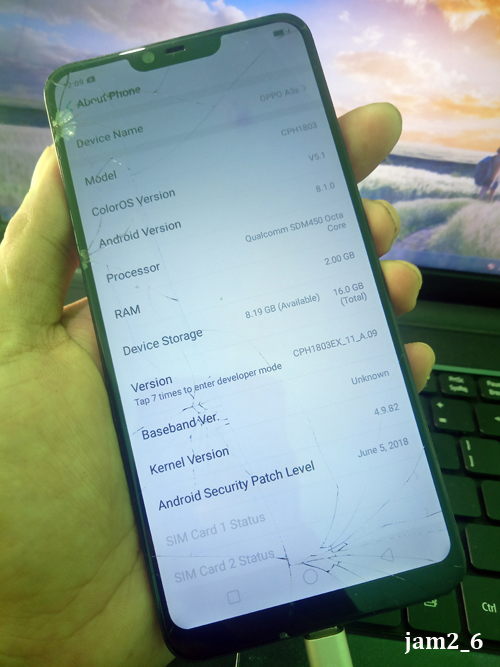

Oppo A3s CPH1803 Dead Boot Problem​
History : Passcode remove after reset via jtag DEAD :(
Sulotion :​
Full Flash Image via eFixer FREE :)

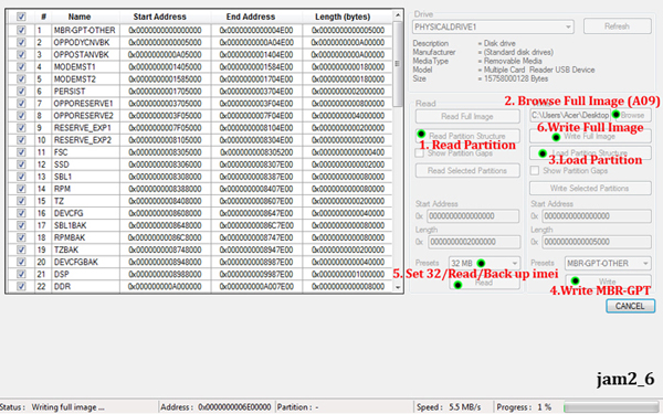

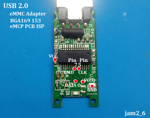

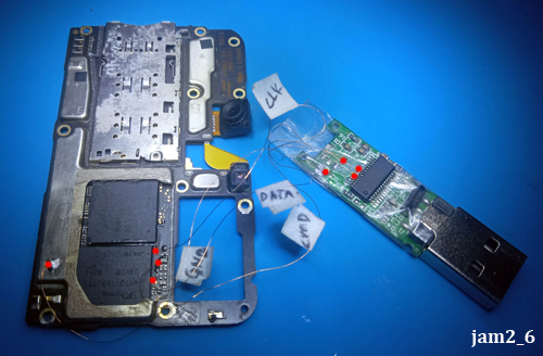

* JTAG ISP 1st make a jumper CMD CLK DATAO GND only.
* For VCC-VCCQ use USB Charger or PC.

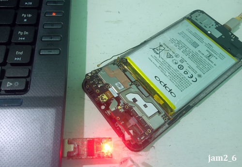

* Open eFixer insert USB jtag & Charger for VCC.
* Read partition 1st-Browse Full image FW load partition.
* Load partition-write MBR-GPT.
* Set 32mb for imei back up 1st.
* Select Write Full Image Progress 1-100% wait for 20/30mins.
* After Flash browse imei back up load partition select 12345 only & write.

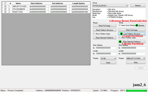

* After Write imei browse CPH1803 Reset PassCode load partition & write.

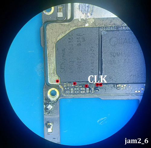

* Note make a jumper CLK after flash.
* Disasemmble the jumper jtag ISP Test Power on DONE..
eFixer Tool
Firmware : CPH1803
Click ME 15758000128​
Password : *****
Manual type jam2_6
For Flash CPH1803 Full Image (A09) 15758000128 size.
Progress.. 1% to 100% 20/30 mins.
For imei Back Up Write.
For CPH1803 Reset PassCode.
Note : After full flash make a jumper CLK.

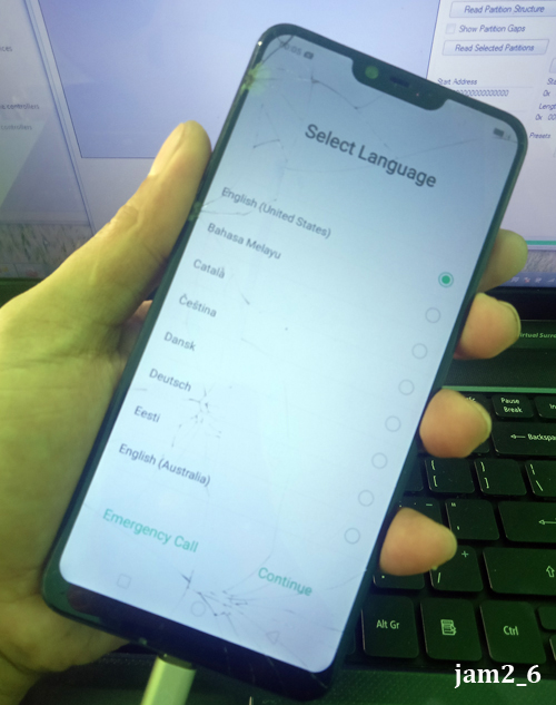

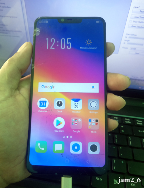

DONE.. Tnx for view sana makatulong sa inyo idea.. mga sir.. ;) :p

Sulotion :​
