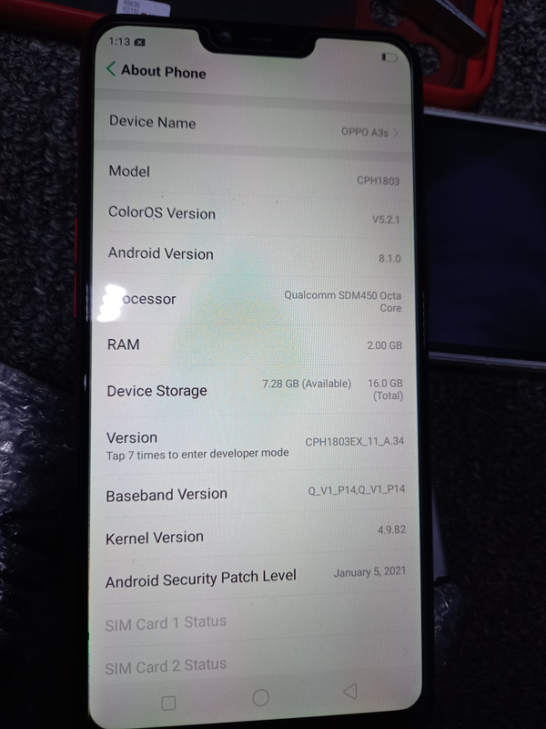

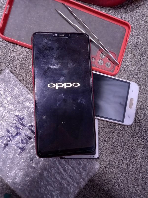

Good day po mga boss.. may tanggap po ako Oppo A3s/cph1803 .. nka hung lng po sa logo.,,,

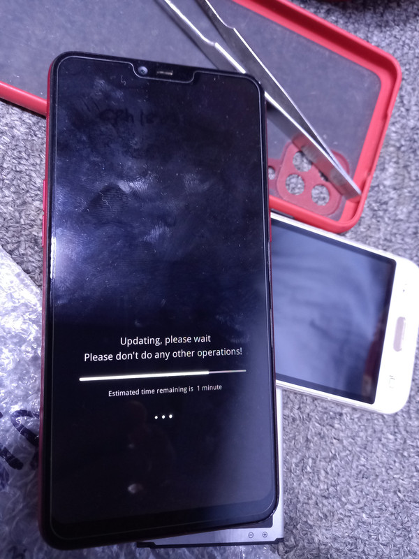

kaya 1st step na ginawa q.. hard reset q muna at ok nman nkakapasok sa recovery mode pero after q format ganun padin., kaya dowmload muna updated na firmwr ni a3s cph1803,after download lipat q sa sd card at tnry q update via sd
- long press vol - and power on ,, bitaw power on kpag lumabas na c oppo logo
-click enlglish

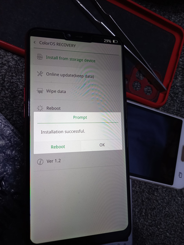

-install from storage device
-select from sd card
-and click nyo lng po ung fw na dnowdload nyo sa sd card..

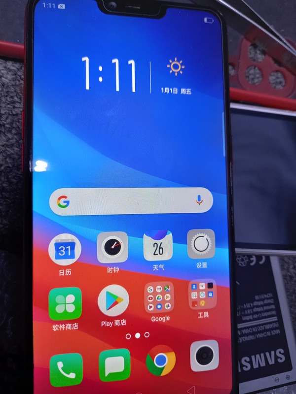

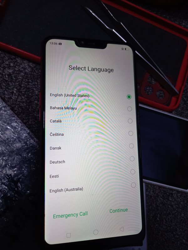

at wait nyo lng matapos at after po ng install click nyo lng p reboot...
REMINDER, hndi po lahat ng hung on logo ay nadadala via update ung iba po need po tlaga ng flash via jtag.. sana
sana po makatulong..
