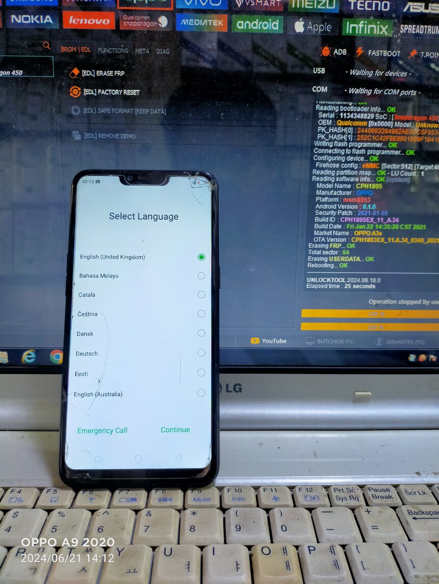

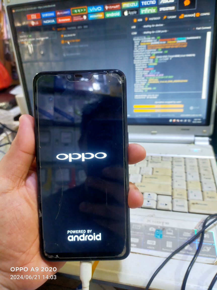

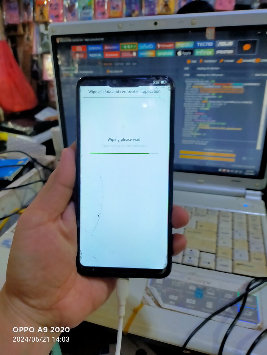

Step 1 : open unlocktool
Step 2: click oppo tab
Step 3: dial *#899# check exact model
Step 4: click oppo a3s and exact model
Step 5: go to recovery mode press volume down at power button
Select ver tab
Connect cable then press ok kapag na detect na
Step 6: click factory reset
Wait mo lang at success na
Pasensya na at kulang Yung picture nagmamadali kc client IMG20240621140333.jpgIMG20240621140342.jpgIMG20240621141201.jpg

ayus boss ah ma try din nga pag pumasok ganitong unit

maraming salamat sir! tested po
