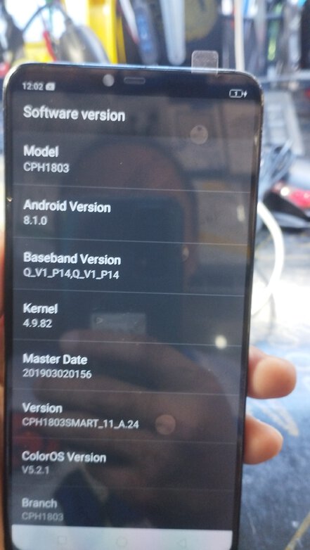

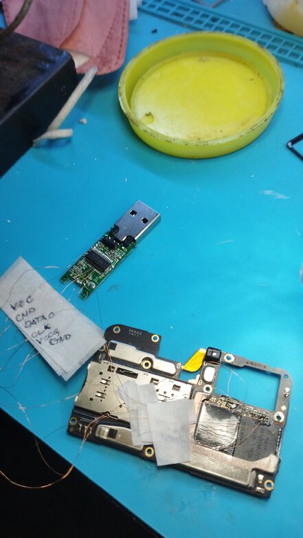

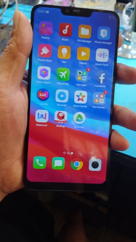

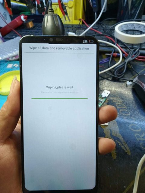

share ko lang manga boos
baka makatulong oppo a3s password
done sa efixer tool reset passcode
ito po patunay na leget po
IMG_20220421_135815.jpgIMG_20220421_143823.jpgreceived_2787719354871185.jpegreceived_309139008031767.jpegreceived_2881637178802797.jpegreceived_1171655386946119.jpegIMG_20220421_162920.jpg
eto po link paki sundan lang po
Click me!!

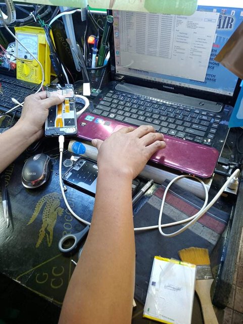

bago simulan ilanang muna isp pin out ng maganda para mabilis mag connect search na lang google sa isp kung ano hawak natin

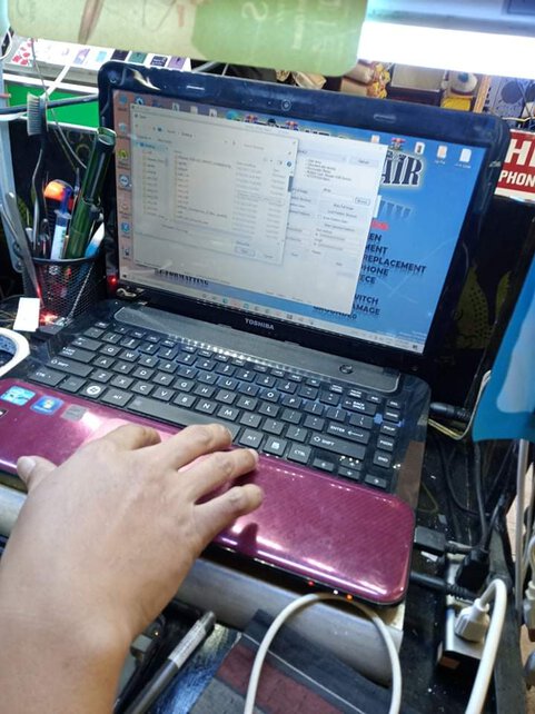

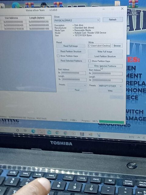

1-run/open eFixer Tool
2-Refresh Driver pag nag detect na
3-Read Partition Structure pag na read na nya
4-Browse Reset File
5-Click Load Partition Structure Tatlo lang lalabas pag ka load
6-Write Selected Partition

ayos yan bossi paste ko lng sa 1st thread...keep sharing
tested po firstime ko mag try salamat po sa guide

Tanung kulang po,kailngan pba box dito or sa app lang tlga using efixer?
