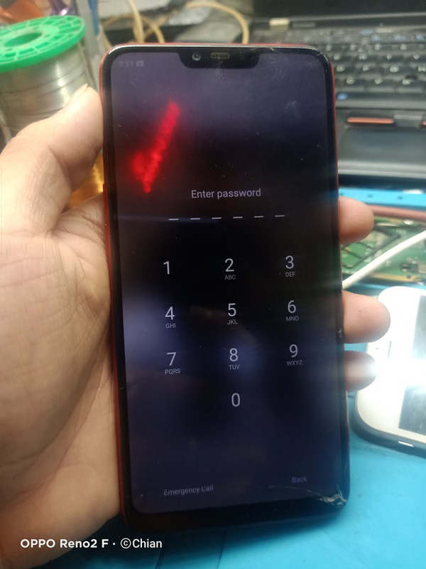

good day po sa lahat. today may tanggap po akong a3s nakalimutan daw password

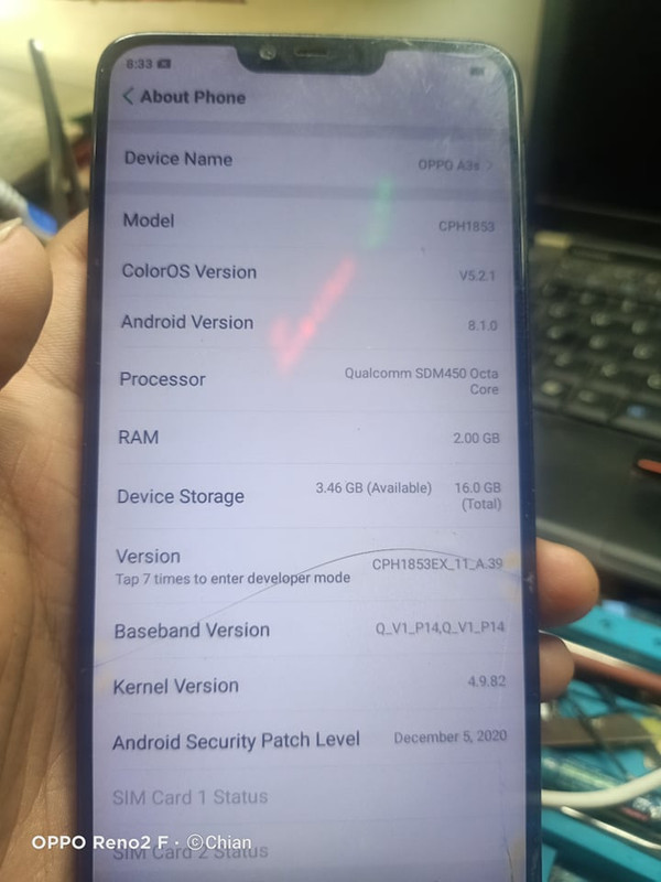

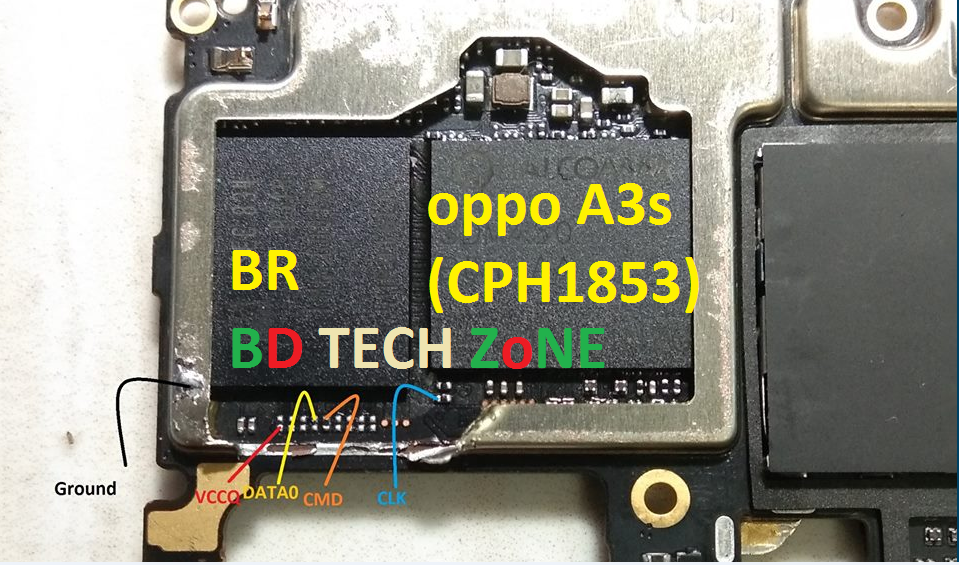

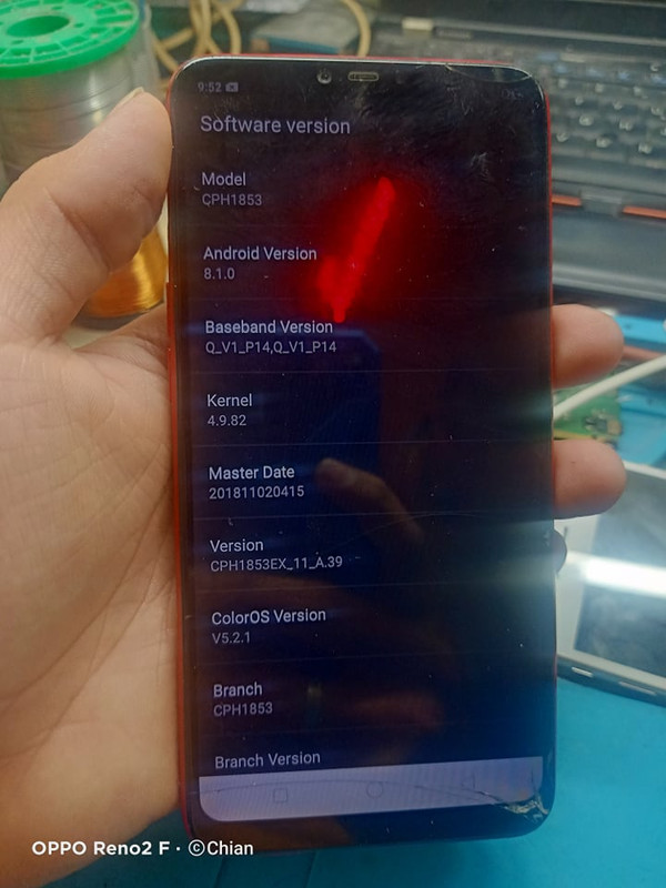

para ma identify kung anong model siya dial *#899# then click software version

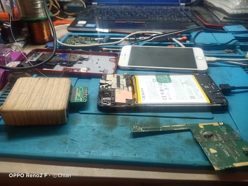

now baklasin ang unit at iconnect ang pin out

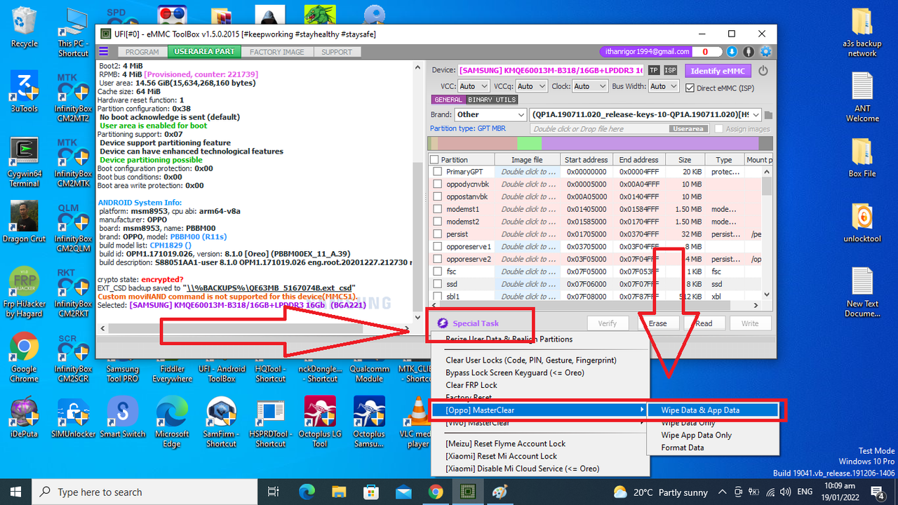

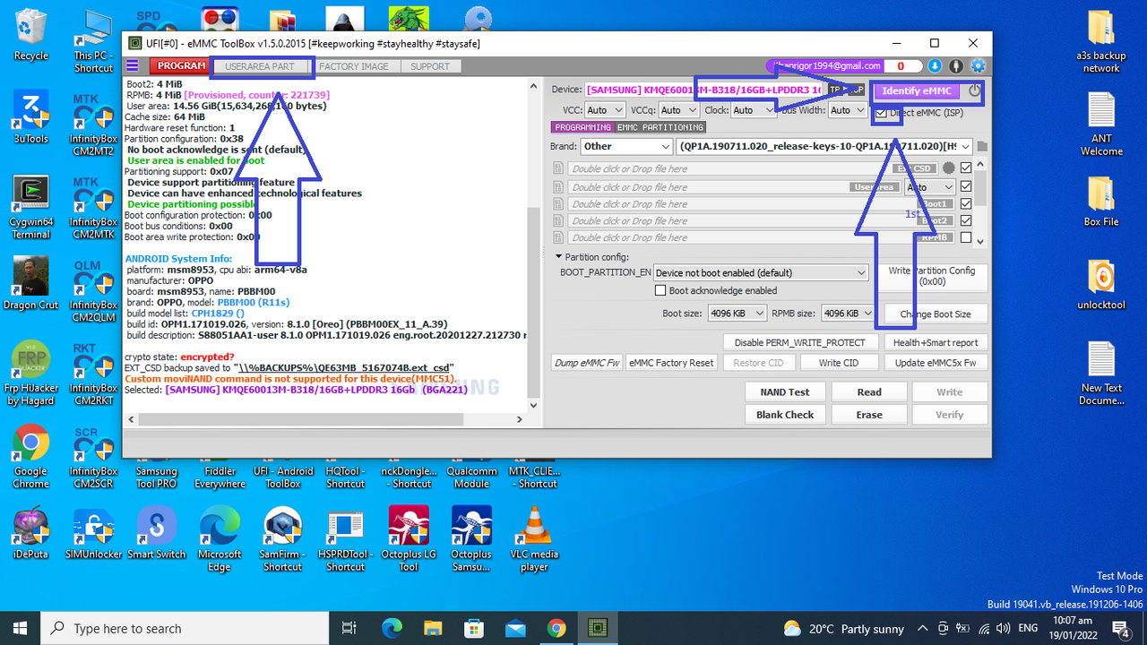

now open ufi emmc toolbox
check the small box 'Direct eMMC (ISP) then click 'Identify eMMC' after ma identify click 'USERAREA PART'
pag nasa userarea part kana click 'Special Task' then click '[OPPO] Master Clear' then click 'Wipe Data & App Data'

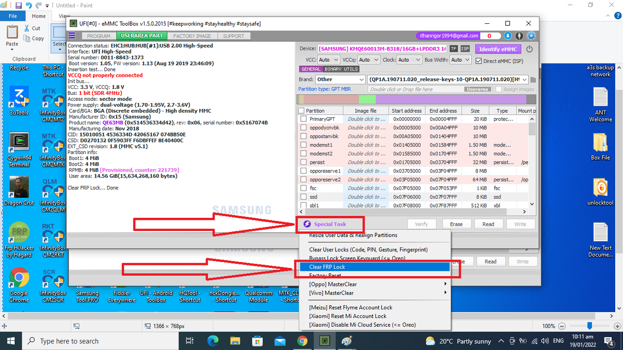

para sa frp naman click 'Special Task' and click 'Clear FRP Lock'

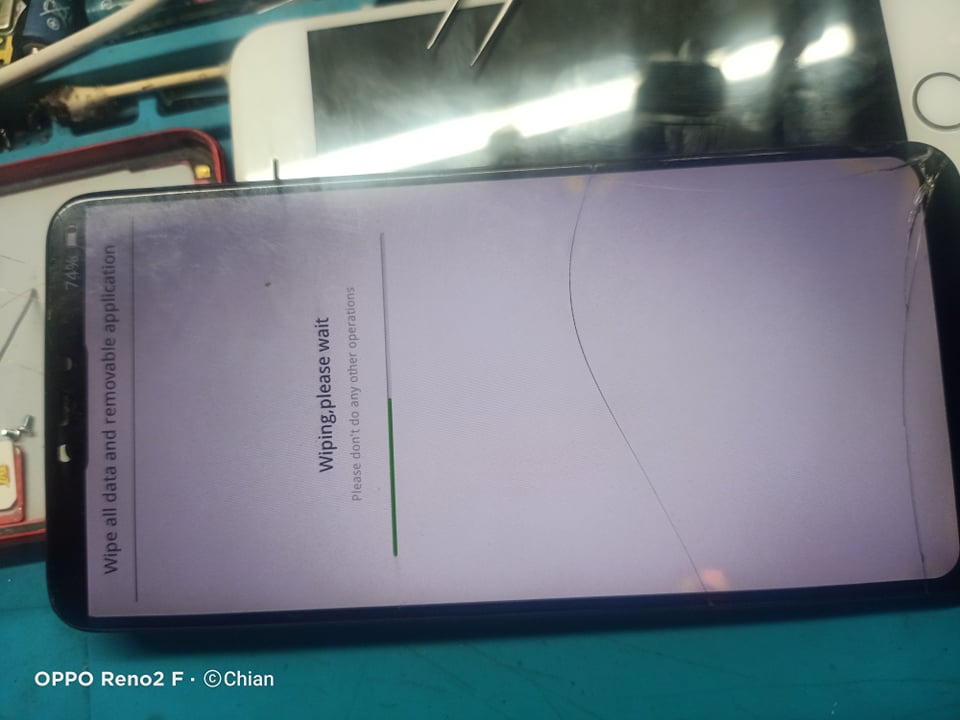

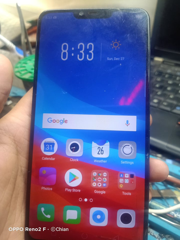

heto naman po ang proof ko
